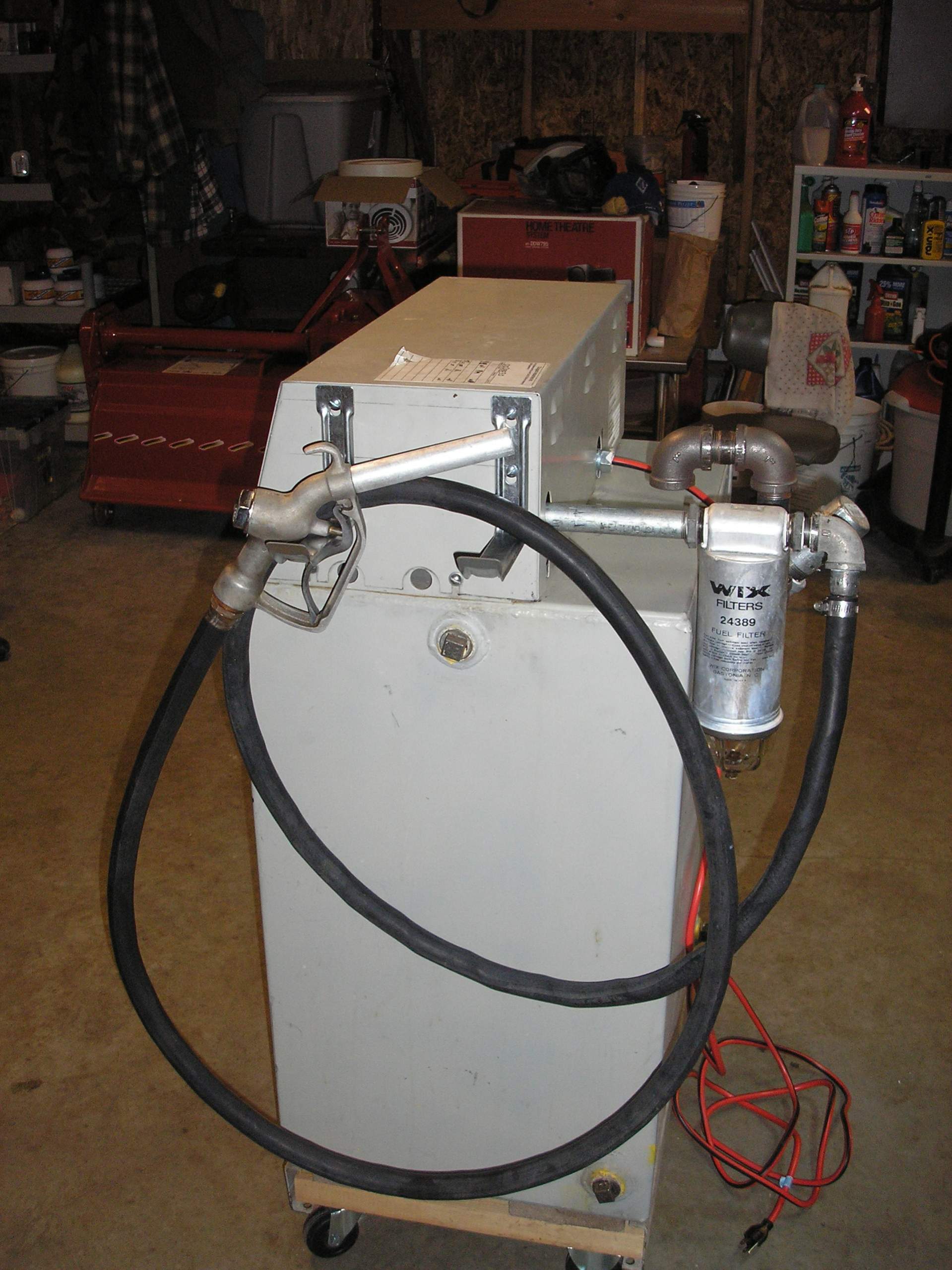

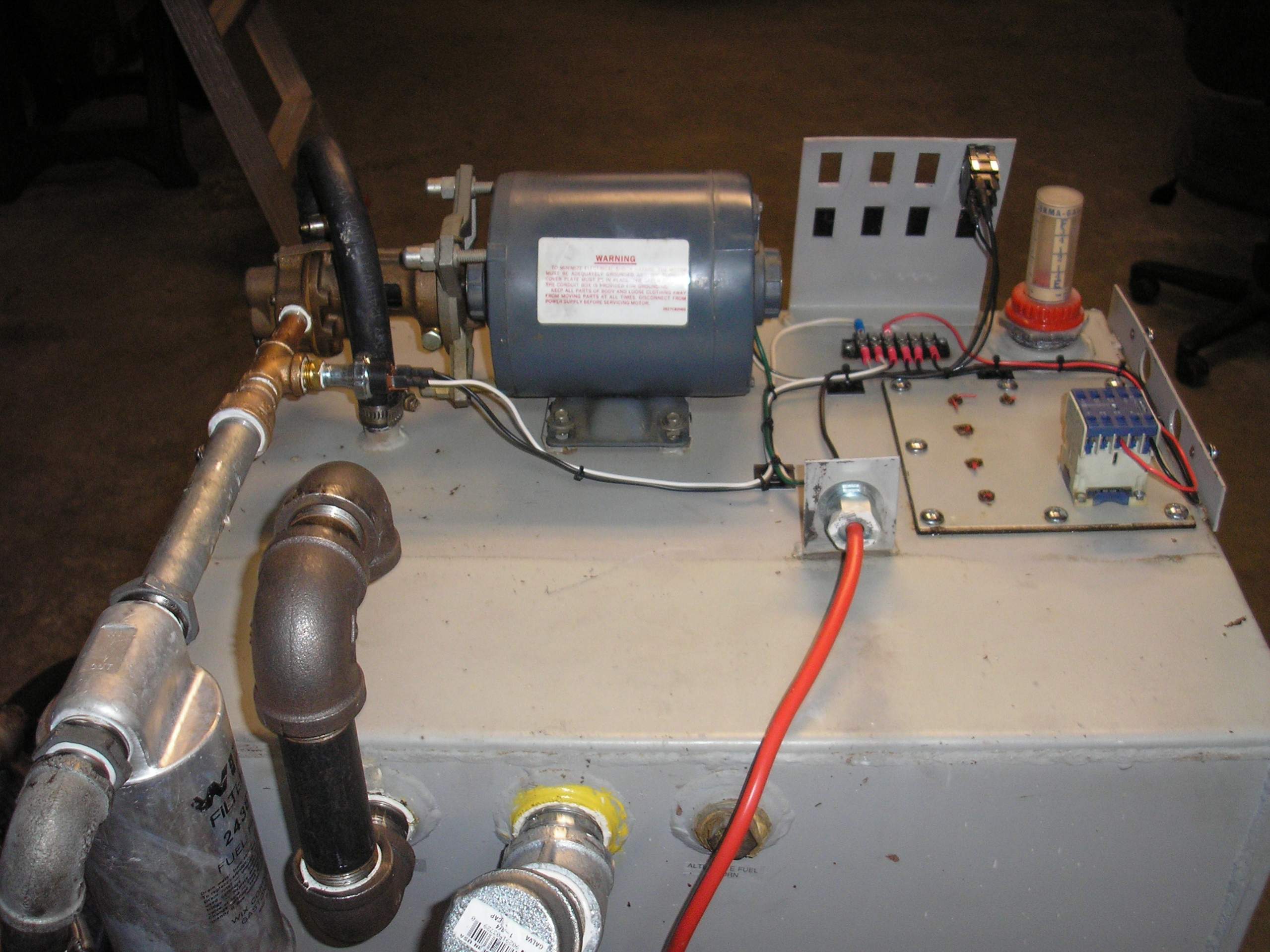

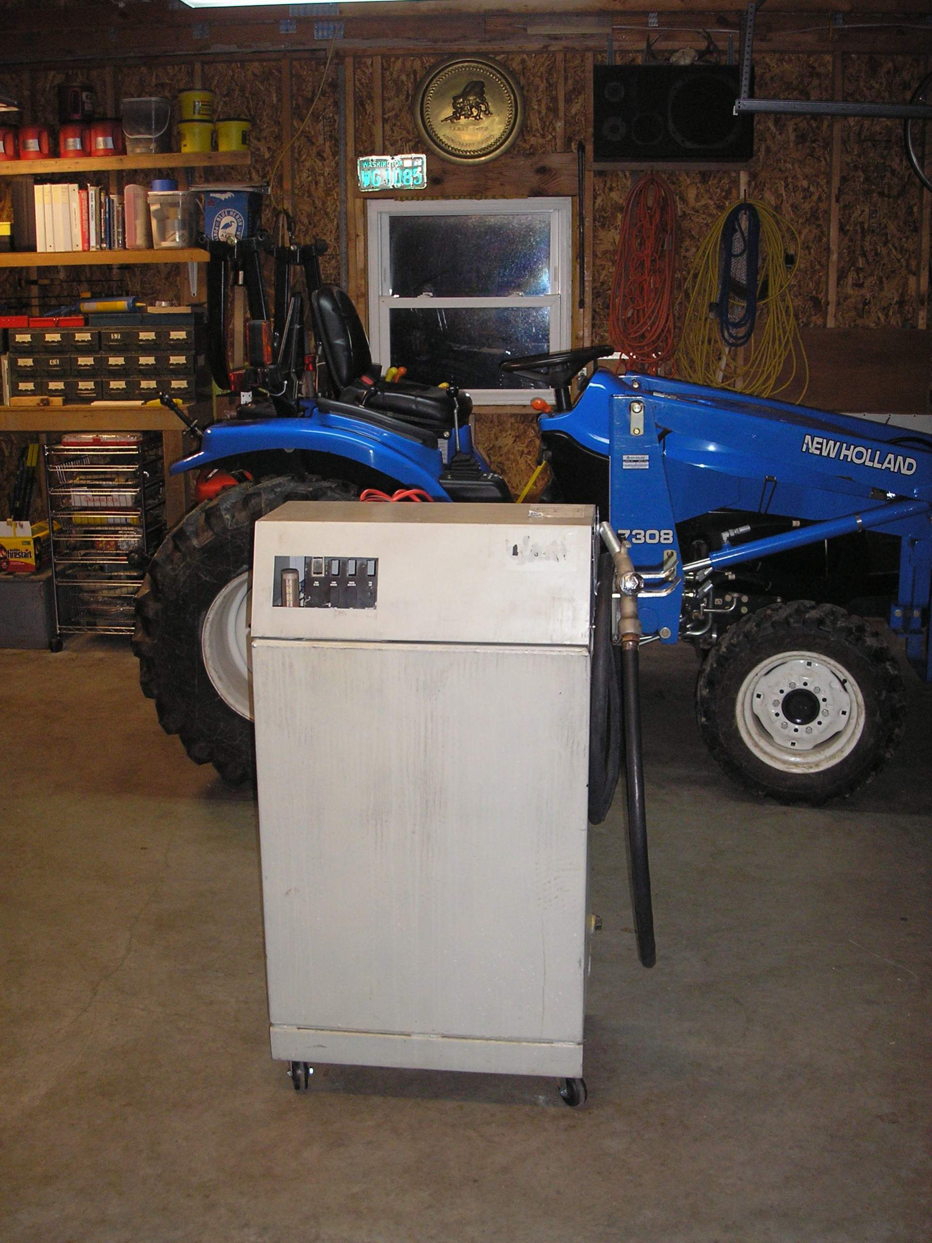

Well, I got everything wired and ran a quick test using air to activate the relay. All worked as planned. I filled the tank (ok, emptied about 17gl) and fired it up. The pump ran long enough to fill the filter and hose then shut off as designed.
I had a little delay this past weekend when the pressure switch I purchased closed at around 20psi instead of opening. I was so focused on having the switch activate the relay to turn the pump on that I just knew I needed a different switch. I went to a couple different auto parts stores but all the oil pressure switches close at their rated pressures. I kept thinking I wanted the active relay to engage the pump. Then, after I went to bed Sunday night, it dawned on me that it really doesn't matter what the switch does, I've got a relay that has 2 N.O. and 2 N.C. contacts. DUH, just use one of the normally closed contacts. Almost made me want to get up and go test the setup but as I said earlier, I've got another fuel project that pays the bills.
It did cycle every few seconds as the pressure would bleed off but when I actually filled the tank there wasn't enough time between stopping the fill nozzle and turning around to secure the pump.
Anybody need a couple of yellow diesel containers?

Great job Larry. How do you plan on refilling? Do you load it up in your truck and take it to the station to fill or will you have fuel delivered?
   / Building a fill station
#24
At this point I plan on loading it in the truck and filling at the station myself.
I might see what the local co-op charges for delivery but I'm sure it will be better to fill myself.
