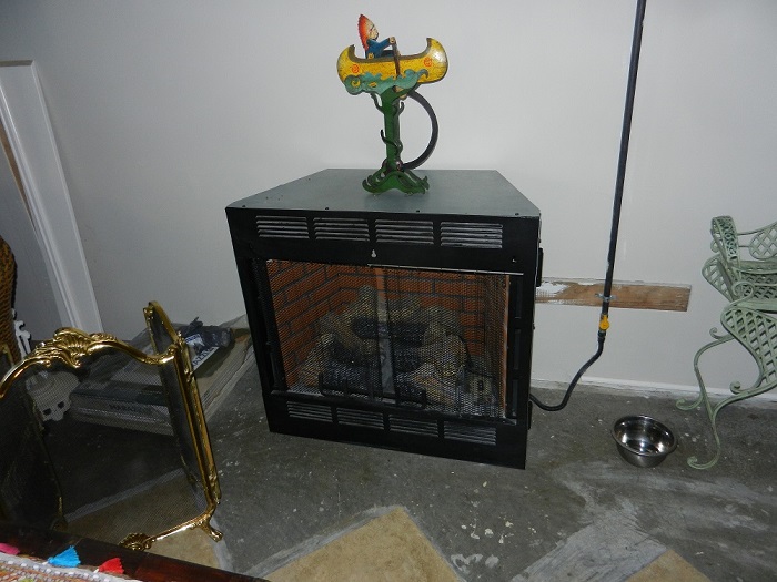

Here's a picture of it. Essentially, it would be the following: (tried to upload picture and it didn't work, will try later)
1. Remove the propane burner from the inside of this fire box (that has no vent)
2. Build a stone , brick, whatever the material might be... "fireplace" in this location (that has no vent)
3. Insert the propane burner into the new enclosure (that has no vent)
The building of the "fireplace" would be done by someone who builds fireplaces (not me)
The installing of the propane "logs" into the new fireplace would be done by someone who plays with gas (not me)
My logic is, it's the propane burner that makes this "ventless" and not the "box". So I THINK I should be able to replace the "box" (build a "fireplace") and move it over.
This metal box is in my view, pretty cheesy feeling.
(it would be so much easier if the wife simply allowed a traditional wood burning (with chimney) fireplace but, I digress)
   / Building a fireplace (ventless) question...
Seems I got it to work this time. Here is the "fireplace" of mention. The goal is to take the outer metal "shell" and replace it with stone or whatever a REAL fireplace is made from... and keep it ventless.
We'll then add the cabinets to the sides that she's got on her build list.

Richard, all I am saying is that there is much concern over unmodified, properly-installed ventless fireplace units. What you are proposing is modifying ventless equipment for a use not intended by the manufacturer.
I cannot think of something I would less-likely do than what you are proposing. Just stating my mind here.
If something were to go wrong, who takes responsibility?
The manufacturer? Nope
The installer? Nope, he'll fold his LLC and have wording on the contract to protect himself.
Insurance company? Probably not.
Is the local jurisdiction inspectors going to sign off on this work?
Don't let you wife decide something this important. This isn't like selecting the color of floor tile or where to hang a picture.

Check the specs and see what the minimum clearance to combustible materials is...
To change the looks to your liking some framing may be required...
I've seen fire rated cement board screwed to all the sheet metal facets and then covered with stone,tile,brick etc...
