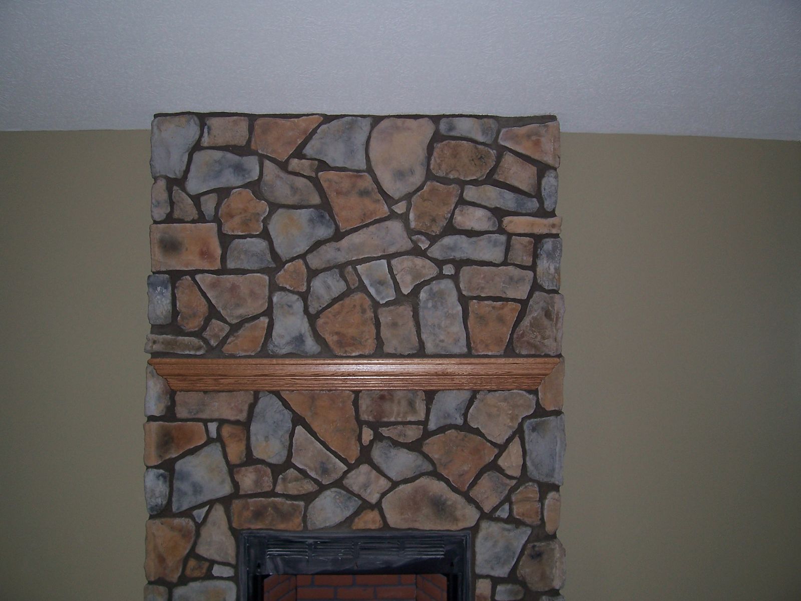

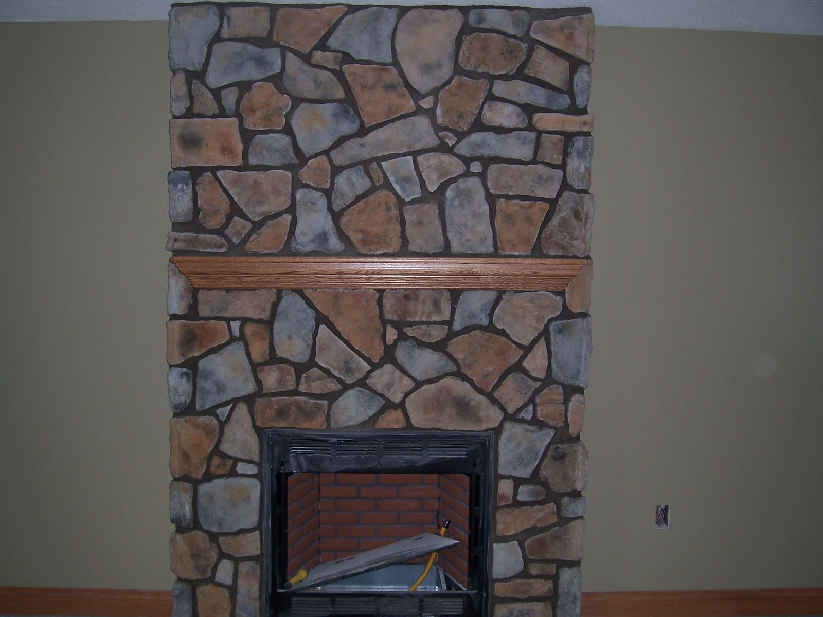

Here are a couple of pictures from when we built the house. This is our vent free propane "fireplace." We then installed the stand and logs into the box. This was built from the get go as vent less. It sticks out into the garage a bit so it doesn't come out into the room. Our house is about 3100 sq ft. and laid out kinda strange, but when we lost power during an ice storm a few years back, this fire place kept our upstairs hot (it is in our living room on the first floor that is off the foyer with a 4' door but the foyer is open to the second floor) and most of the first floor warm enough that you were cool, but not freezing. Now the living room, that was another story, it was so warm in there you didn't stay in there for more than a few minutes.
