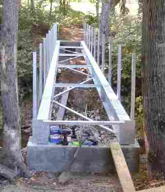

Yes, maintaining adequate freeboard is critical, as fast-moving debris can do major damage. We were fortunate that this project site has a big flat basin, so the water level fluctuates very little. Another bridge we did is a backwater area for a significant river, so although the water can come right over the bridge it doesn't move at all.
Here's a pic of that one (50' span) before the wood was put down:

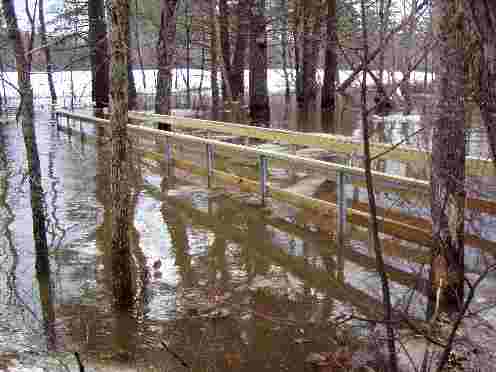

And a photo of the same under flood waters:

   / Building a footbridge #38
This bridge is very similar to what i will be building. My creek is so pwerfull, that it has washed out the county bridge. I kicked around a suspension, but that gets really involved....looks cool though! Thanks for the pic's! BTW, is there an easy formula for weight-span for using I-beams? Such as a 40' x 6'(finished width)that needs to carry a ton to a ton & a half ? I am curious as to the minimum size of the I-beams.
I have access to a couple of old county bridge beams, but the darn things are 45' and about 3' tall. I even went and looked at them, but geeze, moving them would involve alot of resorces. My neighbor wanted to winch them up ontop of his wrecker a frame and try and "drive them", but i think it would crush his wrecker like a Tonka toy. I guess it could be done with an set of axles and make a long trailer out of each one, but then swinging them into place is a 'nuther can of worms. /forums/images/graemlins/crazy.gif
Anyway, i think i would rather go your route, and be able to manage the smaller beams with a minimum of equipment, as i know that i will end up doing 90% of the work myself!
RD
