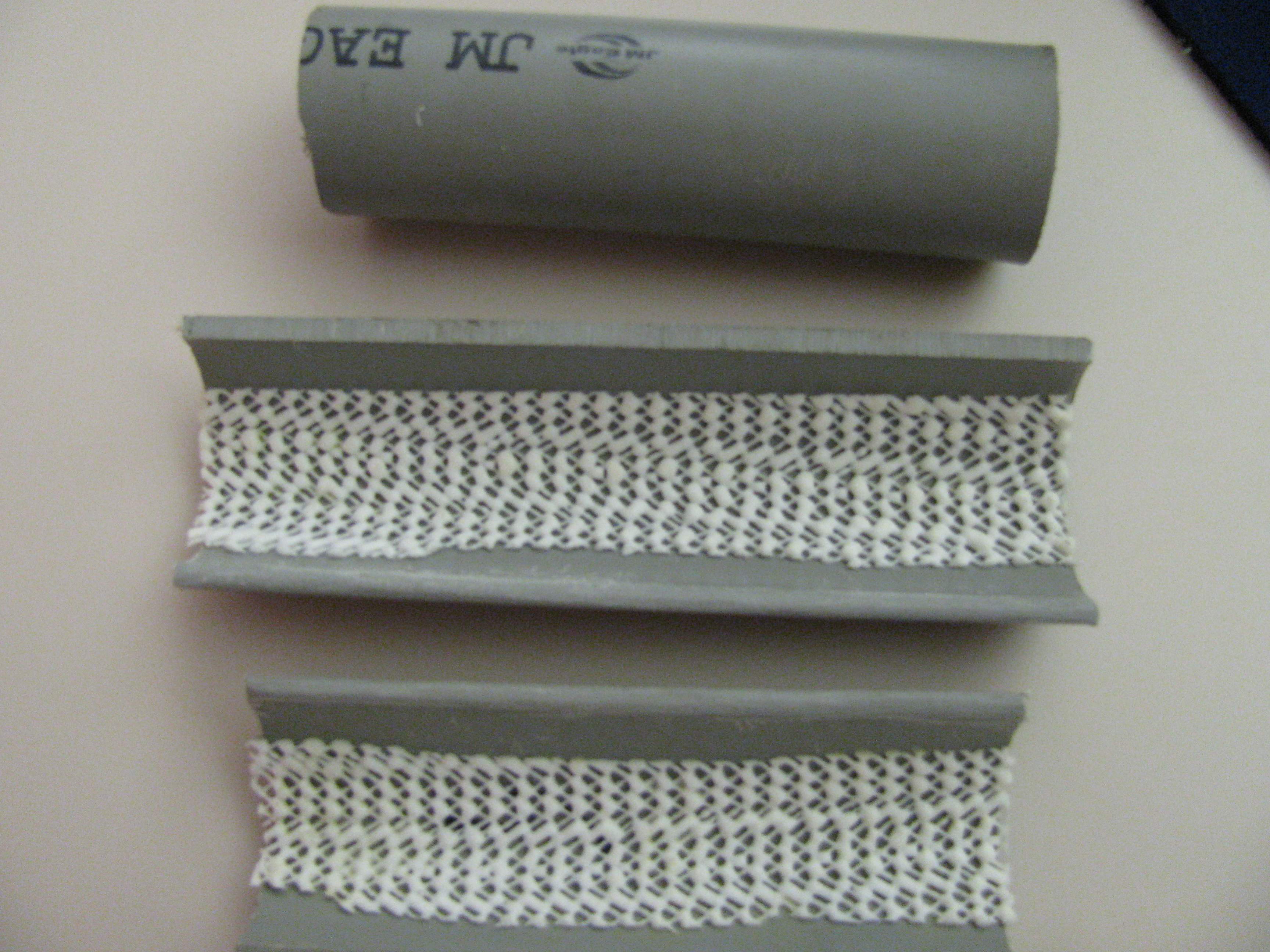

   / Building a Greenhouse
#32
Poor mans film clamps. I used gray 1 シ inch PVC pipe and cut length wise being careful to keep it straight. Then glued rubber non skid shelf liner inside each half. One half is then secured using screws to the top of the greenhouse on both ends. This follows the contour of the greenhouse to about 3 feet from the ground on both sides.
I did have to build, in a few places, additional frame material on the ends of the greenhouse for securing the channel.
PJ

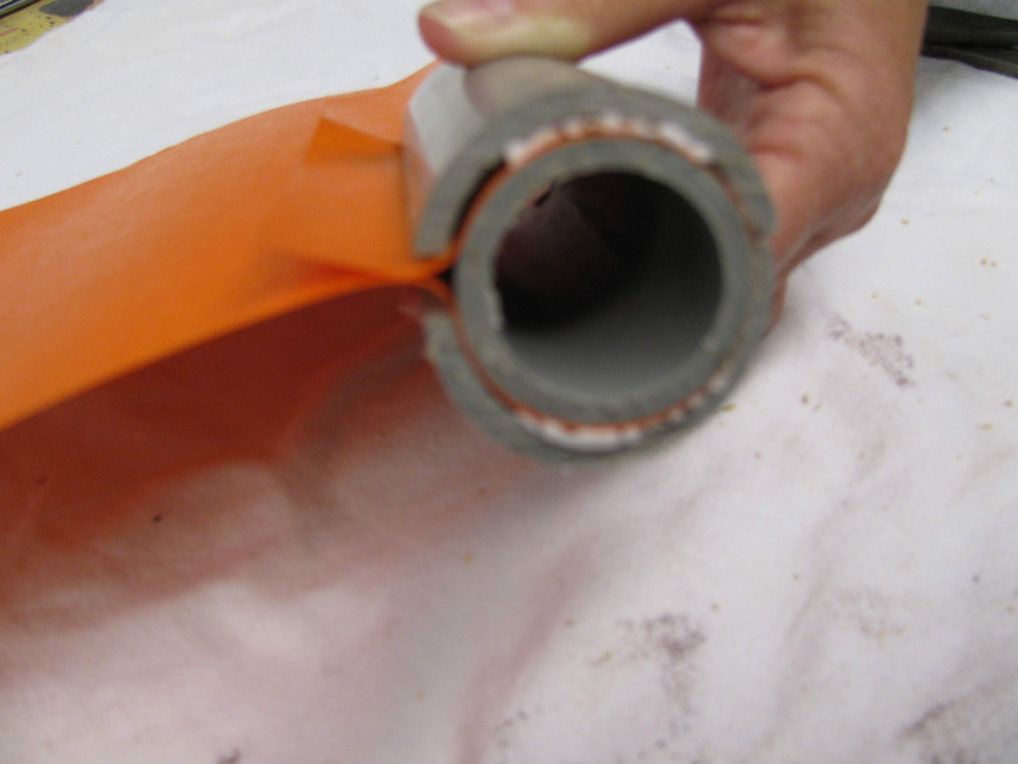

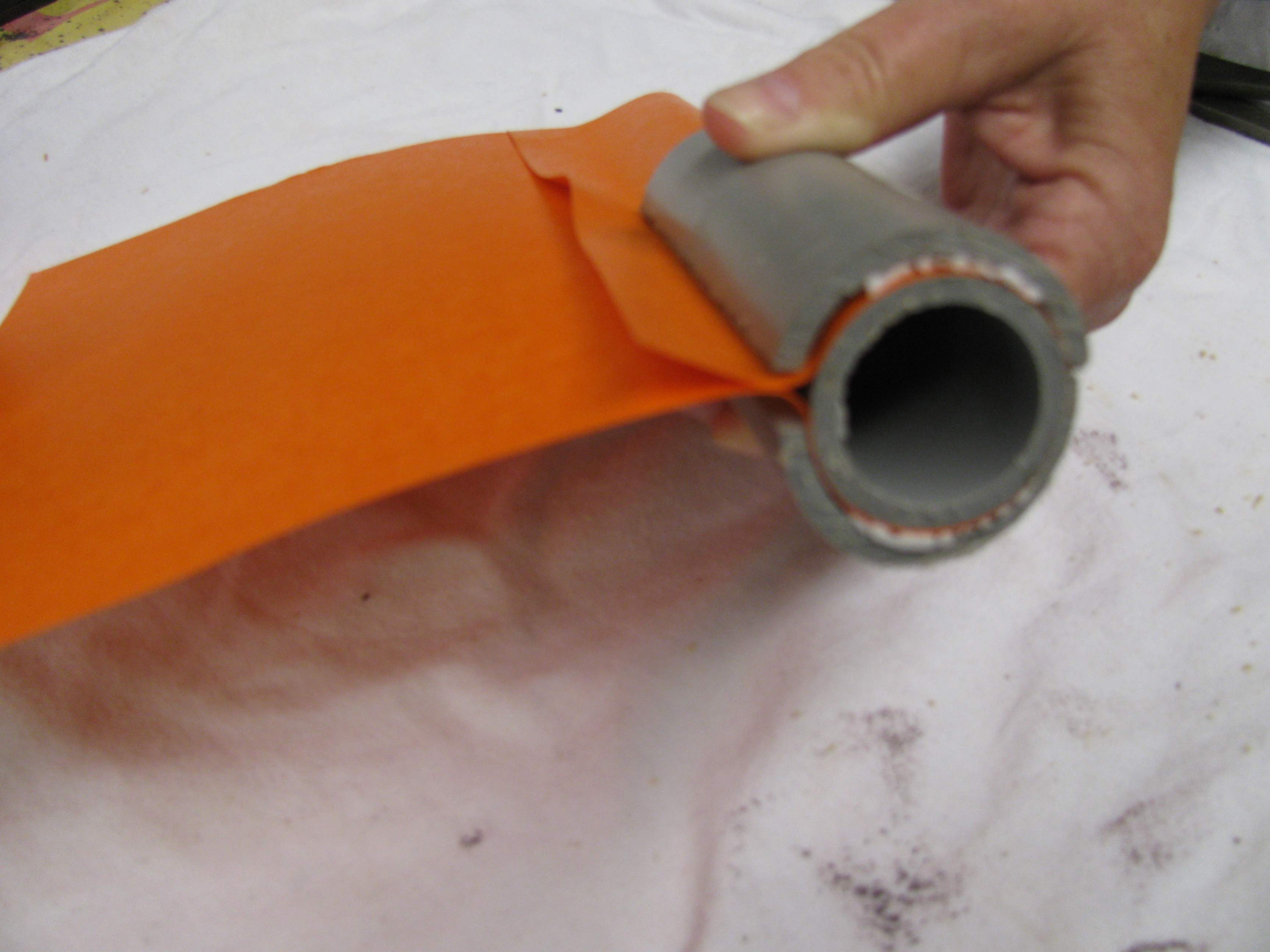

#33
What it looks like put together. Used orange paper to show how it looks put together.
PJ
#34
Lay film inside channel that is secured to greenhouse. Place 1 inch pipe inside channel and roll the film back over the top of the 1 inch pipe and install the other half of cut channel to the top of the 1 inch pipe. I pre drilled holes on the top channel and now screwed through all pieces into the wood. My total cost for securing the film on each end was around $50.
PJ

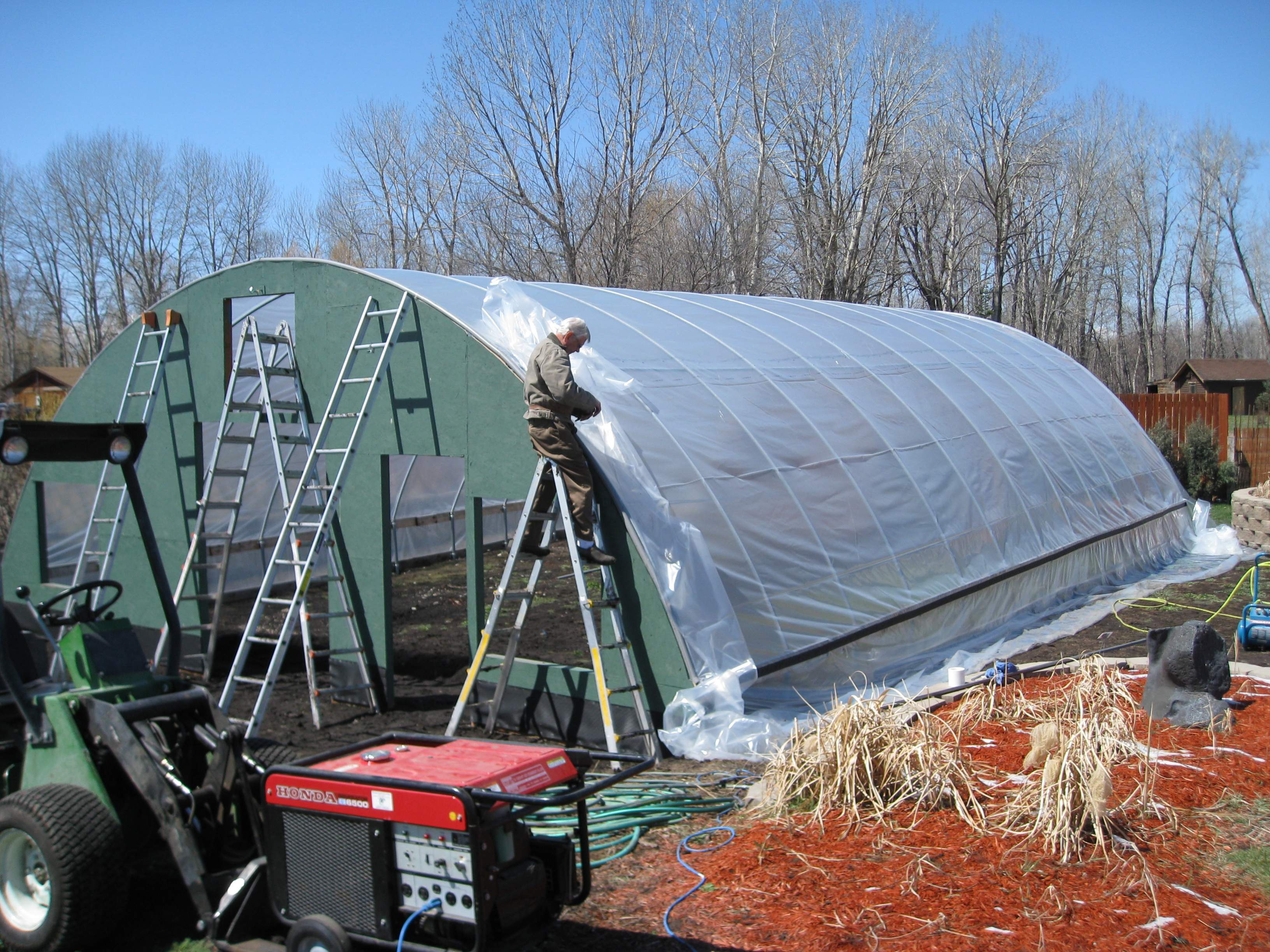

#35
Trimming excess film.
PJ

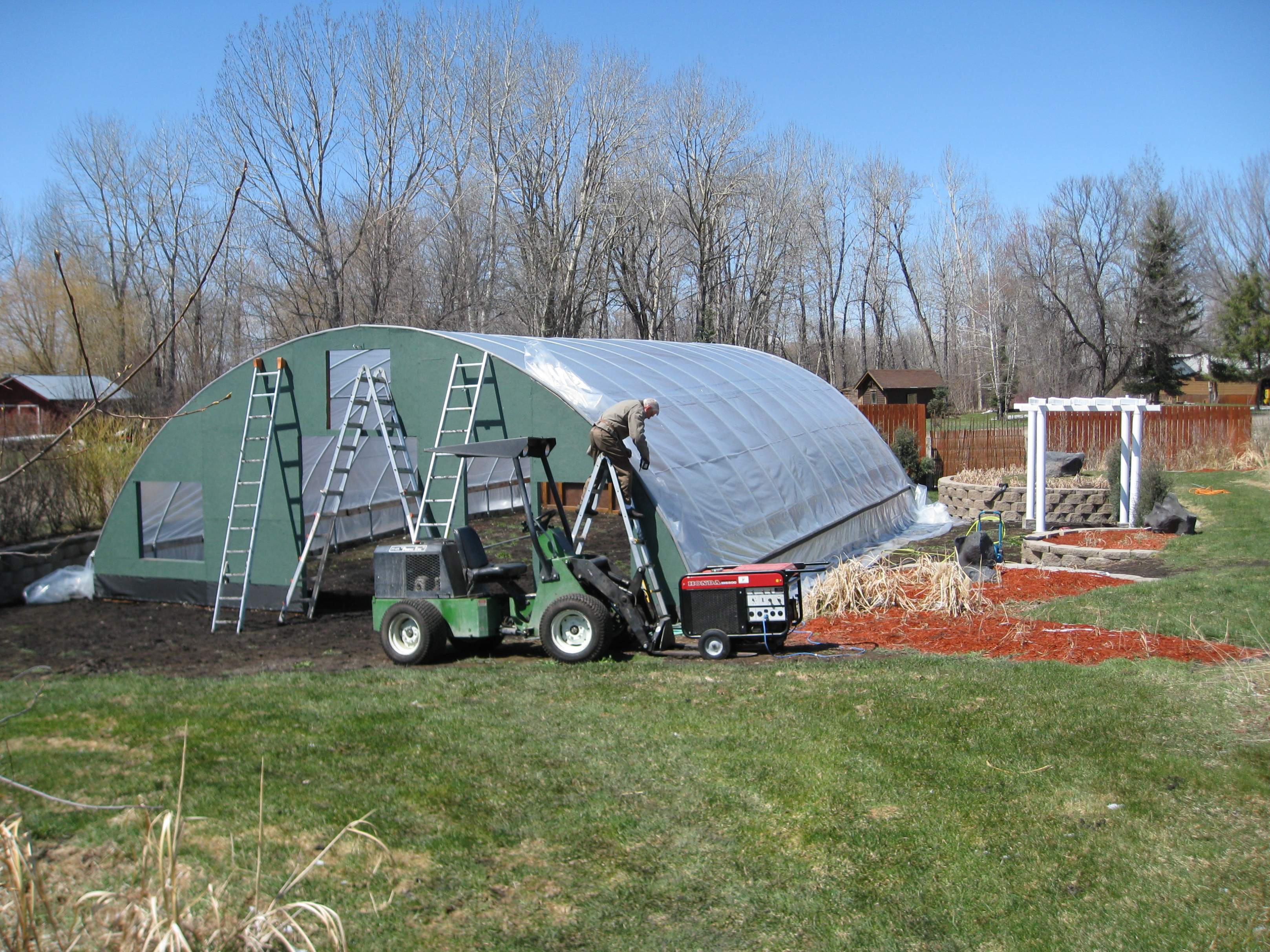

#36
Black strip on side rail is fabric type material nailed to the redwood for securing the film along the sides.
PJ
