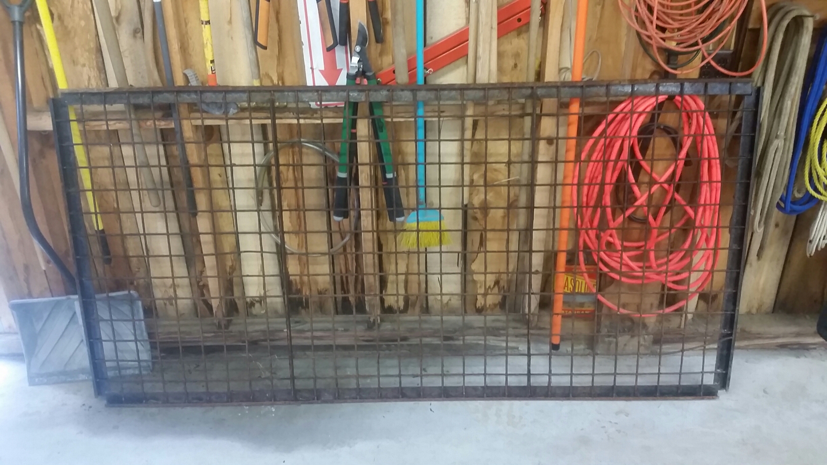

This is the best part:
This is the screen from a sander. It is 2.75" squares and 4' x 8'. It changes my plans a little, my overlay is now going to be a slightly larger opening and I will have to figure out how to extend the screen another 2' to match my frame. But the price was right, free!

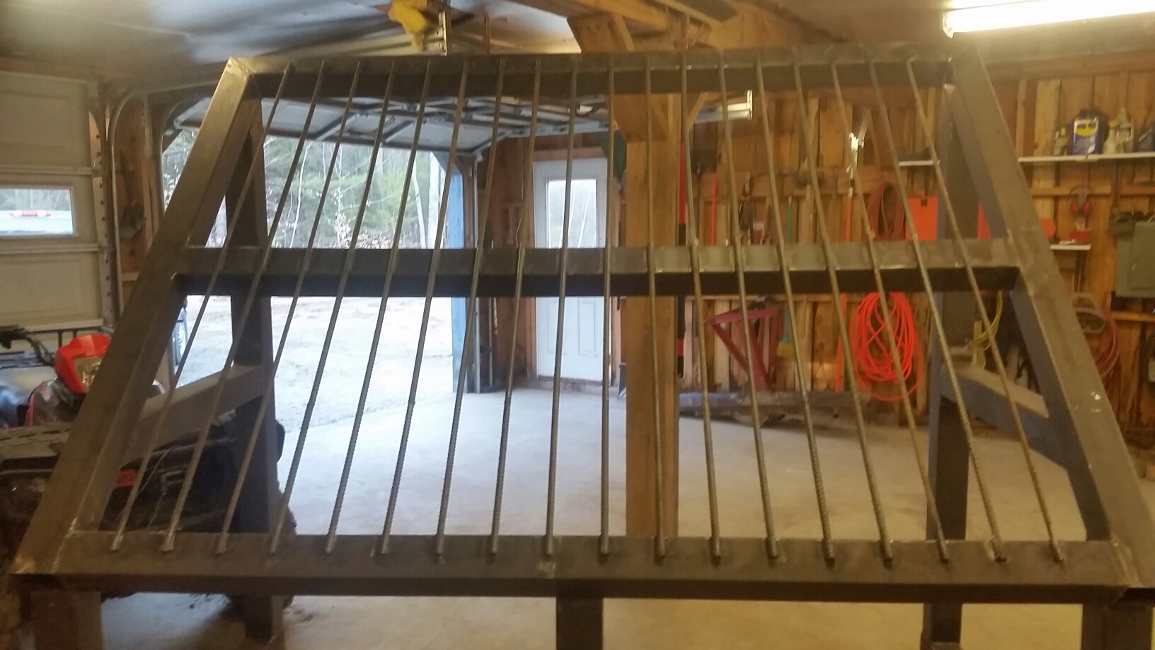

Made some progress this weekend, only have 4 or so bars left to weld on and the 4" screen will be done.
   / Building a Grizzly Screen
#28
Finished welding the 4" screen today. The frame is done, the screen is done, and the plywood sides are cut and drilled. Now I just need some warm weather so I can paint everything! I am going to wait to build the overlay screen untill I have a chance to run some material through incase I decide to make any changes.
If you have a good eye you may spot my mistake, someone needs to learn to mark witch side of the line the bar belongs on :D ! I started putting the bars on in the center because I knew the last space on each side was going to be oversized. It should have been 4" between each bar and about 4.5" between the last bar and the frame. But when I started I put the very first bar on the wrong side of the line, so I ended up with 4.25" on the left and 5" on the right. All the rebar I purchased was 5/8 but I screwed up and shorted myself a stick, so there are a few 1/2 that I had on hand mixed in, that also made the last opening slightly larger.
