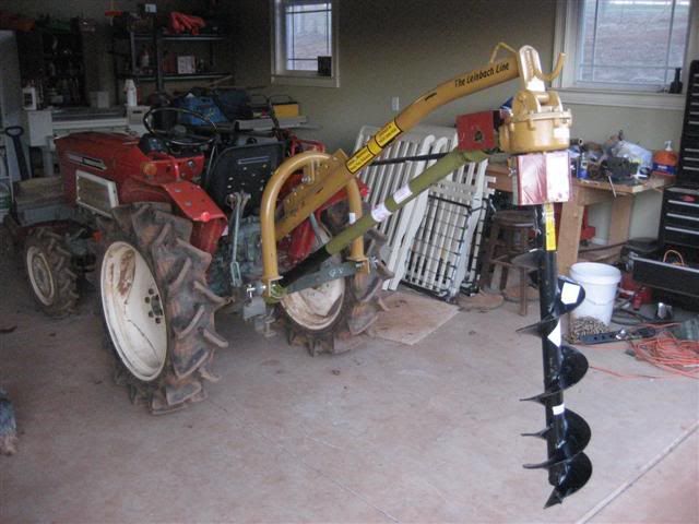

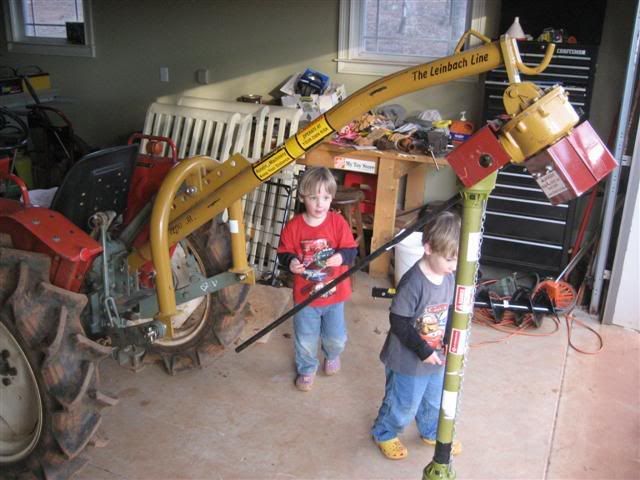

Here's a few photos of the Post Hole Digger. It's a Leinbach 7200jr with a 9" auger.
It took about an hour to get the thing together and on the tractor. I hope it goes quicker to unmount and mount. It's so awkward.
I haven't done any holes yet, but hope to this weekend!

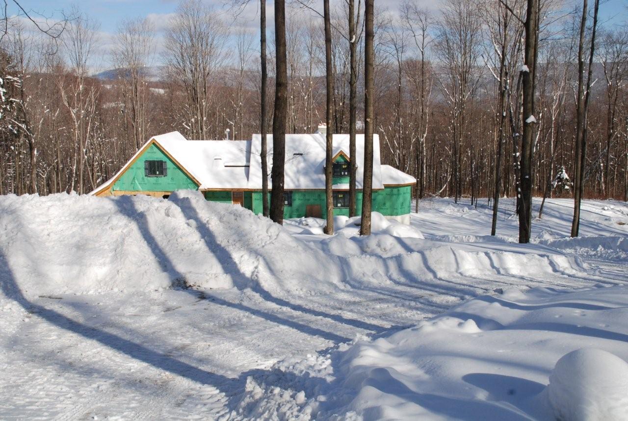

Tony - Here is our property; a slightly different climate than South Carolina. :D We are situated on the eastern slope of the Taconic Mountains, looking east at the Green Mountains.
With a different climate, we'll probably have slightly different goals! I've cleared about 1-1/2 acres so far using the tractor with a pto chipper. We intend to till several acres for a vegetable garden. Permanent plantings will include fruit trees and raspberries. Many varieties of apple trees are suited to our climate, and there are some cold hardy everbearing raspberries that should do well. We just moved to VT from CT, so we are still adjusting to new neighbors, new situations and new weather. So day I hope to have time to get a record of our project layed out somewhere on this forum. Right now I am too busy to keep up with it! I will be learning right along with the kids! We hope to raise dairy goats, beef cows, chickens, pigs, and perhaps a dairy cow in the coming years. Our children will all be homeschooled, so we'll have lots of time to learn together. Just watch how much work those twins of yours will get done in a few years! Right now my boys (and girl) bring in all the firewood we need - 3 cords so far, and that in tiny wheelbarrows or their sleds. Little ones sure have the grit to get-r-done. Enjoy them!
Edit: I don't have a post hole digger now, but in the past I would store it in a hole drilled in some well draining loam. That made the hook up a lot easier. Of course, yours looks pretty shiny still!
