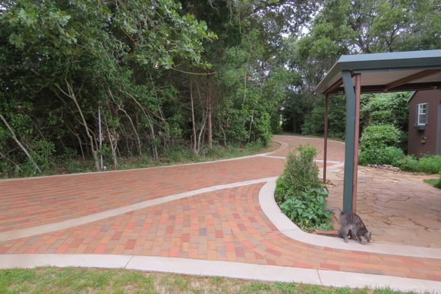

It will be a few weeks before I order anything. Thanks for all the suggestions. I'm slowly formulating exactly what I will need. Here is a picture of the location. I will need to put in a pole between and outside of the the two garage porch poles, it will be about 2 feet higher than the porch - about 9' tall. the 180˚ boom will be attached to the top. The hose will run under the porch roof to the pressure washer inside the garage.

Riptides - those booms start at $900 very nice, but I like the economy setup in the link better, just a need to find a swivel pole to hold the hose.

Kieth - I will try find aluminum first and steel second, I don't want a wooden boom. I really need to find that 10' Aluminum L - that's the hold up right now.
Forgeblast - I like the boom instead of a reel because as Yago says: "I strongly recommend having this arm (boom) as it keeps the pressure hose clean and off the ground, and keeps it from getting hung up on bumpers and tires as you move around the vehicle."
