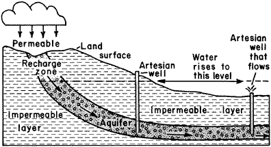

Many of you may not know it but you may be sitting on top of a formation containing pressurized water, oil, gas or a combination of all three. These could be existing in multiple layers in various combinations.
The water may be potable, contain salt or dissolved gasses.
Water may reside in a connate aquifer or have an aquifer open to the ground surface. The aquifers may be a few feet below the ground surface or hundreds of feet deep. And there are other types than the two mentioned.
If the ground surface in the area is wet then perhaps there may be breaks in under ground formations allowing water to the surface.
If it's dry the chances are the well can be sealed off.
As for knowing if there will be sinkholes underneath that may take a fellow is quite familiar with the local ground formations.:thumbsup:

If you are fortunate enough to have an artesian well, don't build your house over or near it. Artesian wells are very sensitive to the level of the water table, they loose some pressure when the water table drops as in drought, but really gain pressure during rainy weather. An artesian well under your house will result in constant dampness and probable water in the basement problems. I question whether or not filling the well will prevent any problem, the water will simply find another route, probably right up beside the filled area. Move the house and put a pipe and cap with a spigot on the artesian well and use it for exterior watering and a source of water during power outages. My neighbor's artesian well carrys 12 pounds pressure at the spigot. You are fortunate to have an artesian well, it means you have a constant, dependable supply of our most precious resource, enjoy.

Does the well actually have water running out of the top? Most drilled wells will not have pressure to push water out of the top of the well pipe. One of the wells in our area DOES or at least did right after being drilled.
If water is not flowing from the well I would think it could safely be sealed. But I would not build a house over the well. That is just me. If water is flowing I would not build a house over the well either.
