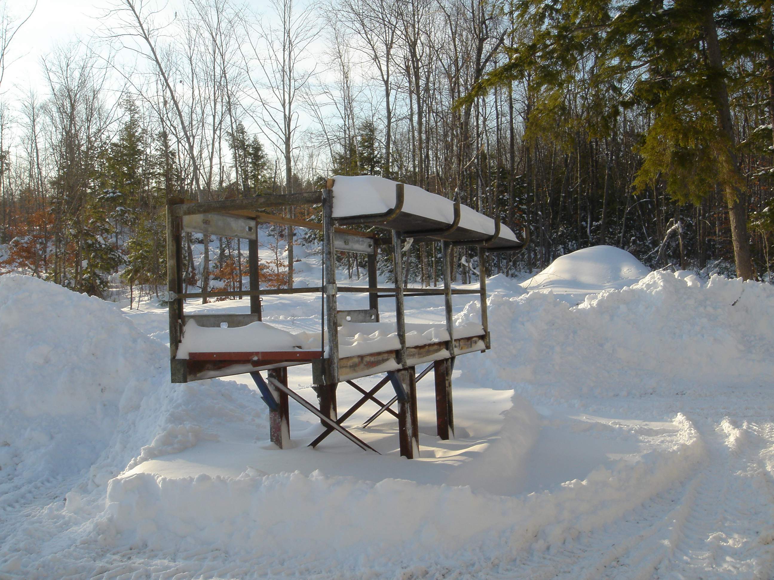

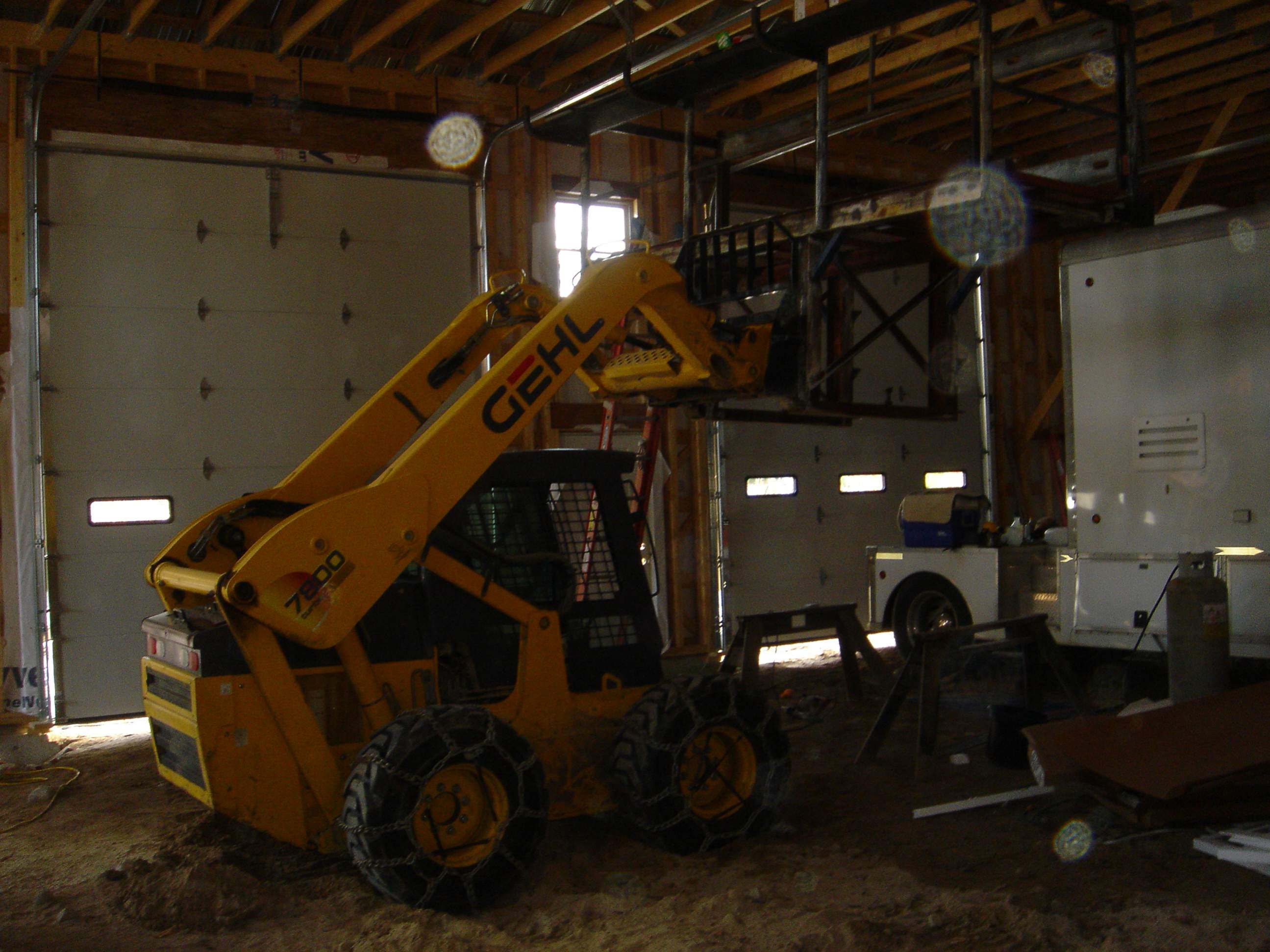

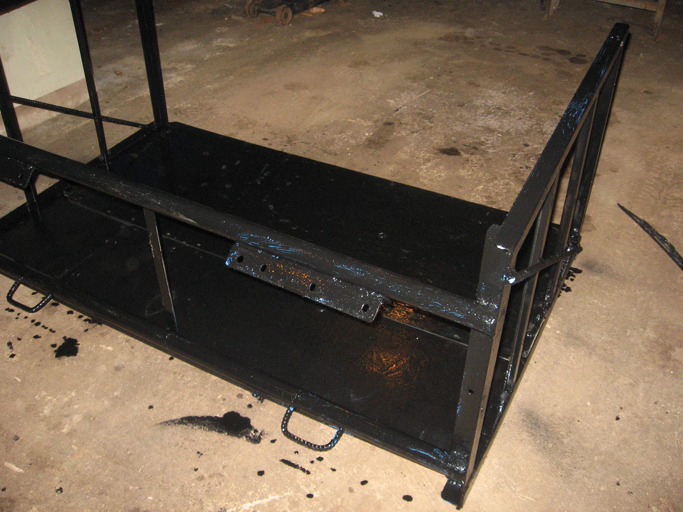

I built a lift that fit on the forks, this way they were much more universal and a natural for a telehandler. I made the platform @ 4' above the ground for extra height and it was able to give a worker about a 12' "reach" while sitting on the ground (no tractor) The platform is about 4x12, all structural steel. It has a "cradle" on the back to hold lumber or tools. The front side (away from the tractor) will open up completely, like for working on a wall or setting windows & doors. Sorry, the pics are not that great.

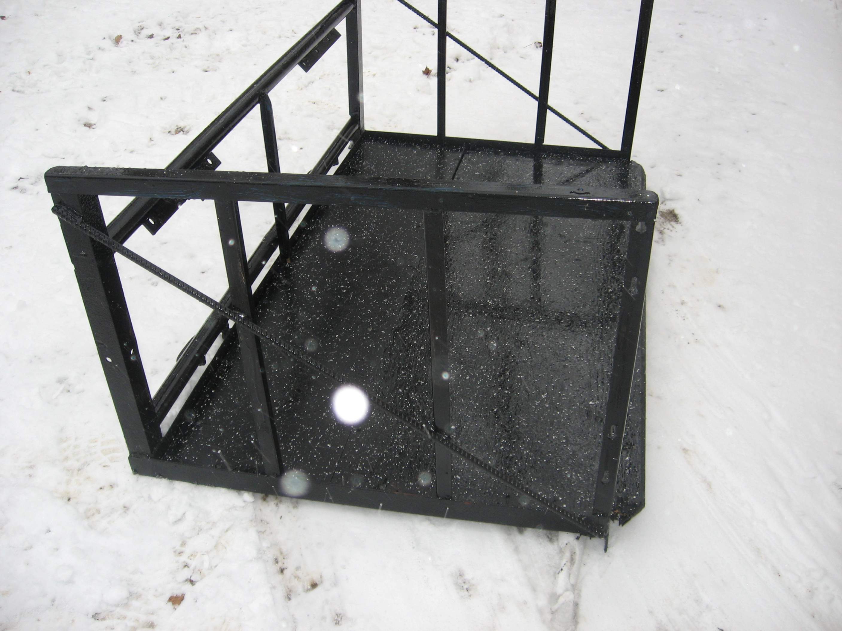

Here's mine. No door, kept it simple.
Just built out of scraps so dimensions came out to what ever.

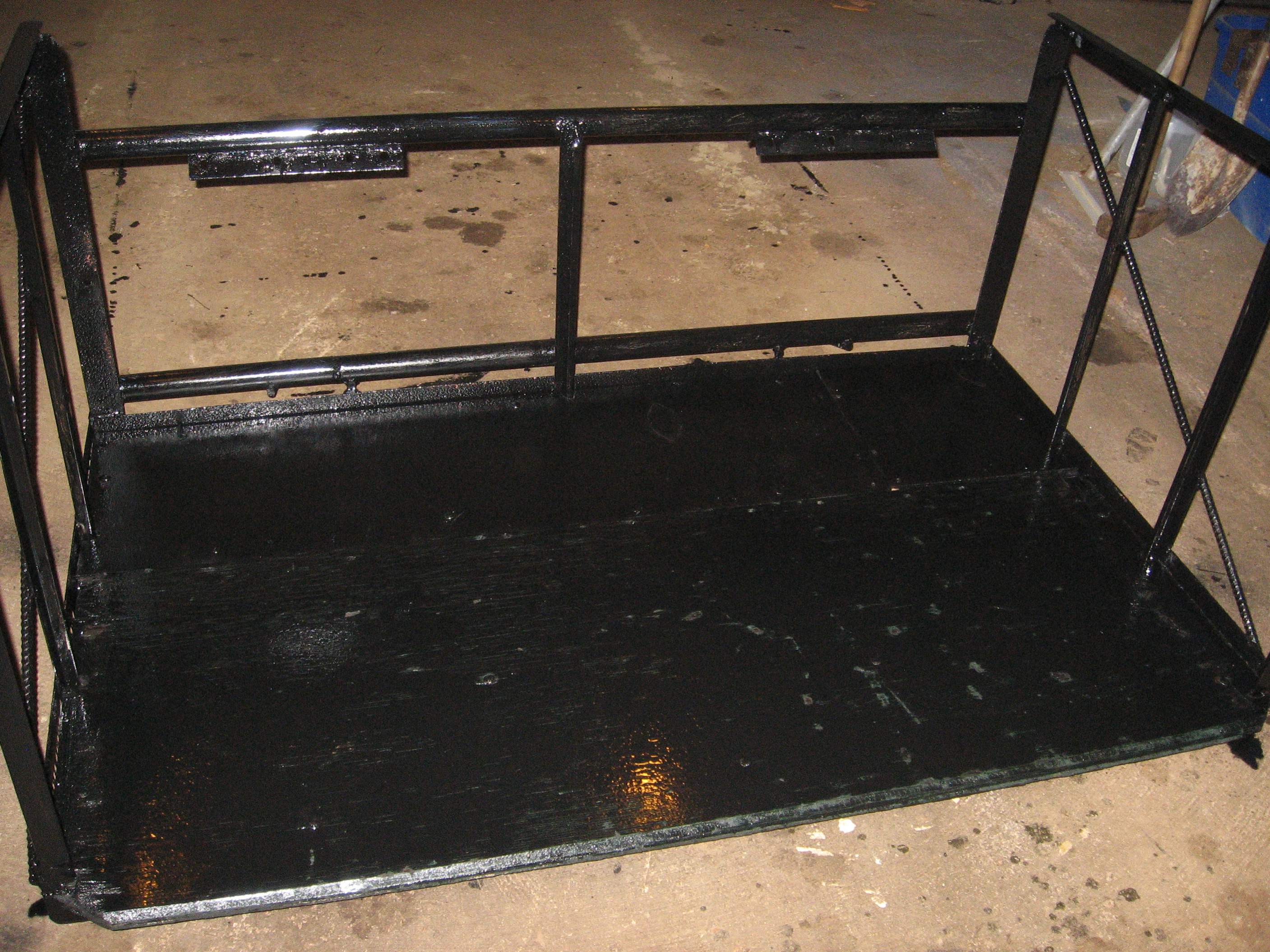

This mine. used metal and cost was about 8 dollars overall....even used some heavy angle iron at a 45 degree angle for the QA to 'hang' on and then rebar for the hole to take the pins on the bottom.I have already used it as a ''bucket'' to move washer and dryer. (lightweight stuff like that)..So if you have no/or removable from rail then you and double the use.

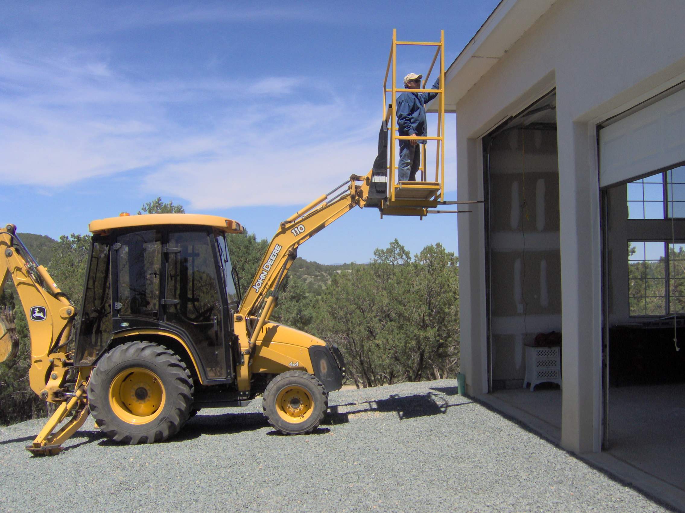

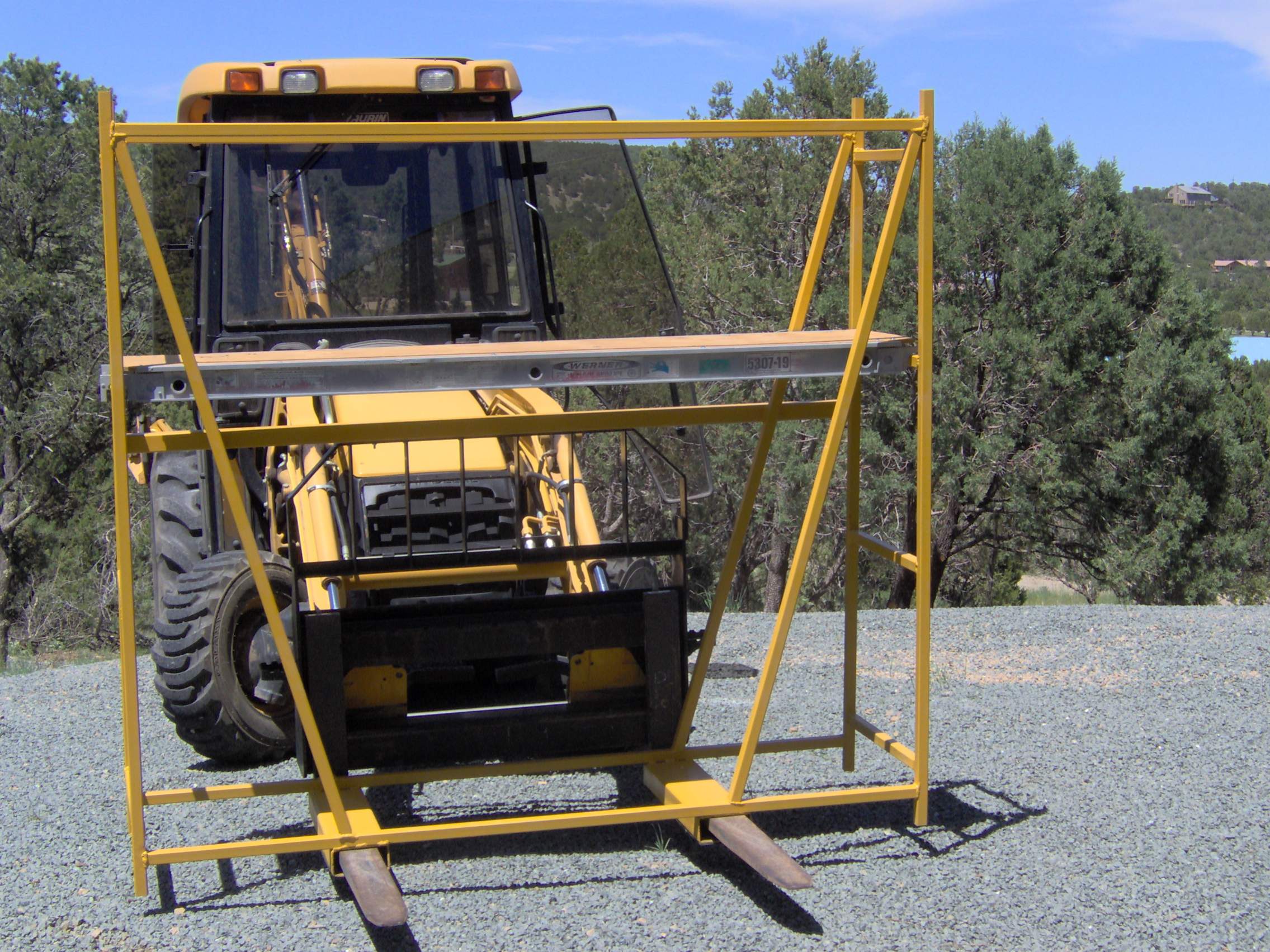

Here one I built for my 110tlb it is used with my pallet forks. The floor is a standard 7' scaffold board and can be raised to the top if needed. I also have a set of drop in top rails for the hier positions if needed. It does bolt to the pallet fork backstop to prevent it from sliding off the forks.
While these manlifts are handy they are a liability issue too, sure need to be careful when using them.
