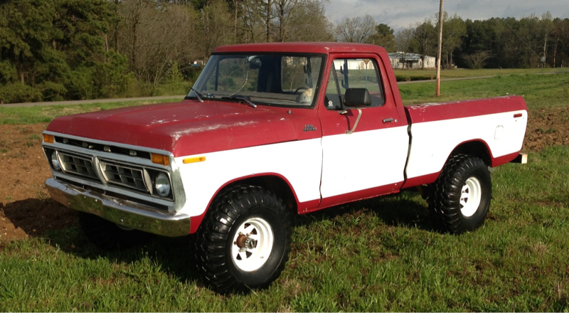

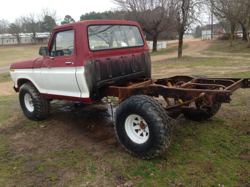

Ok using a 1977 f150 4x4 . Going to use a 150-200 gallon tank . And a 6.5 predator engine and a roller pump . Going to probley rig it boom and boomless . Got the bed off the truck today . Bought the engine yesterday. And have pump . Just got to decide the tank size . And figure out the pulley size to gear the motor down .
Any and all help on the pulley sizes is much needed .
A before the bed removal

Cool project! What is it that you're spraying? The old truck looks to be in good shape!... although i know looks can be deceiving.

Pastures for weeds/trees . And ya its a pretty clean old truck but I have a title issue that I can't seem to get straight . So I can't tag it . Plus I have 4 other 78-79 ford short bed 4x4's that are streetable . And I only have $200 in the truck .

Wow... where I live it's rare to find a 98 with that little rust. :(

It pretty much rust free .
