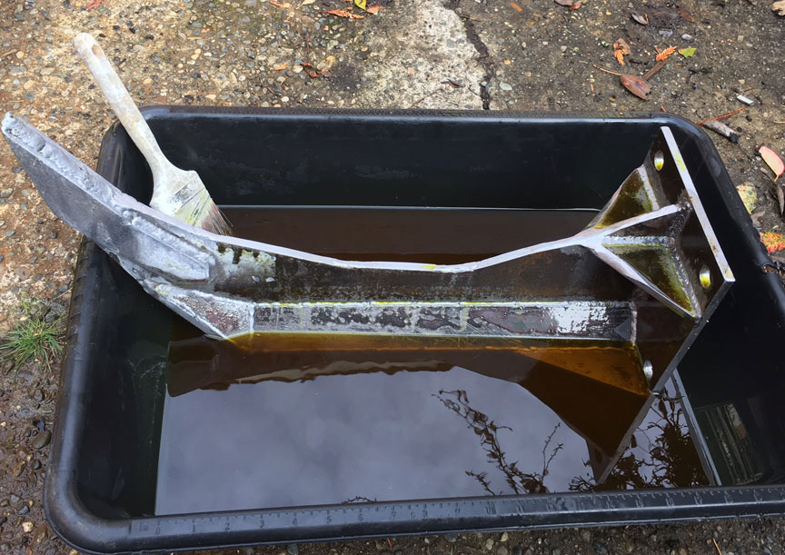

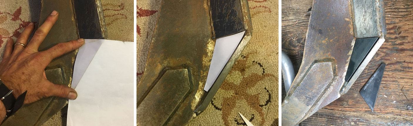

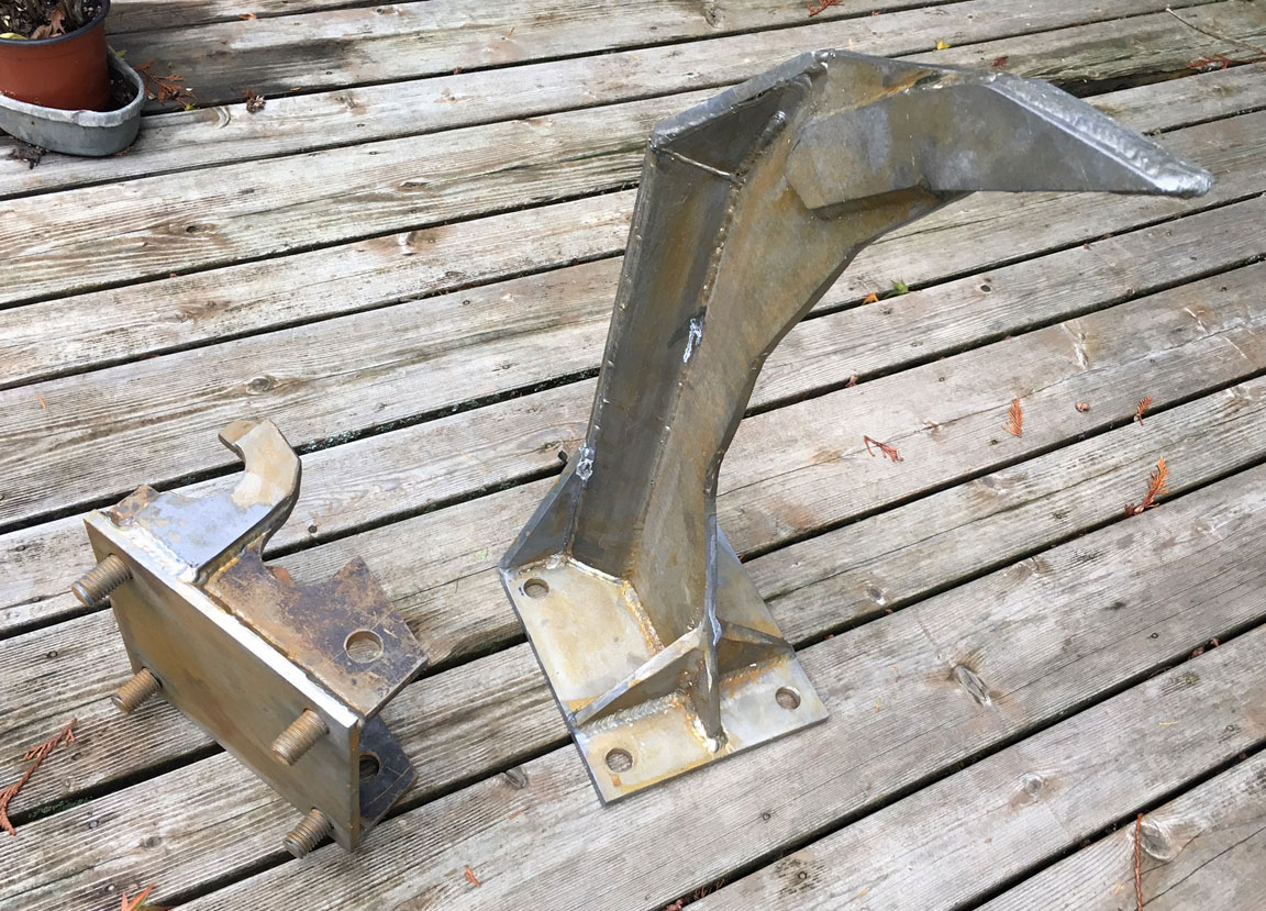

I used the claw a little and it rules. Much easier to dig in rocky soil after ripping the ground up. Decided to do a little more welding and then paint it. See if it can look almost as good as Pat's stuff.
486529d1477960012-building-ripper-claw-kx41-mini-kx41_ripper9-91-jpg
Used the dirty-finglers template method.
486530d1477960012-building-ripper-claw-kx41-mini-kx41_ripper9-92beforebath-jpg
Here it is before the acid bath.
486531d1477960012-building-ripper-claw-kx41-mini-kx41_ripper9-93takingbath-jpg
During the bath.
486532d1477960012-building-ripper-claw-kx41-mini-kx41_ripper9-94afterbath-jpg
After the bath. It comes out of the acid shiny but quickly develops a slight rust discoloration. The surface it etched (rough) and I hope it holds the paint.

It won't hurt to paint it, and it will look great for a while, but as soon as you stick it in the ground, much of the paint will be gone anyway.
