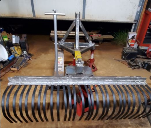

I have angle iron for the tines I really like this design for connecting to the angle iron.
I could add one more support in the middle.
This design is great if I ever decided to add wheels later down the road.

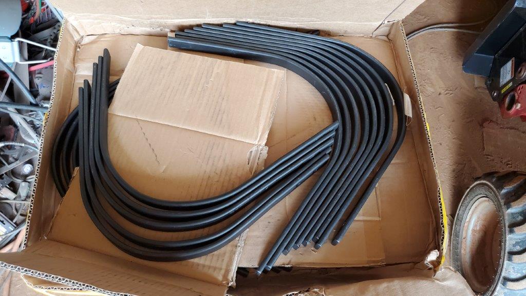

The tines imported from Italy have arrived. All 62 pounds of them.
I just ordered to the 56 (100) bolts to put this together.
I hope to get to work on this built over the weekend.

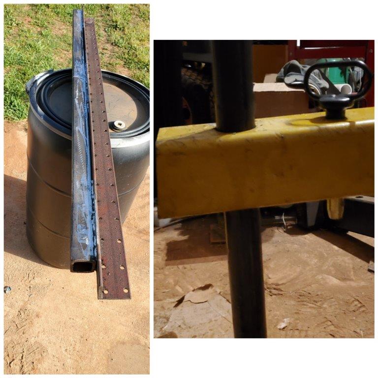

I made some progress. The front of it is done. It is mostly 2" x 2" 1/4" square tubing.
The main boom is 3" x 3" and I have all 56 3/8" holes drilled.
My bolts come in tomorrow and two hole saws coming in on Tuesday.
I bought Nylock bolts so they don't come loose on their own.
I have work for this rake to do and I would like to get it finished. No one local had the hole saw size I needed so it will take a little longer to finish it.
To help place the tines I use a baluster spacing application
Baluster Spacing Calculator - Centers, Spacing & Quantity - Running Measurements and Diagrams (US Imperial)
Can you give us the link of where did you ordered the tines please?

I bought them from AgriStore because they have free shipping. My tines were $140 shipped.
Two Hole Landscape Rake Tine | AGRISTORE USA

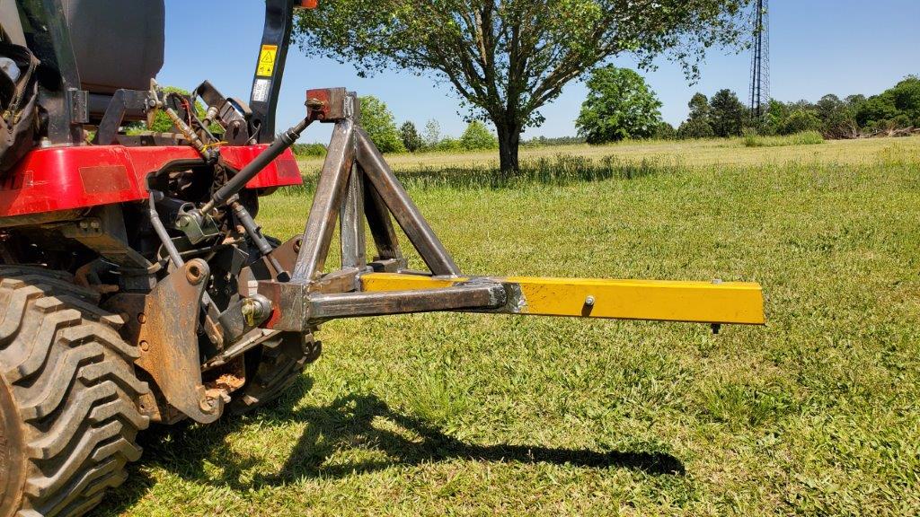

I made some progress last night. I mounted the pipe that holds it. I drilled it for the position pin.
I welded some 2" x 2" 1/4" square tubing on to my angle iron. That should keep it from bending.

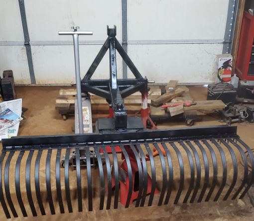

I used a drill press but it still was not fun drilling all those holes.
The rock rake is very close to being done. I am going to add kick stand and I need to paint it other than that it is done.
It was raining today so I could not test it out.
The angle can be adjusted five positions forward and three positions backwards.
Once I get it outside, I will get more pictures.

Thanks. I used scrap yard steel. The project cost $200 to built. Most of the cost is the tines and the bolts.
It is pretty heavy duty there is 1/2 plate under where it the pipe holds it together.
I put some paint on it.
