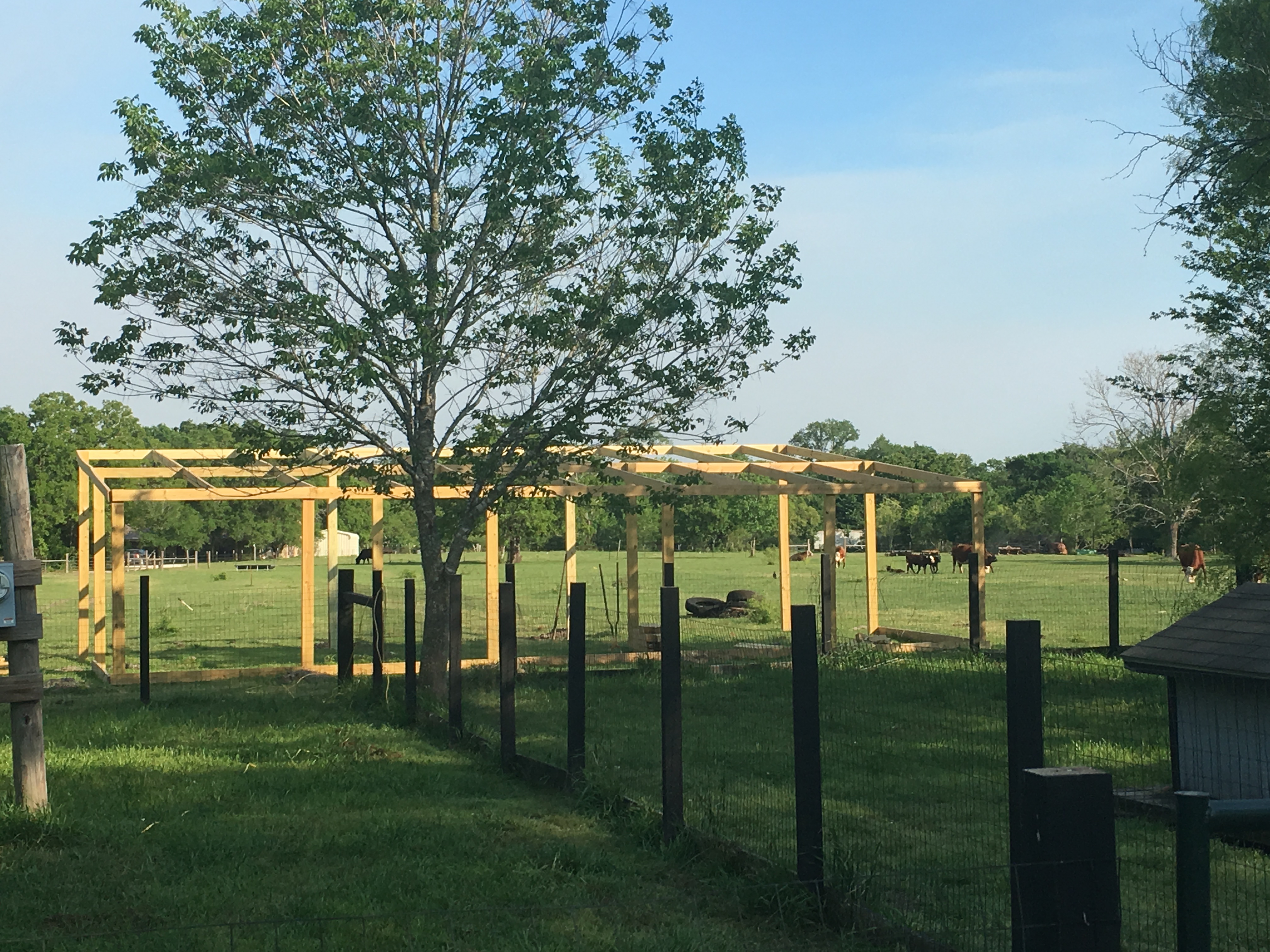

I understand the 3,4,5 concept. Just not sure how to lay it out. Used welding rods to mark the corners and had em right according to tape but by the time I drill the holes and put post in ground it's not in the exact spot any more. Figured I'd just let the lathe overhang however it needs to to try to do the roof which will be tin.
   / Building a shed #12
I stake out with batter boards and string and use a rafter square to get close to square when I turn a corner. Then I dig the holes (way oversized to allow for adjustments) and do the diagonals before I plant the posts. Looks like a pretty good sized building so I'm sure you'll be able to hide 6", just a little more work to make it look nice. And if you are using tin (which I assume are the pre-cuts) you might have a little more cutting to do. Just plan ahead and work that 6" into small increments over the span.

Are you building a shed style roof? Why are the front posts so tall? A simple build is to have front higher then rear, probably not alot since you are in Texas. Then rafters from front to back.
I bird mouth front and back rafters, creating an over hang, also can take alot of weight. But again not really needed in TX.
I am ahack just learning. Done two sheds with shed style roof. So next one I should do gabel.

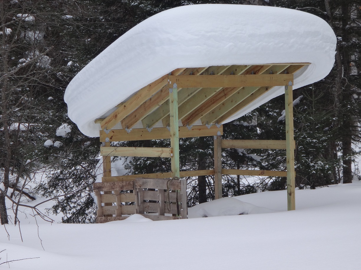

Hi RobbyR,
Looks good, but around here, that's not a shed it's a barn!
I'm about to build another shed with a lean-to roof like that to park pallet-bags of firewood in to season, with the south exposure open to the sun.
Thomas

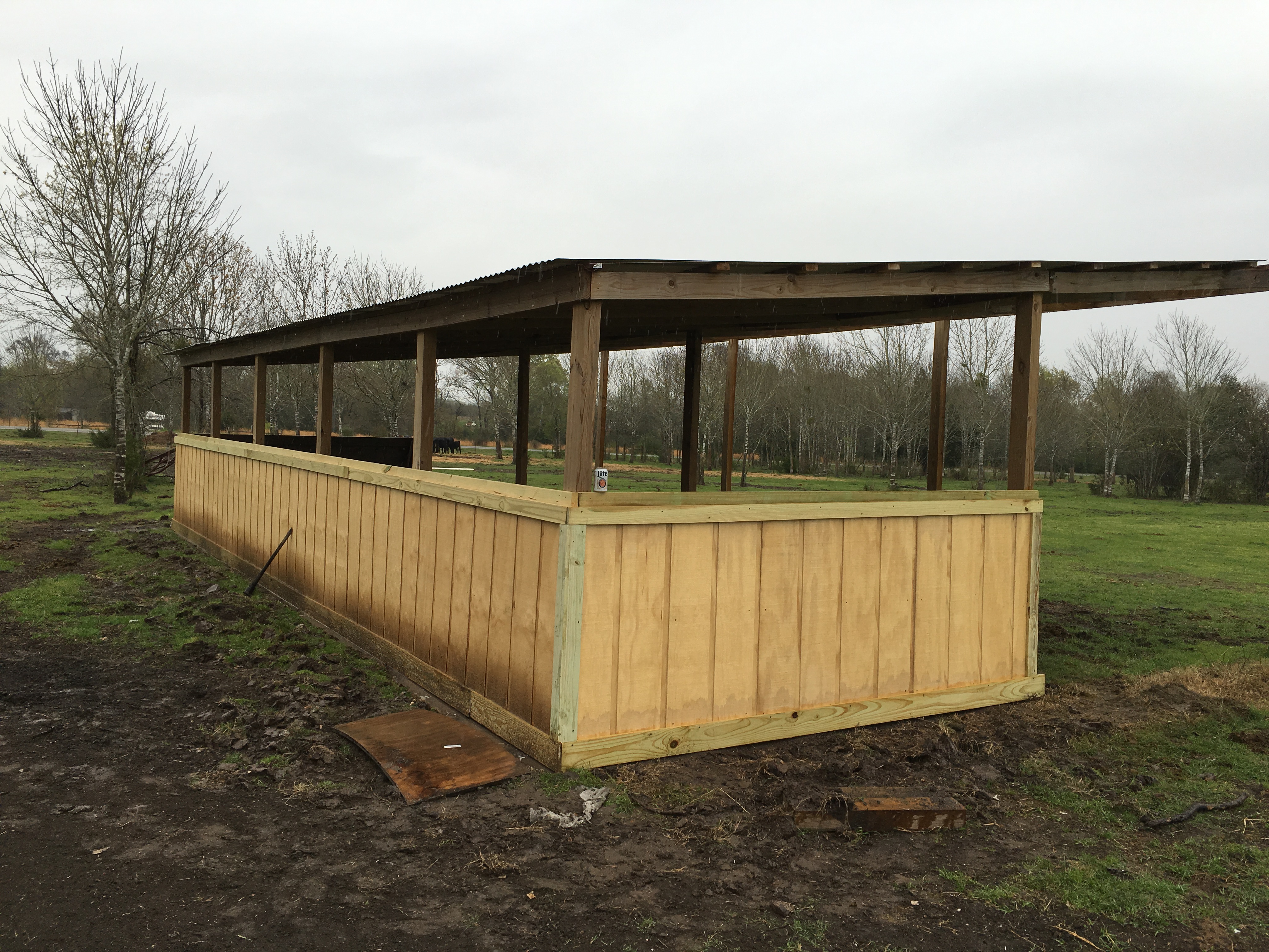

My son came over yesterday and helped. Finished the rafters then I cut the posts off flush. Next step is putting the lathe up. Plan on using the "old style" corrugated tin.
   / Building a shed #19
With your planned materials you should be fine. "Ribbed" steel is a little more finicky in that the finished panels will form a uniform surface across the width from top to bottom. On wide buildings 6" can be made up in small increments (your trim/ridge cap will hide it) and you would never know. On smaller structures you might see it. Perhaps I'm fussy but when building any structure or deck I spend a lot of time on "square/plumb/level" simply because I know that "close enough" will cause me headaches later.
