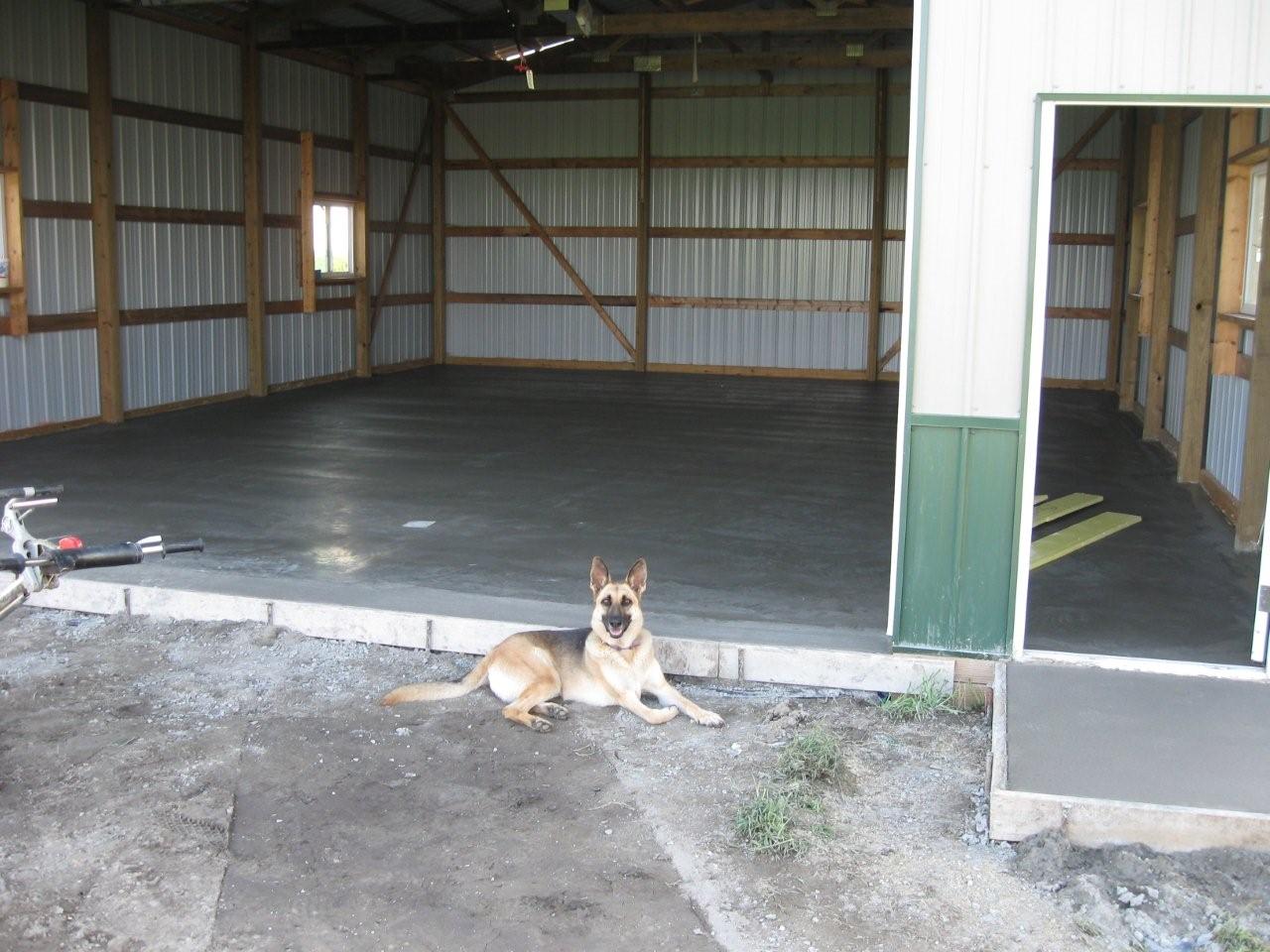

Starting to actually become a shop...
Long time since the last posts. Back in early August, I was finally able to get a crew in to pour the floor in my new shop. Prior to that, I had a lot of lot grading to do back in the sping, lawn seeding, and in July I trenched in some drainage tile under the shop floor pad including a stub for a floor drain. Turned out well, now working on getting the lights and outlets wired.
Is that concrete on the lower panel? Unless you washed it off right away I have the feeling that it is there to stay!!! Nice watchdog too.

Nice watchdog too.
Not sure she's much of a watchdog, but she's pretty good at laying down and looking exhausted after a hard day of watching me work!
