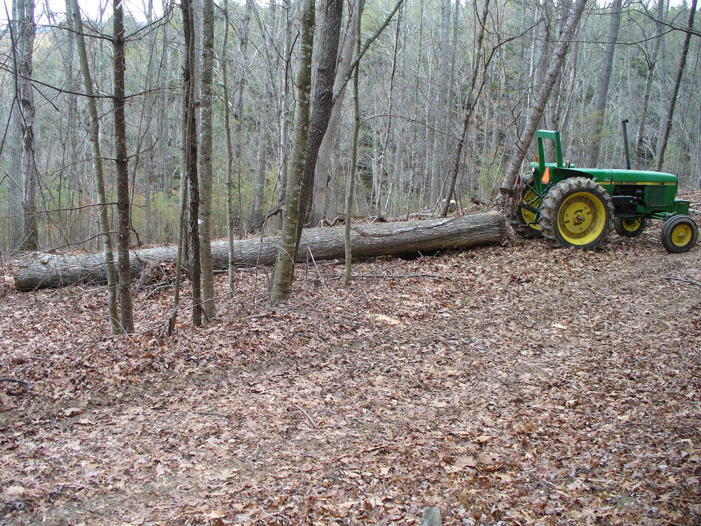

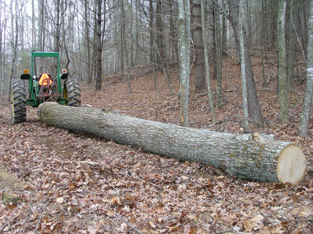

Just a follow up, the 3pt hitch logging arch is working well. It mostly gets used behind the 2550 JD in the pics and my fathers 5045e, both of which are much larger than the unit was designed for. It is holding up well, surprisingly even the cat. I hitch pins are still straight. Below are a couple pics of it hauling out an almost 8000lb Oak log.

Did you make any further additions or mods to the design?
That is a big ole log.
T
