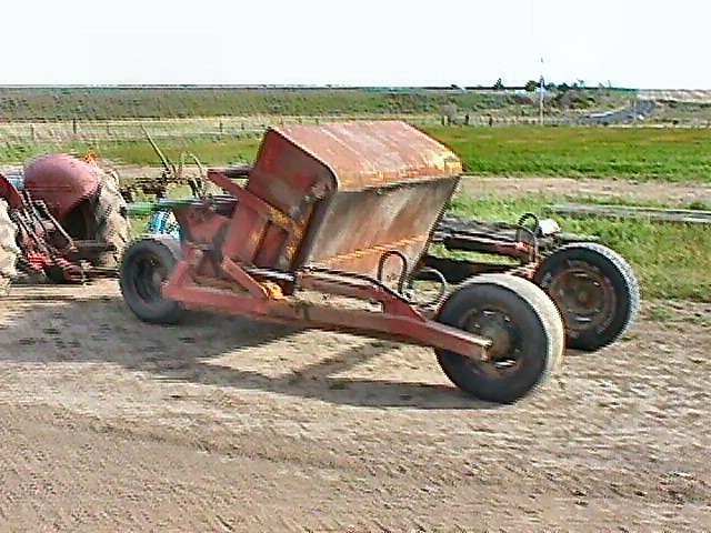

Ok here is what I would be interested in knowing.
Back in the 50's my Dad designed and built 2 different wheeded pan type scrapers. 1 2 wheeled 1 4 wheeled. They eventually went on to be commercially made machines. I have 1 of each machine the #2 2 wheeled prototype and 1 of the commercial made 4 wheeled models. I use them both esily pulled by my MF 35 38hp. I can esly move 15 yds per hour with the 2.5 yd machine.
Even by todays standards the 2 wheeled machine is an advanced design, loading from the front bottom, unloading from the back bottom both processes work very fast and are precission spotting. I also have all the building notes and all the original sketches that he made them from. The 2 wheeled machine holds 1.25 yards the 4 wheeled machine holds 2.5 yds. My question is this if I made new CAD drawings for either of these would anyone be interested in buying sets of construction drawings for either and what would be a price that someone would pay. This will be no easy task. I am open to all opinions here. Thanks
2 wheel scraper picture
http://www.tractorbynet.com/forumfiles/879843-Frnt%202%20wheel%201ydcrp.jpg
4 wheel scraper picture
http://www.tractorbynet.com/forumfiles/879825-Rear%204%20Wheel%202.5%20YD.jpg

Is there a patent on the scrapers?
I see drawings for sale on Ebay and the Internet. Most of the time the drawings are sold for under $20.
The scrapers sound interesting and if they can be build with out a major amount of tools and machinery I am sure that quite a few TBNers will be interested, me included.
Farwell
   / Building A small pull pan Type scraper
At the time both were patented by my Father. But have long ago expired. The 2 wheeled scraper ceased production around the early 60s the company disbaned, and no one else ever produced that scraper again and used ones of the era are scarce, they were made in up to 4 yds 6ft cut.. The 4 wheeled machine has a simuliar machine still in production smallest being 3 yds 6 ft cut much to big of a cut for a small tractor. Sells new for around $8000 USD. Either of these could be made for less than $1000 using NEW material in a home welding equiped shop with little out source work and little or no machining with the use of standard of the shelf parts. Both are hydraulic powered units.

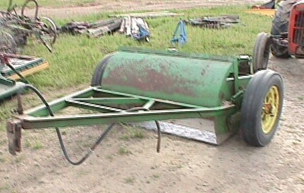

OK here is a picture of the 4 wwheel scraper
(see click attachment)
