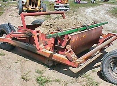

That'd be a "Tumblebug"..doesn't need hydraulics.Just pull the rope or lever and it rolls foreward to dump! /forums/images/graemlins/grin.gif

Your "tumblebug" is the exact same thing as my "Fresno". I don't know who built the one picutured, but mine is near on 60 years old and works fine with oiling/greasing. Adding a small subrame with tires and hydraulics has crossed my mind.
In short, earthface, while I like these devices, the buying public at large seems to have moved on to either: a-the box blade for small tractors. b-the drag box blade for medium tractors combined with FEL. c-no real desire to use 100-200hp tractors for earthmoving in lieu of dozers, etc.
We see a resurgence in the use of the 4wd/scraper combination, but that's really all.

This is a 2 wheel unit
This is a unit with 4 wheels
Both these seem to be a very simular unit to my 60 year old 4 wheel machine, with only a few modern updates.
