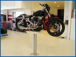

Yep , the lift post would be next to you the wall. The bike would load onto the lift table with the front tire close to the lift post.
Hope that helps you with the concept..
Both sides of the bike would be accessible.

   / Building a stationary motorcycle lift in my shop. #13
So you'd. nose the bike up to the post, then lift up. Sounds like plenty of room.
   / Building a stationary motorcycle lift in my shop. #14
Bestway Hydraulics: Motorcycle Lifts

   / Building a stationary motorcycle lift in my shop. #15
Oh. That oughta work. Carry on...:thumbsup:

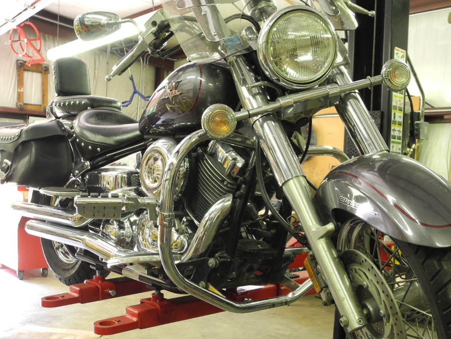

OK, let me throw one other option at you all. My shop is equipped with a two post Bendix lift. I have toyed with the idea of trying to come up with a lift table utilizing just one side of it for motorcycles. The reason I have not followed through with that idea is, I can't figure out a way to have access to both sides of the bike. Obviously, since I already have the lift, building a contraption or device that just fits into the lift arms would be much cheaper.
My last motorcycle lift was a HF motorcycle lift table with air over hydraulics. Was pretty slick but, it simply took up too much floor space and ended up being either in the way a lot or with all kinds of crap laying on it that never got put up. Yeah, I know that's my fault but, I don't need a storage table. And, I can't afford to lose floor space. The HF lift took up too much space and was just too darn heavy to be moving around all the time. Nor could I just pick up one end and stand it up against the wall.
My Valkyrie doesn't take much maintenance it does require that drive line to be service every 10K miles or so. Other than that and oil changes, it just keeps rolling along. But, back to the two post lift idea, any suggestions?
   / Building a stationary motorcycle lift in my shop. #17
How about one of these? Redline RE-2PA 2 Post Lift Motorcycle ATV Adapters - FREE SHIPPING
Perhaps with the pads on all 4 arms, or with the arms slid out further to make access to the backside easier?

WOW!!!! That's a whole new concept I had never considered!! I was focused on building something I could ride the bike up onto. I can visualize a way to use something like that while using the long arm of each post and having access to both sides of my baby. This may be the answer. I'll fabricate my own but, it's the start of a great idea. Thanks. :cool2: If you ever travel to or through Central Kentucky, I owe ya one. :drink:
