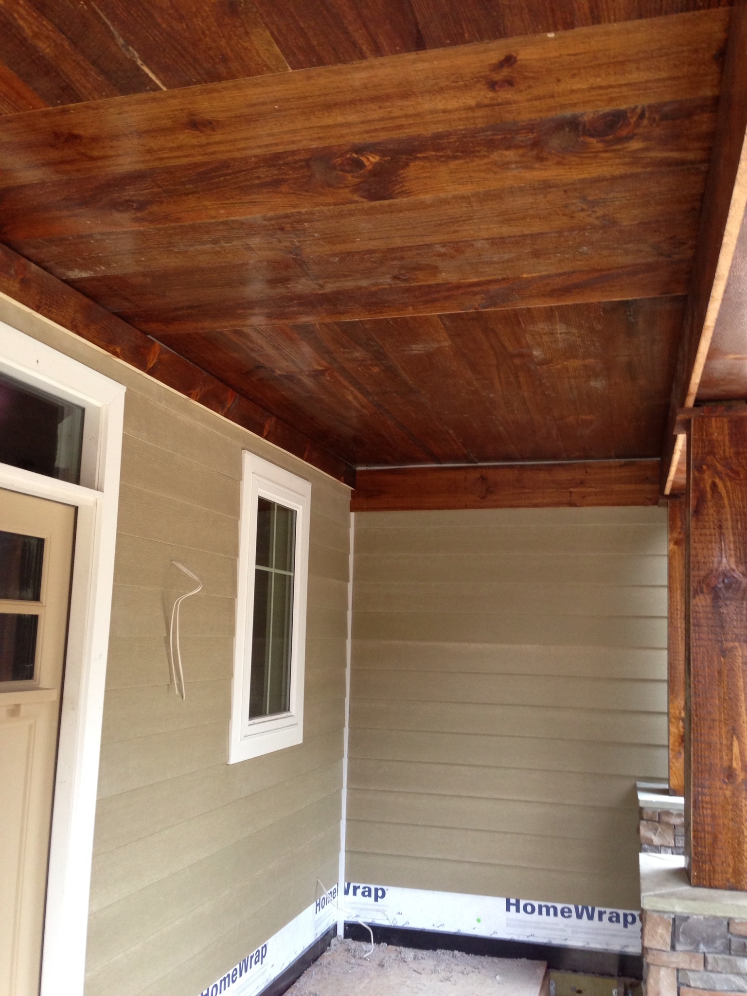

We used spar varnish on the exterior details of our new house, and its already working up a nice patina after a few months. If I recall right, the benefit of spar varnish (a urethane) is that it remains flexible, thus holding up to weather better. Here's a shot of the porch ceilings.
