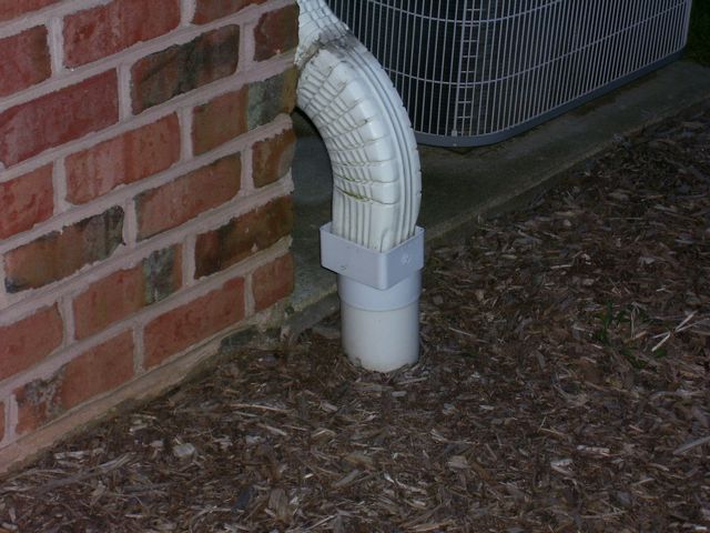

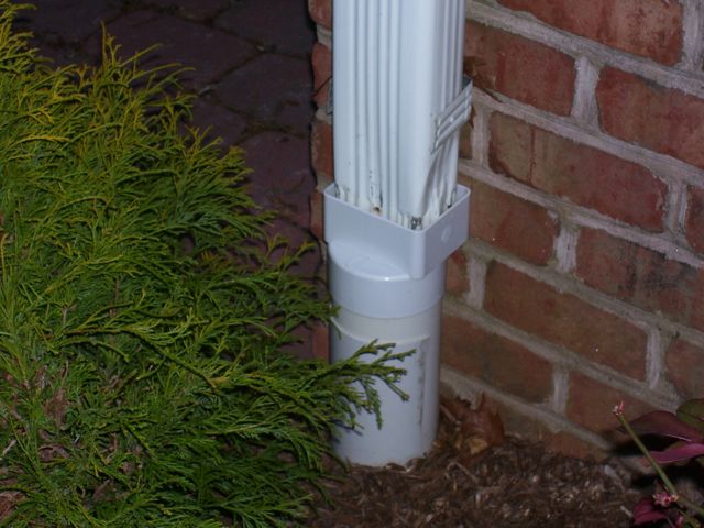

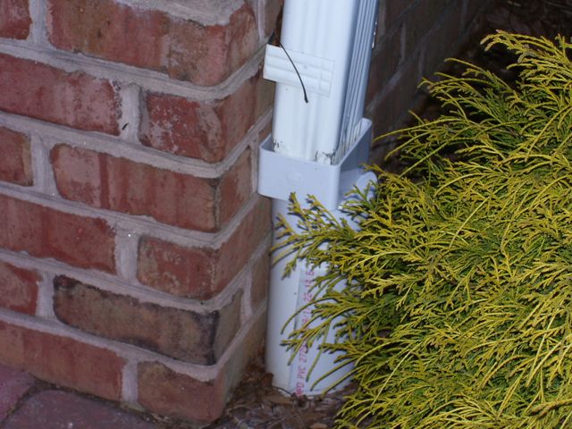

Paul, here is how my downspouts are attached to the 4" PVC underground drainage pipes. FYI the downspouts/gutters are oversized.
Yes, that is it. You have the proper adapters unlike Peter. We used the same ones on my Mom's house which also had the commercial gutters and downspouts.

I think the downspouts will be fine the way they did them and with flowers/bushes around them not be noticeable, as the Y fitting way would be. In any case the alignment problem with the downspout and the ground pipe would be the same. You always have an effective drain the size of the smallest component. A 2 x 3 downspout has 6 square inches whereas a 3 x 4 has 12 square inches.
Your ground pipe looks to be 3" so pi x the radius squared=4.8". If it is 4 inch pipe then it is 8.5", which is normally used with a 2 x 3 downspout..
