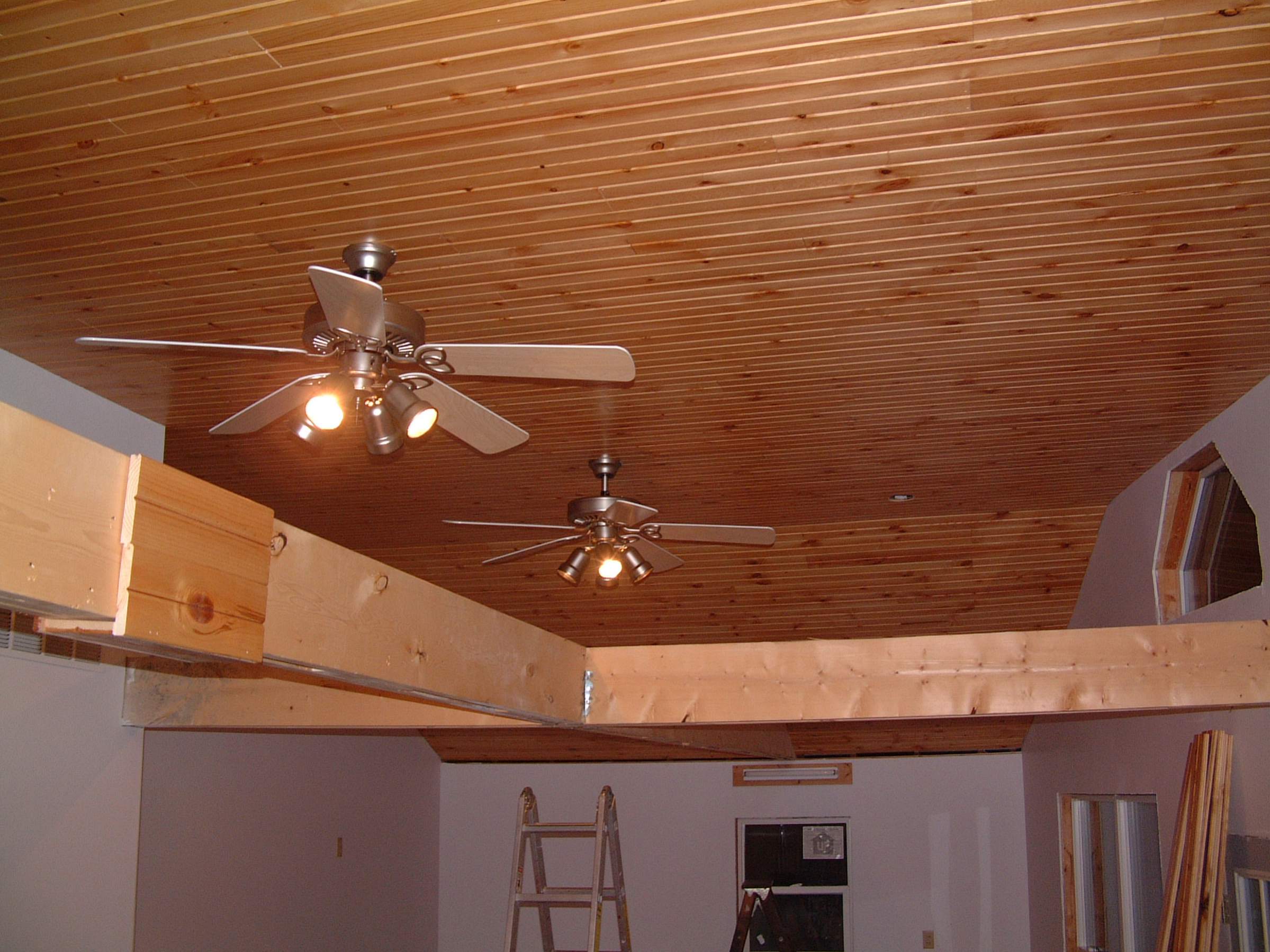

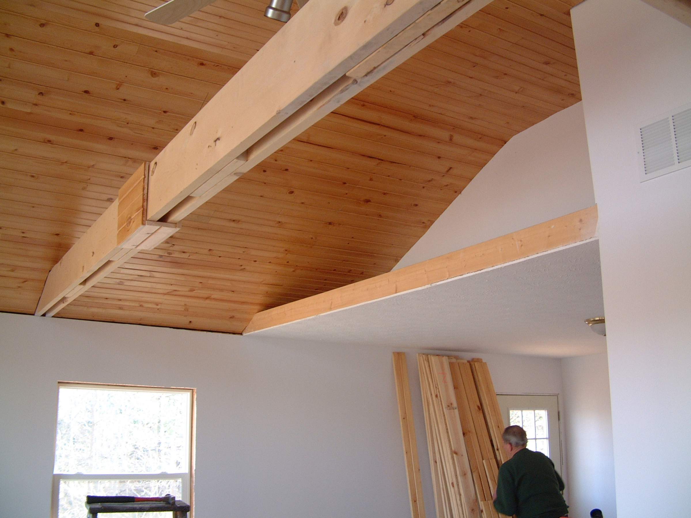

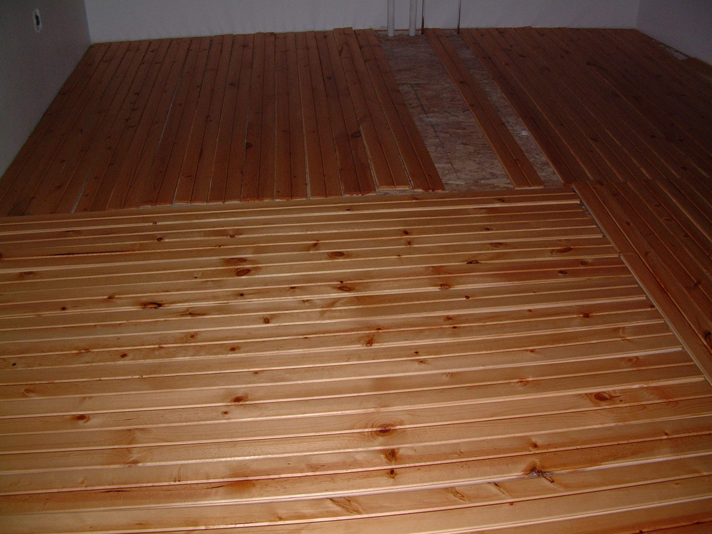

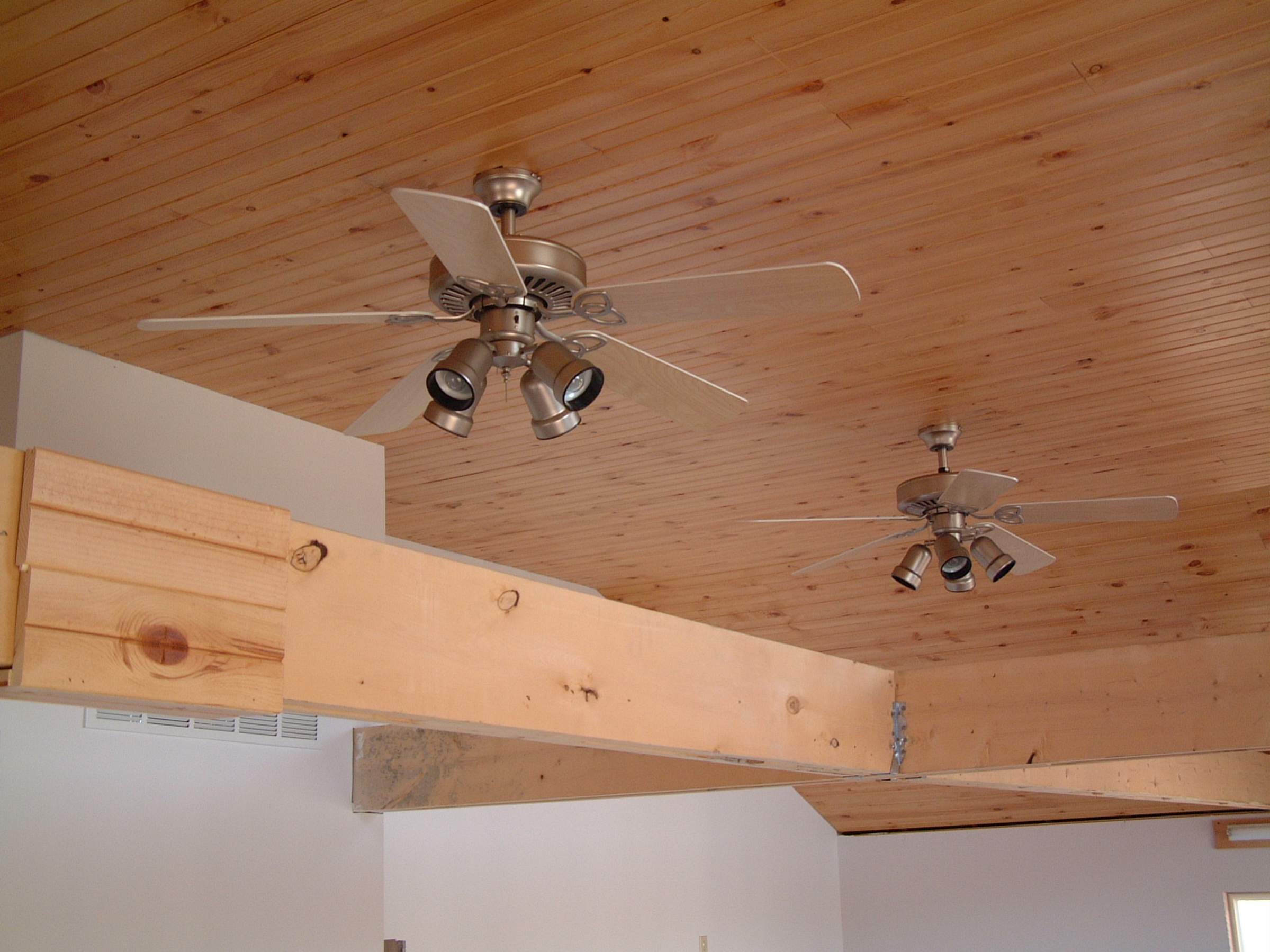

I guess I did it all wrong
I sanded, stained and urethane my t&g before putting it up
It seemed to work out nicely and I would hate to be on a ladder or scaffolding trying to sand & stain
View attachment 314693View attachment 314694View attachment 314695
Are you saying you didn't want to do your Michelangelo impression of him painting the ceiling of the Sistine Chapel? :laughing:
