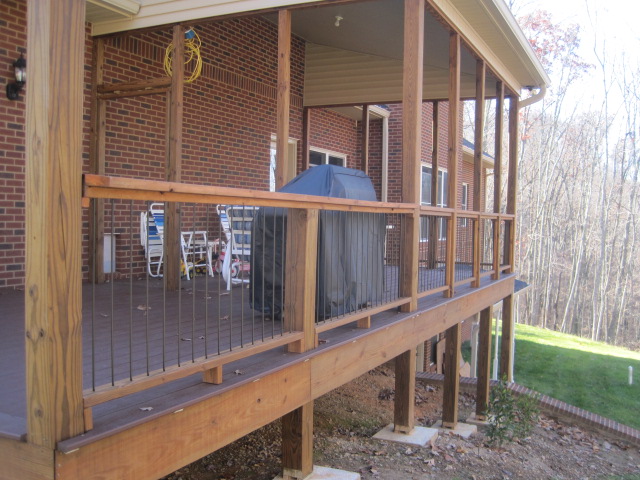

srs has already addressed my concerns on the railing issue. The posts appear to be bolted but need a better pic. The railing looks dangerous to me. Over time, the pressure treated wood will get brittle and become loose from the screws. You really need a handrail on top to tie in the railing and the post all screwed in from top so there is strength from side forces. If you don't like the hand rail look - you should get the railing brackets and drop the railing in.
   / Building a stick frame house in the woods in 90 days #1,613
radioman, I think Peter should possibly install some galvanized or stainless steel metal angle pieces behind the top railing on the outside (the woods side) and "lag" them into the posts. That way should Pete's mom and guests lean against the railing the steel angle pieces would prevent the railing from collapsing. I agree with you the railing is dangerous and a disaster waiting to happen.

I suspect that the code will require a similar attachment. My county required me to install some sort of metal attachment bracket on all rail posts. My inspector provided me with a copy of this article.
Code-Compliant Guardrail Posts - Anchors, Framing, Locksets And Hardware - Professional Deck Builder Magazine
My local builder supply had the Simpson solution on hand. They are pricey and in some cases overkill.

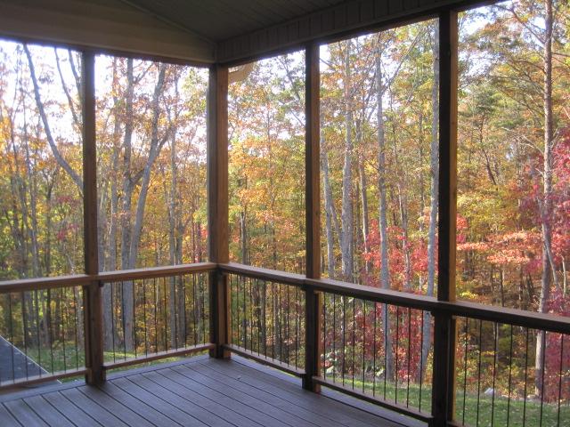

The pickets in the railing are powder coated aluminum. The did complete the railing today and while it looks good, it does not seem very sturdy. I believe they used lag bolts into the 2x12s, and the 4x4 posts push out rather easily when leaned against. Didn't get any detailed shots of how they are attached, but will do so tomorrow.
Day 101
Some shots of the completed railing
