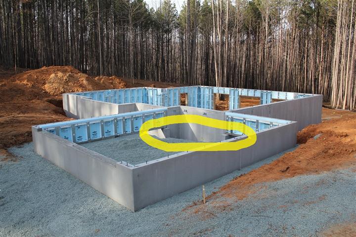

Pete,
Have you thought about how the gravel under the garage slab will be compacted to prevent significant settling? Of particular note is the depth of the gravel at the area where the garage meets the house? I had this same issue at my house. We did not do it correctly and I may pay for it eventually.

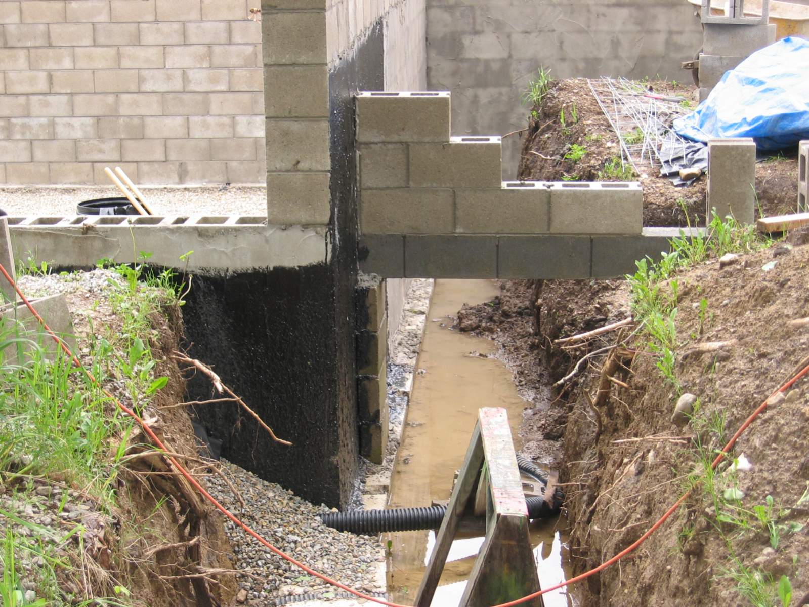

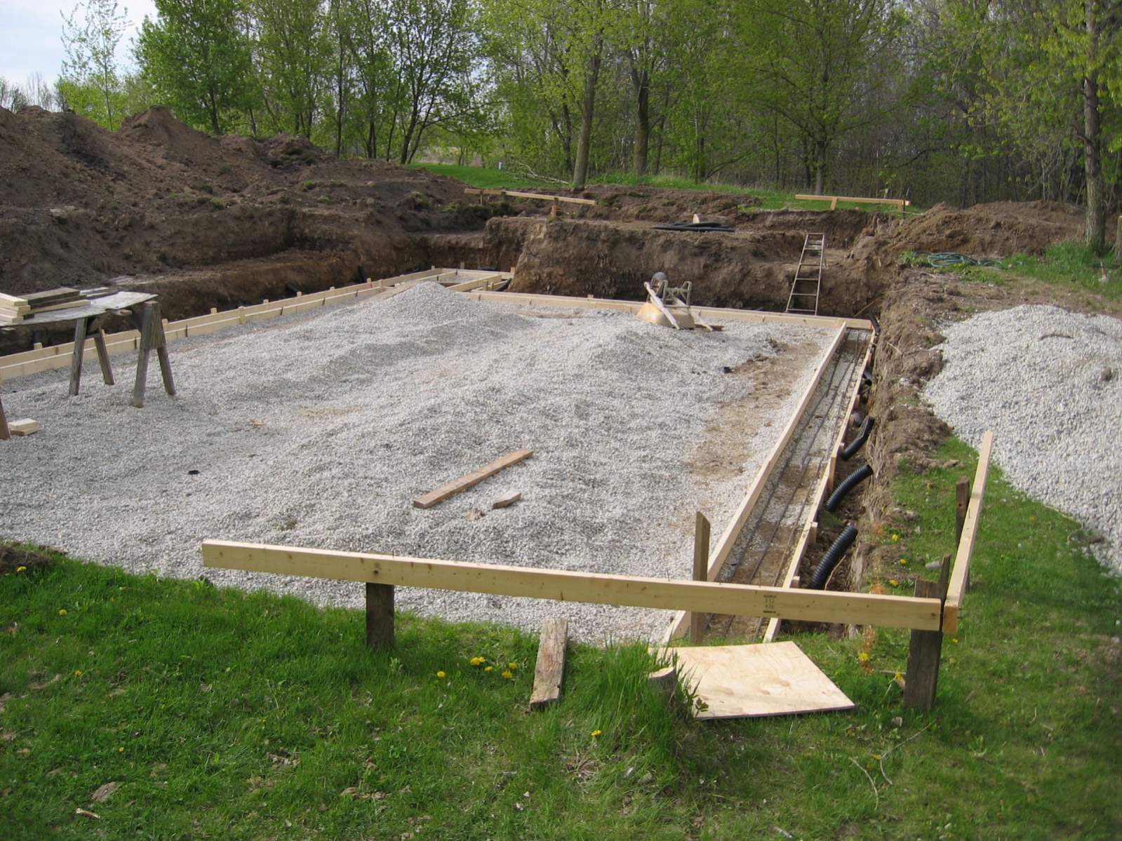

I used 3/4 clear stone 104_0484.jpgand my set up was similar to that. I had about 5-6' of it dumped along house walls in the garage and just compacted it with a walk behind plate compactor. The garage floor itself had about 2-3' or so of the same stuff.105_0548.jpg The floor has been fine for 8 years.
I worked with some excavators that dug holes for 2000 Ton punch presses and had holes 25' deep. They had to fill the perimeter of those big holes around the concrete foundation that full depth and they used that same crushed stone. It was about 2' thick around and all the way up to the concrete floor. Our company engineer made them compact it every couple feet, but he said hardly anyone compacts that because it doesn't compress. I compacted my garage just to be sure, but I don't think I would have had to because it hardly settled out at all.
The nice thing about clear stone, if you decide to put a drain in later, just drill a hole in the floor and let it drain through the gravel.:cool2:

There is a Builders Guidline here Superior Walls® Builder Guideline Booklet - Simply Superior™
I haven't read it all yet but it does cover the overdig in an attached garage situation.
The first few pages cover most of the questions that have been brought up here.

I know this house is for his mom but I sure could imagine a vehicle maintenance pit, complete with floor drain, in the over dig
area of the garage.
