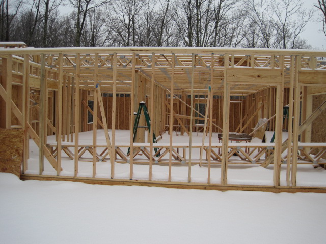

How much behind do you think the upcoming snow storm will slow down progress? Looks like a solid 12 inches plus for you folks.
What? I'm enjoying nice blue skies today. :D
Hmm, just took a look at the forecast and yeah, it looks like we might be in for some of that white stuff on Wednesday. I hope the forecast changes before then. I don't think 12 inches of snow on that sub floor would be the best thing for it. :( I'd like to think the builder plans to shovel the snow off the exposed wood. Back filling is supposed to take place Wednesday, but that will likely not happen if we do get a snow storm.
Trusses are supposed to be delivered and set this Friday. Hopefully that can still happen, even if we do get snow mid week. Keeping my fingers crossed that the forecast changes. I love snow, but if only it would wait until the house is sealed from the elements!

Pete, you might want to consider calling the contractor in advance and see what his plan is for snow. Unless you say something, there's a better than even chance he'll just let the snow sit on your floors.
See below for my experience with snow on the subfloors. During the bid process, I asked the contractor what he would do if we got snow on the subfloors. He said he would shovel off the snow. Then when we got snow on a Friday night, I called the contractor. He told me that he doesn't work weekends. Guess who shovelled the snow? You got it; I did. Fortunately, the Advantek subfloors we used seemed to handle the wetness well.
I'm going to be sore tomorrow. My back is already extremely tired. I shovelled snow off of 2/3 of our subfloor until I tuckered out about at about 4:30 PM. The main floor is 2100 square feet. Man that's a lot of snow. Thursday I borrowed a snow shovel from my father-in-law in anticipation of the forecasted snow.
While shovelling the snow this morning, it became painfully obvious that the snow shovel by itself was not adequate for this size job. It's too bad I couldn't figure out some way to use the tractor. So I got a sheet of OSB and used it as a giant scraper. This device helped alot but it was still slow going and back-breaking work. Plus, I couldn't just push the snow out of the house. I would first use the OSB sheet to push the snow into a pile by a window. I then had to throw the snow out the window shovel full by shovel full. The snow was very wet and extremely heavy. By the end of the day, the wet snow was sticking/freezing to the shovel and was making it hard to throw the snow through the window.
I'm not sure that I've got it in me to shovel the remaining 700 SF tomorrow.
Obed
I'm tired of snow. I had to remove the snow from the attic this afternoon. After having cleared over half the snow off the attic, the framer's son arrived and helped me clear the rest of the attic. I used the 3'X5' piece of OSB again as a giant scraper. This time it was easier because I didn't have to shovel the snow through windows like I had to for the main floor several days ago. I was able to just push a lot of the snow right over the side. However, most of the attic has a 2x6 plate on top of the subfloor at the edges for attaching the rafters. So I had to push the snow over to the garage where the 2x6s had not yet been installed in order to be able to push the snow over the edge.

I had 3 different snows/rains with my floor holding about 3" of slush at one point as i was shoveling it off myself as I didnt hear from the builder for about 2 weeks on my barn project.
the next day after I shoveled off 2 or 3" it turned to rain as seen here
after 2 days more of freezing nights warming up to rain next days floor looked like this
It did turn out a bit better after a while I ended up having to scrape off loose fibers
wide area shot
weather can be really damaging and something to be aware of so best of luck.

Yikes, I sure hope this storm is a false alarm, I would have for mom's floor to end up looking like the pictures above!
I wonder if putting down tarps would be of any benefit? I have about a dozen of them ranging in size from 10x20 to 20x40. Not sure how effective they would be with the interior walls up...
Pete,
I would discuss any things you would like to do at the site with the contractor before doing it.
He may have even been going to use some of the scraps for blocking.
Perhaps, since the interior walls are up you could convince him to bridge the tops by laying some 2 x 4, 6 whatever is there and putting your tarps on them. Then put a few on top of the tarps to hold them down or even use some of the nails with the plastic washers on them. Watch for snow loading though; you don't want the walls to rack.
My house roof was 75% covered with tarps from the end of may till Oct because a storm took most of the shingles off.
No leaks during that time, but no rain either. Snow on flat tarps might be another matter.
Let them do the back filling, in any case, Even contractors buckle walls sometimes. Look at Motor Seven's Log cabin project if you want to see a messed up basement wall.
