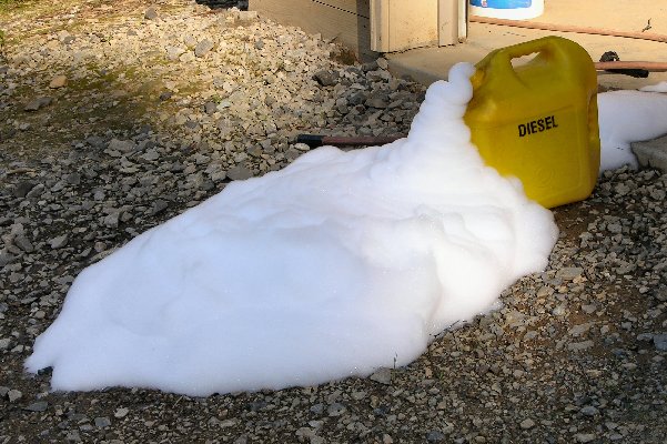

After lots of tests I've finally settled on using a common 5 gallon fuel carboy. They are cheap, hold a full 5 gallons of soap/water mix which will make a lot of foam and won't rust.
I'll most likely use two for the boom, one for the left side and one for the right. I have two miniature air solenoid valves that I'll be using to switch which side the air goes to which will also establish which side the foam will be generated from.
The foam that you see in the picture is being generated with only 2 psi of air and I went to a 6" aquarium air stone to make mucho bubbles the consistency of shaving cream. The bubbles are also pretty dry and last for hours before breaking down.

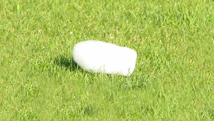

The foam marker is independent from the boom sprayer. That is it can be added to a sprayer that you may already own. The foam generator is very simple to build compared to the boom sprayer itself.
I also think most of the projects seen here at the TBN site are made by members because working with their hands gives them great satisfaction, especially when the project works as intended, and that my friend you can't put a value on.
BTW: This picture is of a foam blob that I put on the grass over 12 hours ago. This foam is easy to see and lasts a loooong time.

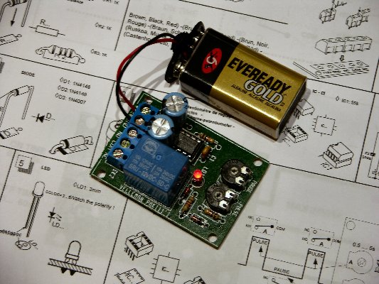

Tonight we finished up the PMK111 solid state timer. I did substitute the original trim pots with 250K units & also substituted both electrolytic caps for 220 mfd units to give the timer a wider timing span.
This timer is relatively inexpensive, ($9.95 in kit form) works well, and is available from www.allelectronics.com on-line.
The timer is normally powered by the tractors 12 volt system but here I am using a 9 volt battery for testing and adjusting purposes. the PC board will eventually be housed in a small project box.
Keep in mind that a timer is an option. The foam marker can just as easily be controlled with a simple on/off switch or foot switch if you so desire to keep it simple.
