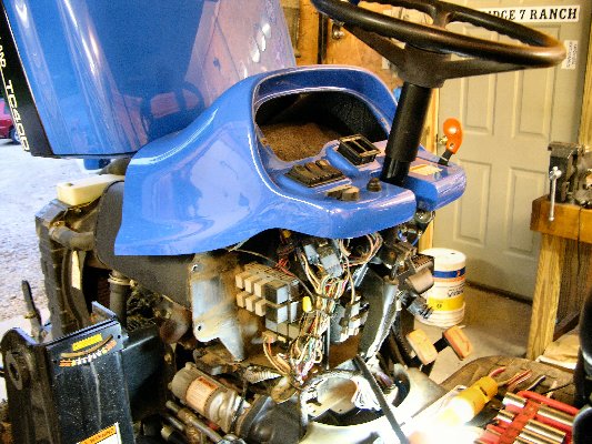

Yup, we finally finished up the wiring of our project this afternoon. (thank god) :D

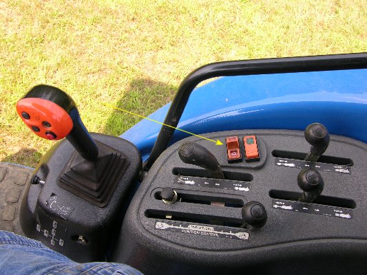

The 1st picture shows the 3 conductor wire that was pulled to the right fender control area. This wire was connected to a two position Carling waterproof spdt switch that controls the foam output between the left and right side of the boom.

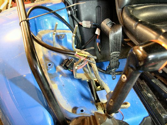

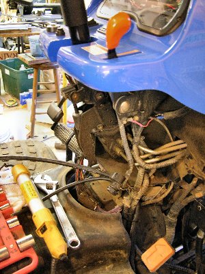

The second and 3rd pictures show the wires pulled (7 conductor from sprayer & 3 conductor from left/right right fender) to a point under the instrument cluster where it was all fused, connected, and insulated properly. While I had the lower cowling apart I also troubleshooted the glow-plug timer module since the instrument cluster light was intermittently winking at me from time to time. As it turns out I have a bad 60 dollar timer that I'll need to replace before winter rolls around. But for the time being I just pulled the timer out of the circuit.

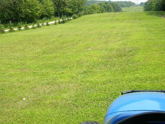

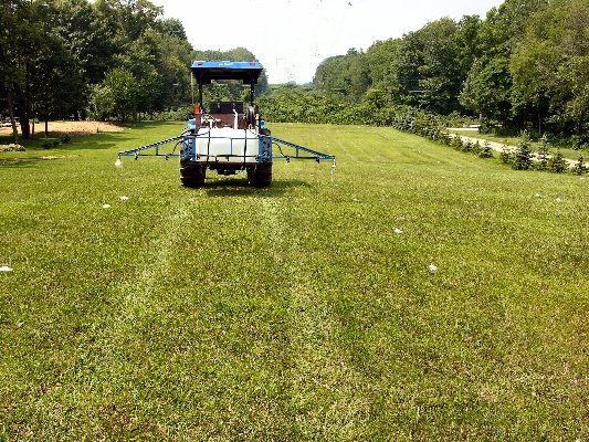

Fourth & 5th pictures show the now completed rig spraying and laying down foam balls. I started doing a bit of experimenting and used an inverted funnel covered with a ladies hose on one side of the boom and the end of a plastic watering can covered with a ladies hose on the other side of the boom. The watering can end wins in my book as it puts down grapefruit sized balls of foam that stick to the grass and are very easy to see from a distance. I'll be putting one on each side of the boom now.

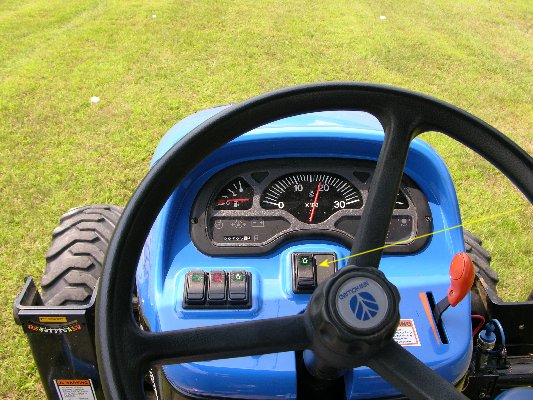

6th picture shows where I mounted the switch to control the spray rig. 1st position is off, second position is automatic timed operation of air compressor and 3rd position is manual run or purge for initial startup.
7th picture shows the new waterproof SPDT Carling switch that controls the foam to the left/right side of the boom. I never used the original rabbit/turtle switch that was mounted here since there is another on the joystick, so I installed the new switch then pulled the paddle handle off the original switch and installed it on the new switch. It looks stock and the paddle is much easier to find with my finger when I need to reverse the foam output.

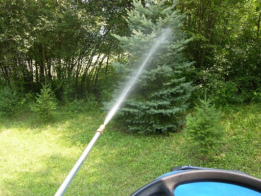

8th picture shows the gun in operation from the tractor seat giving the pine trees a drink of much needed water.

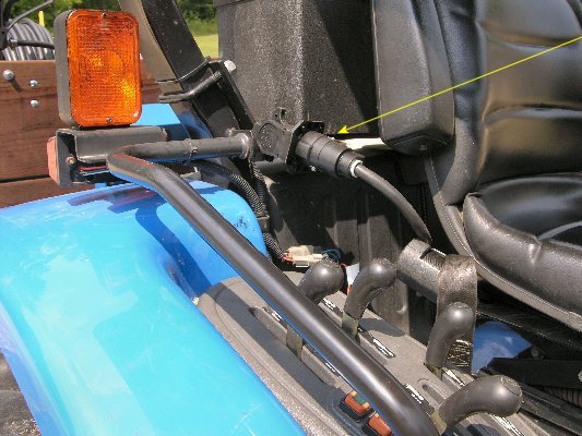

Last picture shows the RV plug/receptacle that I used. When the sprayer is no longer connected I tuck the receptacle behind the seat.
I ran roughly 150 gallons of water through the sprayer today to test it and in that time used a total of 2 gallons of diluted foam solution so the foam concentrate should go a long, long way.
