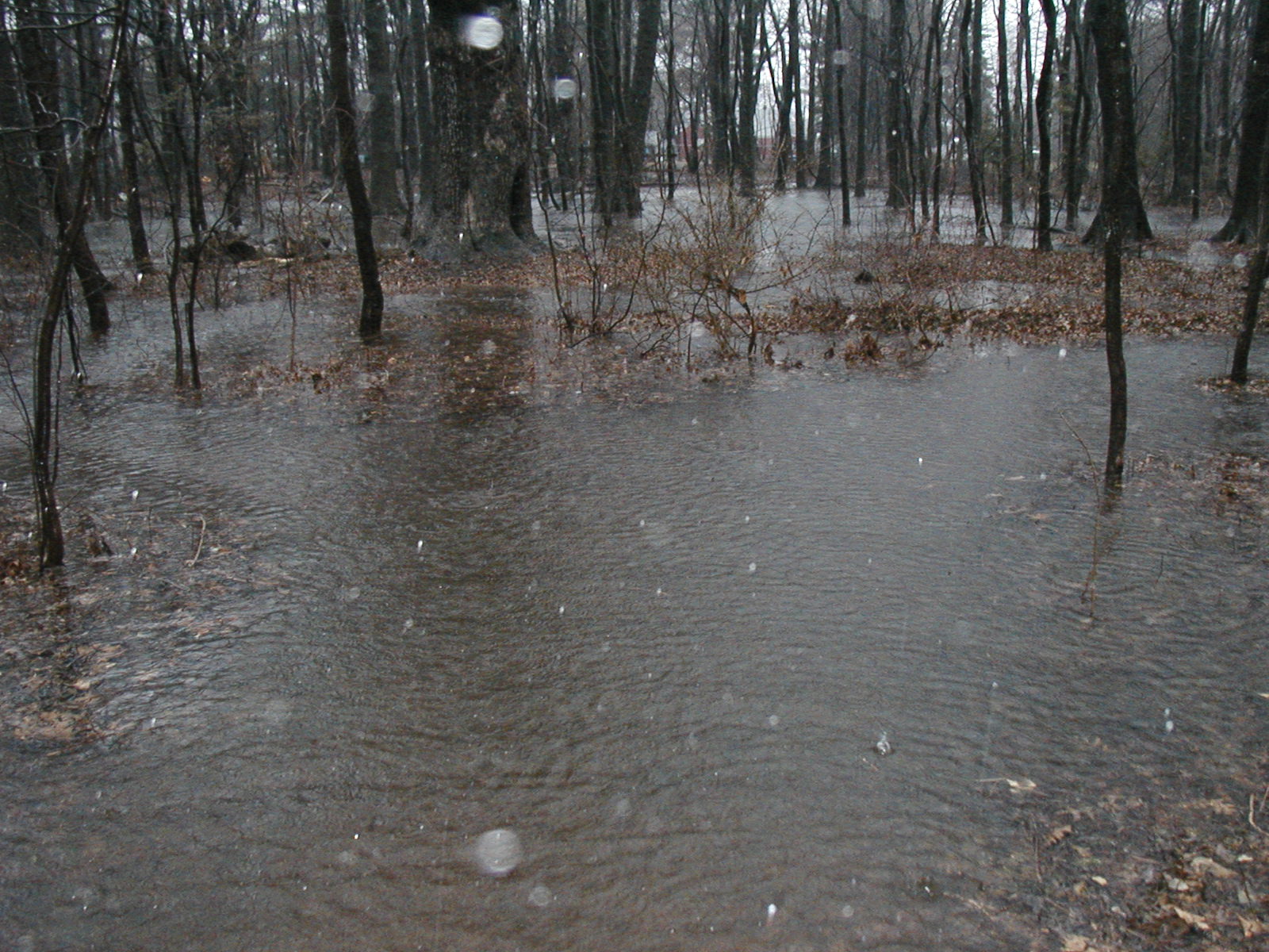

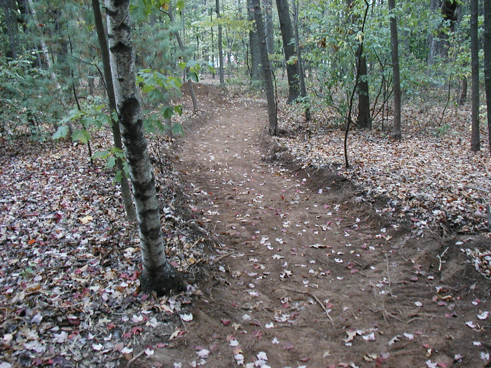

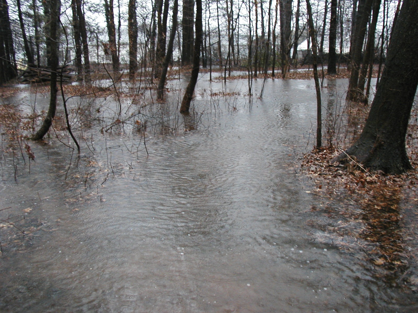

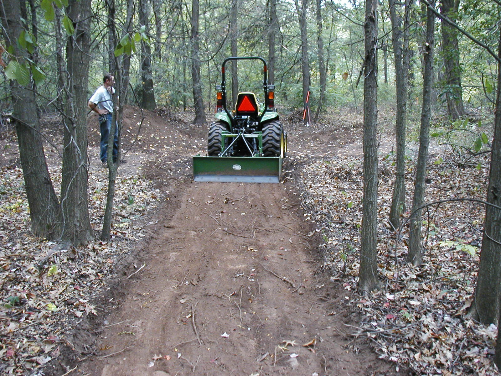

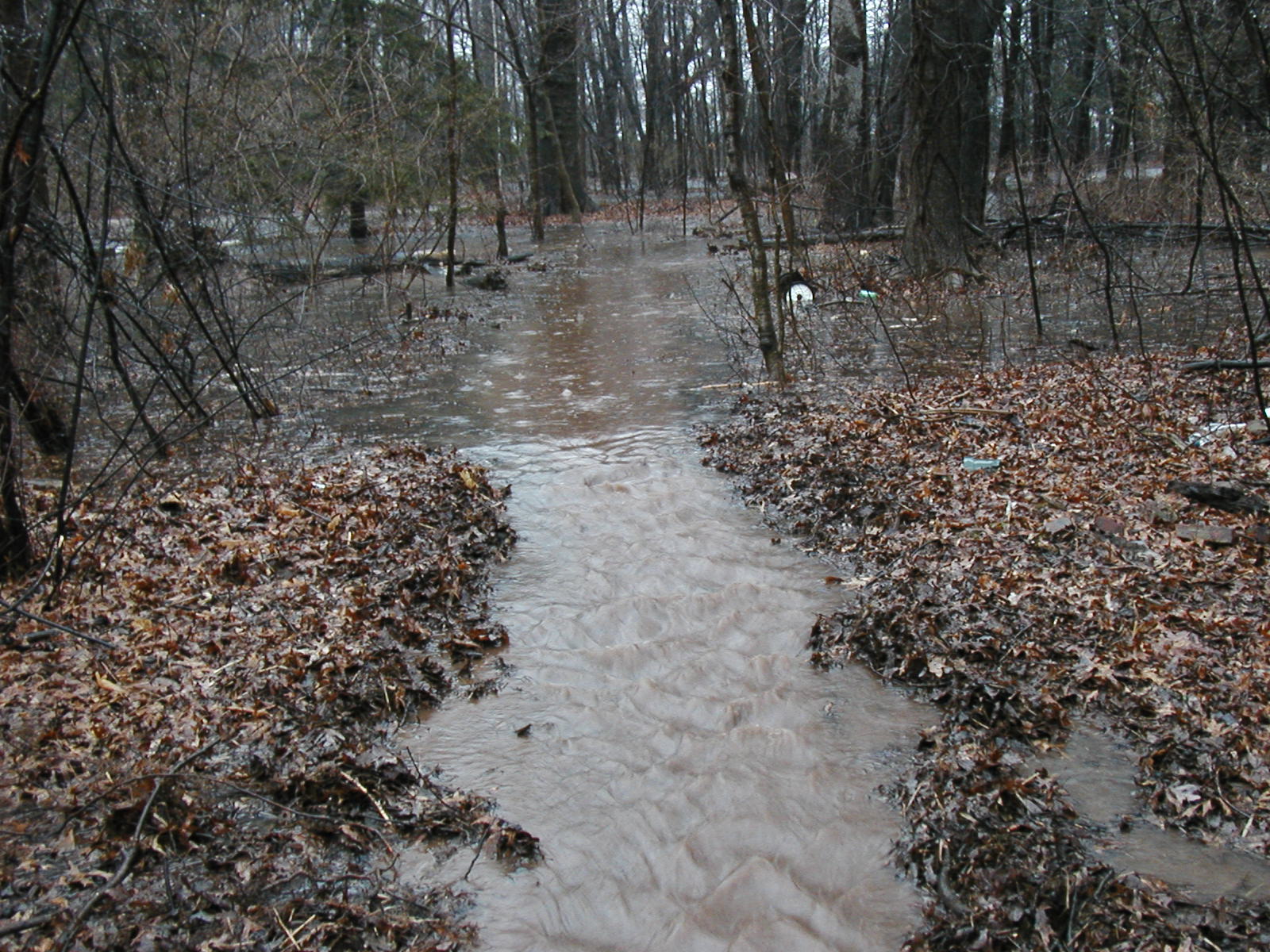

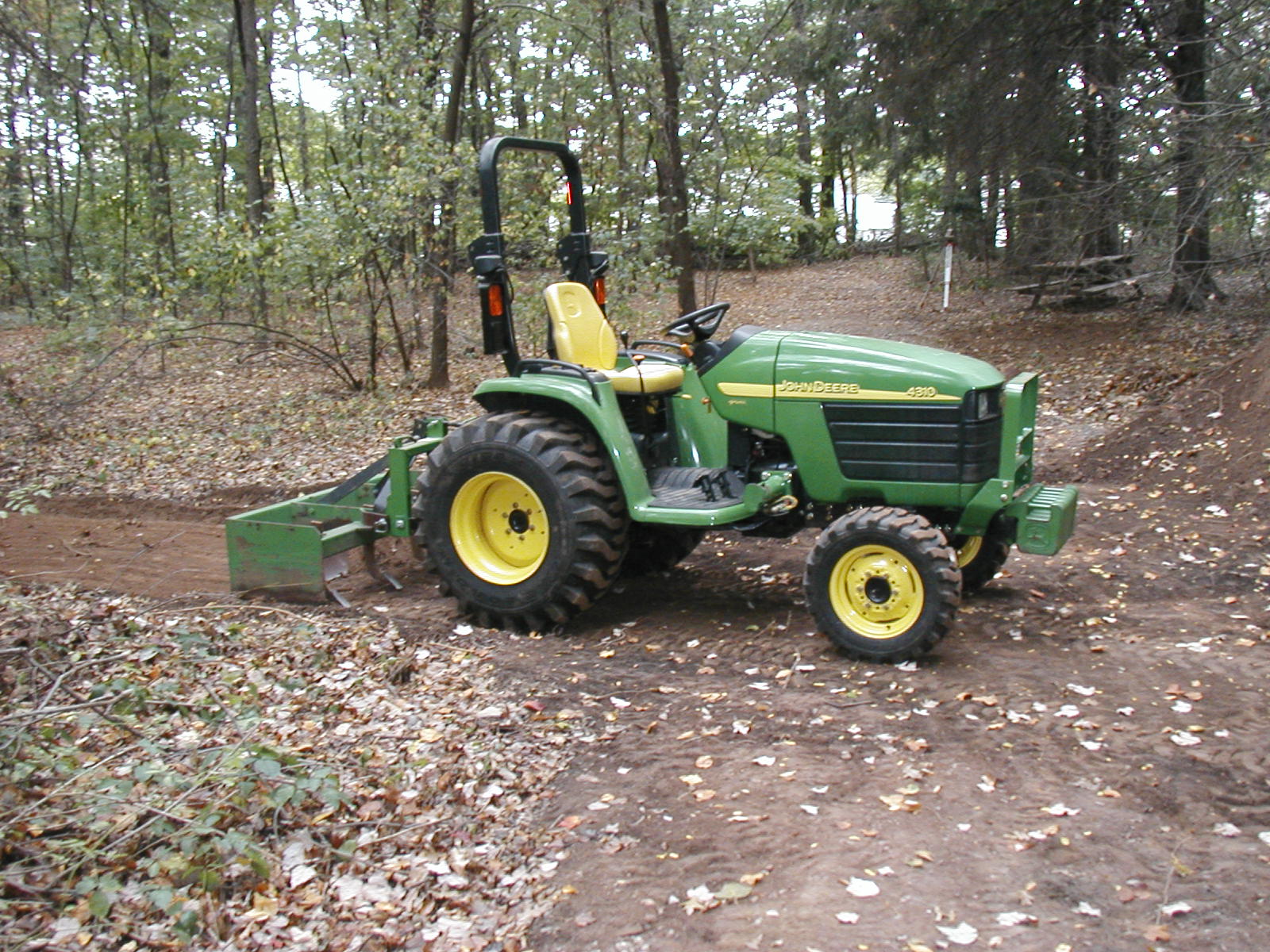

A couple of pics showing an extreme event, fixed much of this by cutting a swale with the box blade
