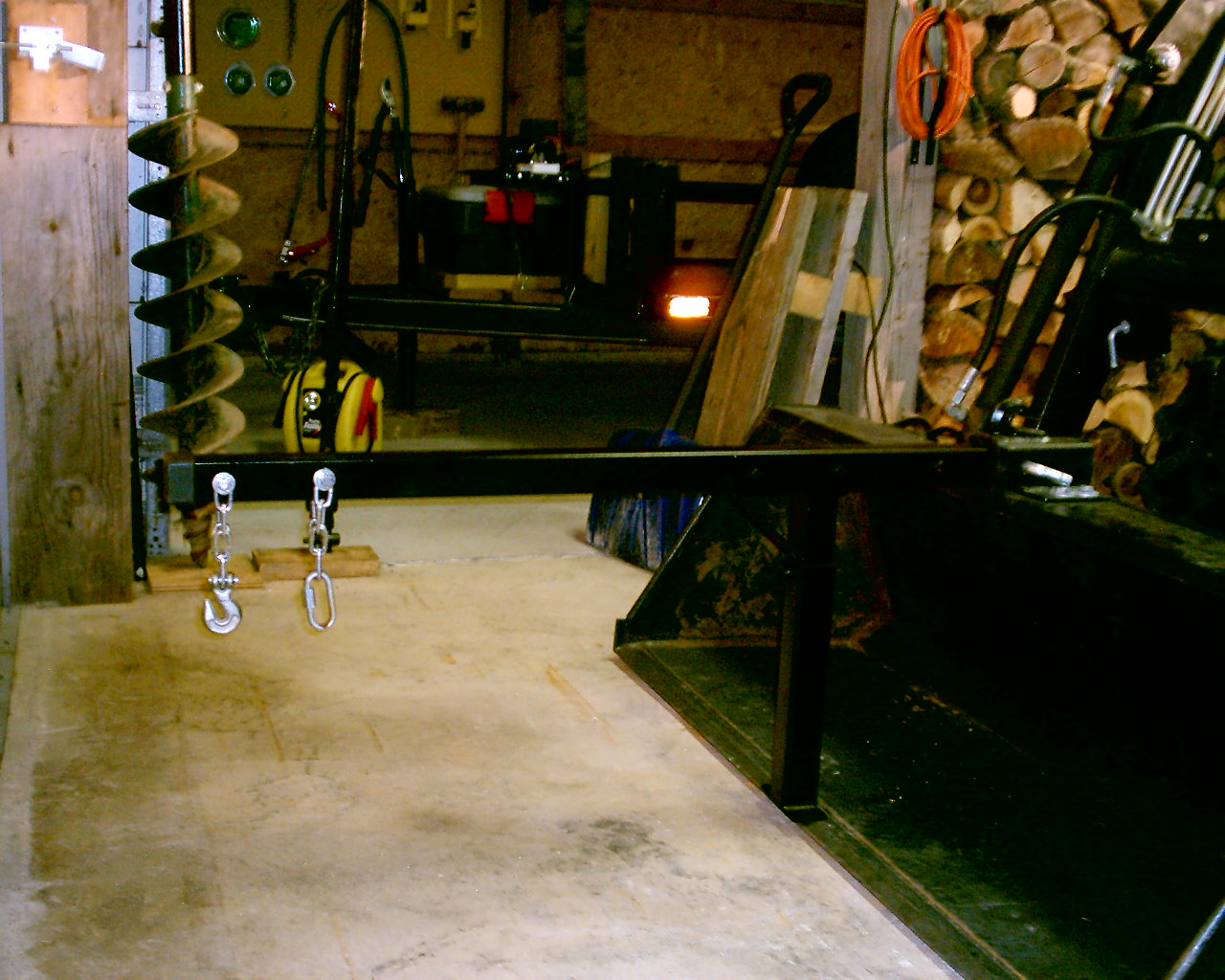

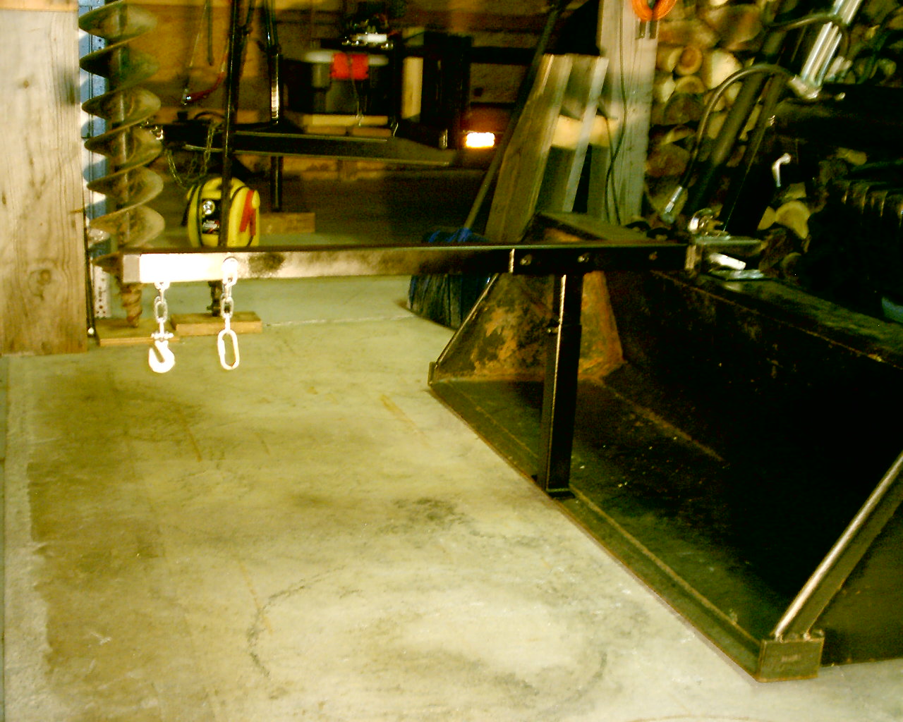

On a much smaller scale I built one after I tried to get a Bush Hog off my trailer and learned how limited the reach of my tractor was. I utilized the hitch I mounted to the top of my bucket.
Chris

The bucket on my 2615 is probably 3/16" ... if that. It is more a function of how you use it than how heavy it is built. If you put a bale spear on the FEL bucket, mount it so the weight is spread out across the cutting edge, and cantilevered off the top edge. This changes the weight distribution and reduces bending. A lot of people have fabricated plate mounts for their attachments. Build a plate for the ram arms, and weld clips and clamps onto each impliment. These plates are built heavy, and designed to unlatch from the existing attachment, set it down, back out, drive under the new one, lift it up, get off and latch...
Your 3 pt probably has more lifting ability, but not the height or ease of maneuverability of a front mount. It will not stress the tractor as much either.. If you make a set of spears that mount on the outside edges of the bucket, that is the strongest point, and you can design the bucket like a mahindra's with the top edge bent down 90 degrees. build em so you put the top in first, behind the top edge, slide in the bottom clip over the cutting edge, and put a bolt through a angle iron clip and hole on the side wall.
