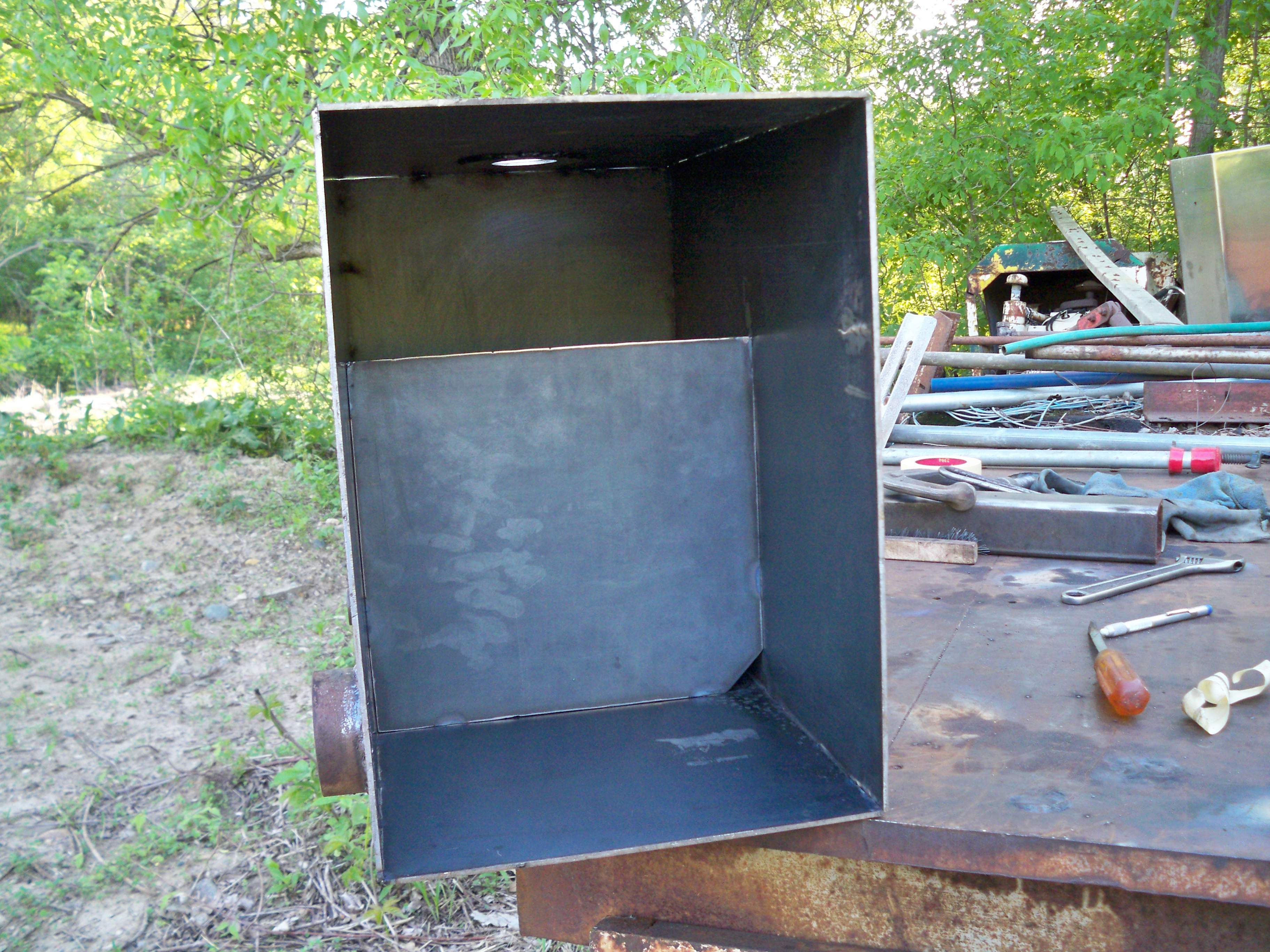

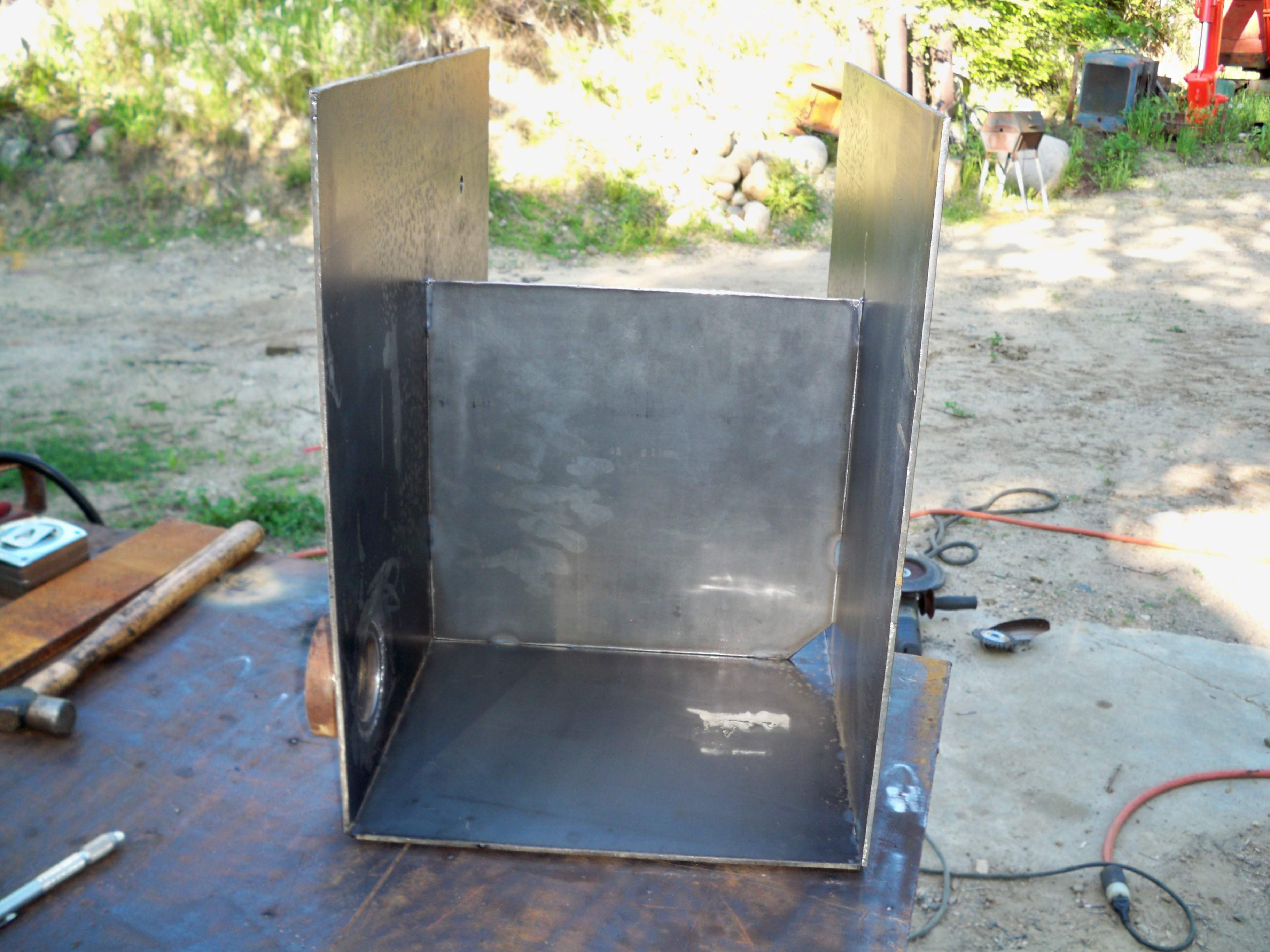

I needed a hydraulic tank of a specific size so I built one for my hydraulic unit. The tank completely filled will hold 17 gallons, I keep it at 15 gallons. The tank holds a little over a gallon per inch. The first picture shows another tank where the pieces were cut out of. That truck that tank was on was scrapped out a year earlier. It would have been nice to have had the pieces sheared from new sheet metal. The pieces would have been perfectly square then. They are pretty close now. The sheet metal is ten gauge.
Tank with two sides and bottom with baffle welded together. The baffle is so the return oil can not just return on one end of the tank and go pretty much directly to the supply port.
tank tacked together without last side

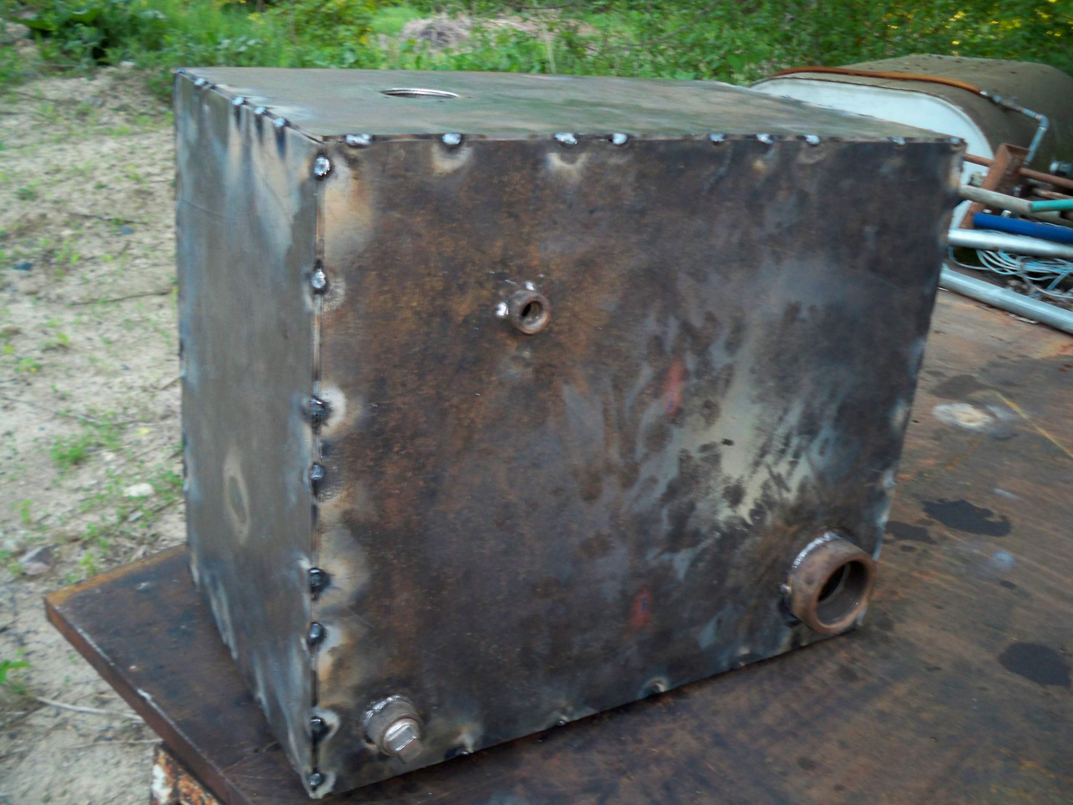

Tank completely tacked together so corner welds can be made without filler rod. Tank was oxygen/acetylene gas welded together. The arc weld tacks were burnt into the weld as the corners were fused together without filler rod. Had to add a little filler rod once in a while when the bottom of corner had a little gap. After tank was completely welded together I had to vacuum out the tank. Tank had weld splatter inside it. The inlet and outlet ports were welded with 3/32 7018.

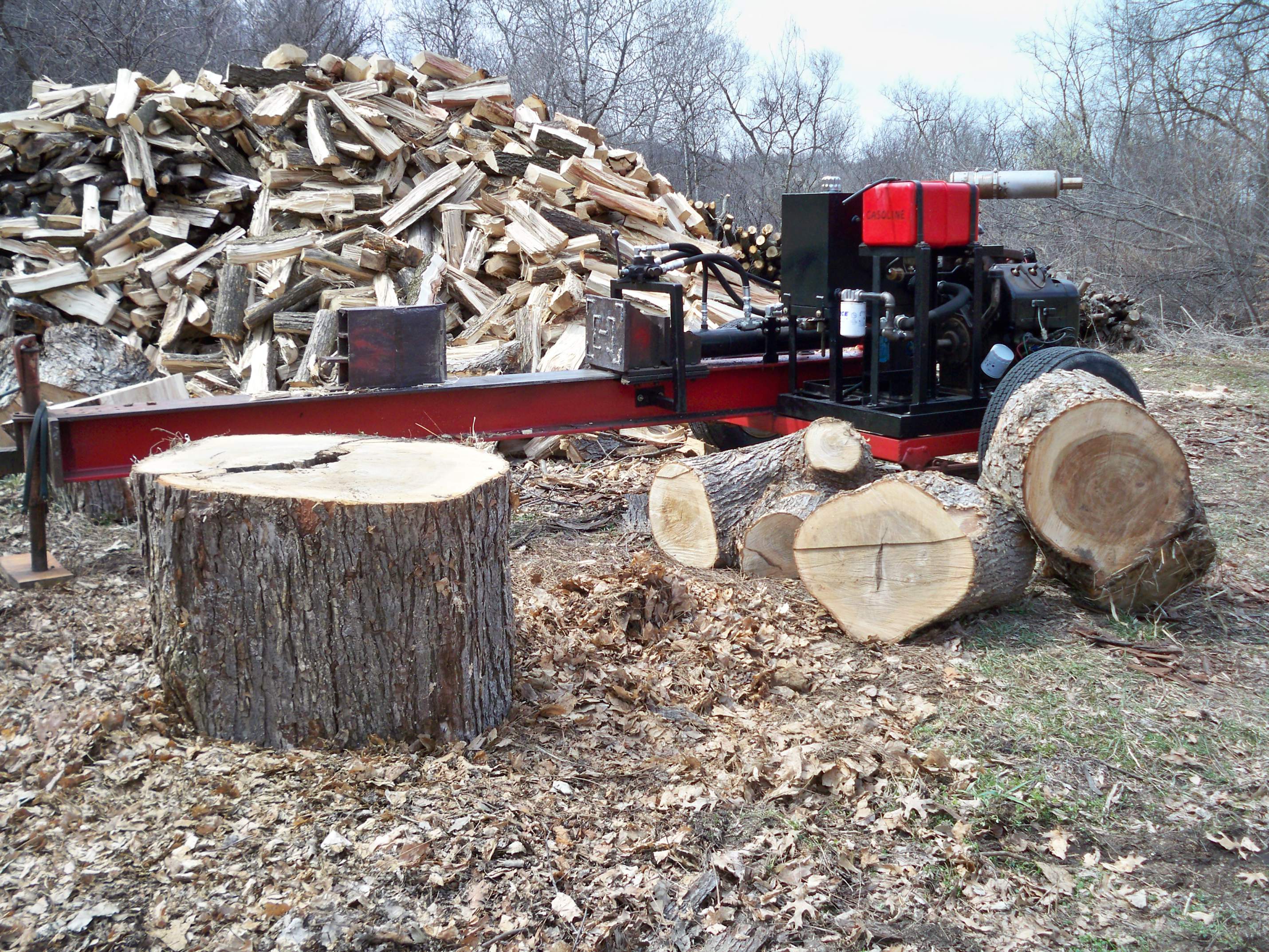

Tank on the wood splitter. I completely rebuilt the Hydraulic unit. Another engine, the old engine was crank start, sure is nice to have a starter motor. New hydraulic pump, all new hoses. The only thing from the old machine was the frame and cylinder and Valve and the parts on the beam.

I'm fairly new to welding. But I think I would have sanded / ground off all the mill scale on that steel. Especially what would be the inside of the tank!

At least it's not too late to sand/grind the outside before you weld. 10 ga is fairly forgiving.
Look at the pictures of the inside of that tank, it's all clean nice steel no rust or crud. I could have wiped it off then ate off it. pretty clean stuff.
I welded the tank without any sanding or grinding. The outside was power wire brushed before welding. I had made a plate to screw down to the top of the tank over the filler. With plugs in all the ports the tank was sand blasted before painting. Sand does not take off metal and does not leave scars.

Strange!:confused: Sure looks like a lot of mill scale to me.

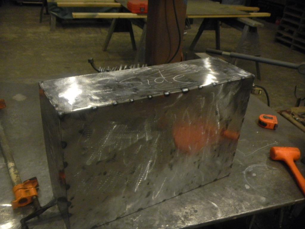

Here is the outside of a gas tank I built awhile back.

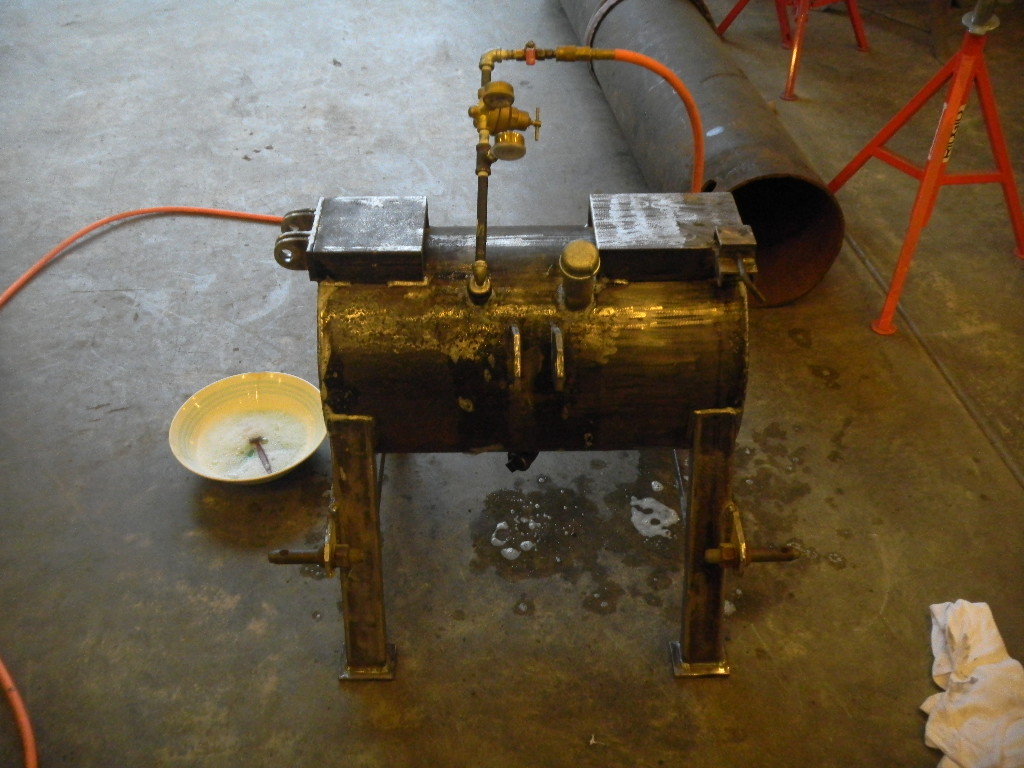

When I built a special 5 gal hyd tank I bought pickled and oiled steel. It has the mill scale removed. Of course when you weld the seams you create new scale in that area unless it's filled with inert gas. I used CO2. If the scale breaks loose it could chew up the pump etc.
Shield arc, I cut these pieces out of another hydraulic tank. The outside is kind of cruddy because of being out in the weather. The inside is spotless because it had hydraulic oil in it about a year before I cut my pieces out of it, no rust or crud. That hydraulic tank had no mill scale in the inside then so it should not have any now. The inside is clean.
I have seen a lot of hot rolled sheet metal that is covered in mill scale. I have seen other new sheet metal that is clean (shiny almost) no mill scale, not stainless either. Your gas tank looks like the stuff with no mill scale unless you cleaned it up real good. I saw your tank build, nice job.

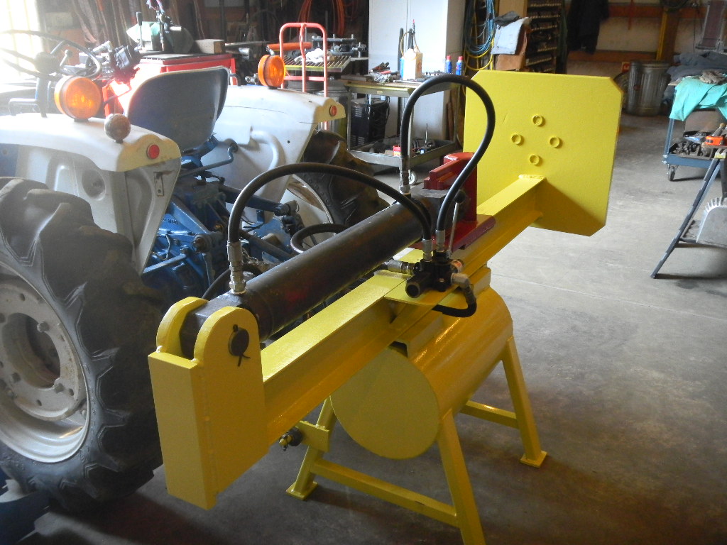

I built a log splitter for my brother-n-law a few years ago. I made the hydraulic tank out of some scrap pipe.
Shield arc you do do nice work when you build something. I do feel the beam is too light. Many years ago I saw pictures of beams about the size of yours bent like macaroni. These beams were from different manufactures that made some trial machines. I don't think they are building splitters now.
I got my idea from a guy that built his splitter and it had design flaws. He used an eight inch building column. So that is what I used. I have split some big ugly stuff that has twisted that beam. The beam always came back to original shape though, I think. The most ugly was a box elder crotch 24 inches in diameter or so. I am not sure if the heat benefit will be worth the effort on that one.I never thought Box elder would be that tough, for it is a junk wood, little BTU's in it. I feel that if I had a beam the size of yours and tried to split that same piece I would have twisted and bent it beyond repair. I have split other ugly ones similar to the box elder.
I built my splitter back in 1979 with limited tools and equipment, and also experience and wanted to spend as little as possible so it was sort of crude. My hydraulic tank was a 15 gallon oil barrel. I had a crank start Wisconsin engine. After 30 years of that I wanted to rebuild my original machine and make it easier to use. I upgraded to an electric start Wisconsin, a new hydraulic pump of the same manufacture. I needed to raise the hydraulic tank above the vane hydraulic pump. I made the tank fit the space I had to work with and put a filter in the tank so the oil going to the pump is filtered. I had a machinist machine parts for the pump alignment. I spent over a thousand rebuilding that splitter. For what I save on heating I can't complain though.

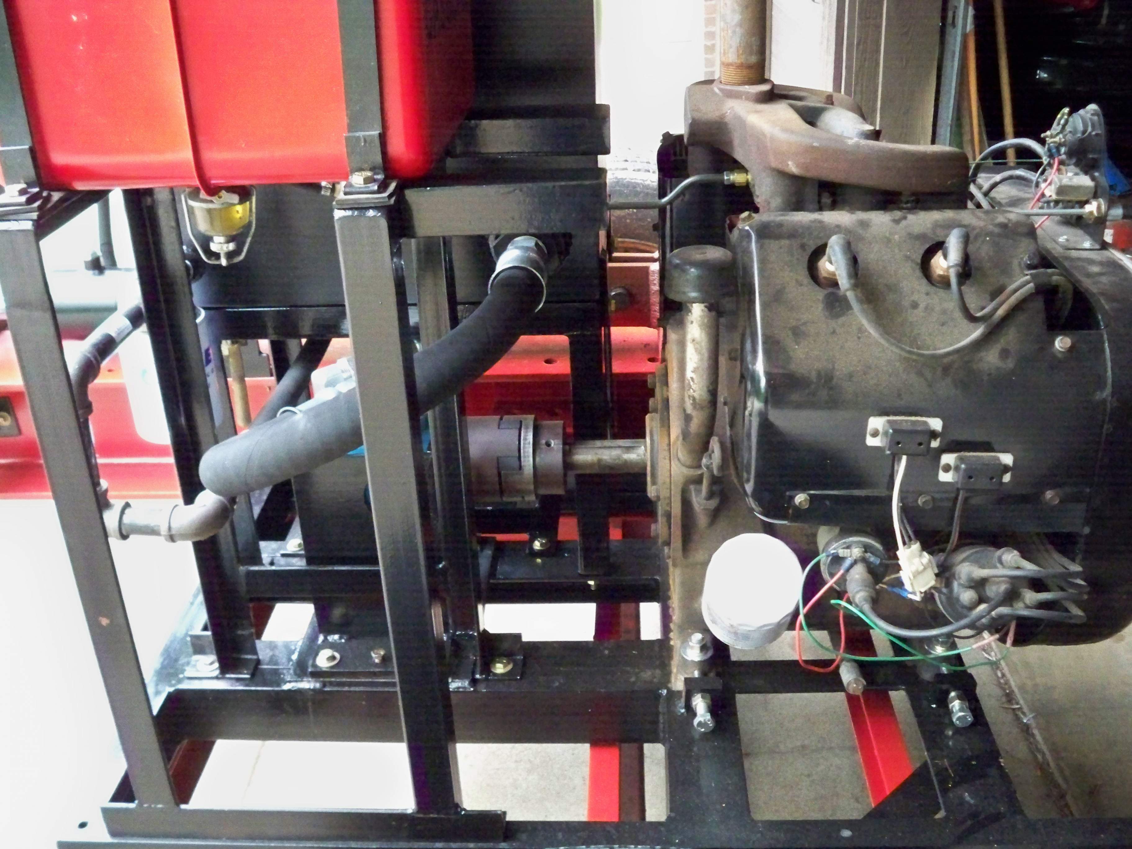

This pictures shows the pump alignment. The bolts in the base of the pump to making shimming possible, and the jack bolts at the engine base so it can be twisted. The engine had to be shimmed also because the engine base steel bent a little when it was welded. I still need to cut a piece of sheet metal and place it between the exhaust and the hydraulic tank. With 15 gallons of oil in the tank the oil will get to 150 degrees. A piece of sheet metal should cut that temperature down some, I think.

Looks nice! That engine looks like it will do some serious grunt! I agree with your heat shield idea as you would like to see the hydraulic temperature at about 125.
I would recommend a guard over your drive coupler, though.

I bought one of these to mount my pump with. Yea it cost $50, but it keeps the lovejoy hid and clean of dirt and sawdust, and it saves a ton of fabrication, time and labor, getting the pump shaft lined correctly with the engine. HYD PUMP MOUNT 8-16 HP GAS ENGINE TO SAE A FLANGE

While no scale is lots better than any, wouldn't the filter between the pump suction side and tank provide adequate protection?

I kind of thought I would get gigged on the coupling guard. I wanted to do that, but I kind of need a slip roller and I don't have one. Another reason I wanted a guard is it would look more professionally built. If I can find a slip roller I will finish it. Where I used to work we had an almost complete antique sheet metal shop and there we had a slip roller. That facility was demolished so it is no longer available. When ever the machine is used I am the only one around so that should not be a problem for now.
