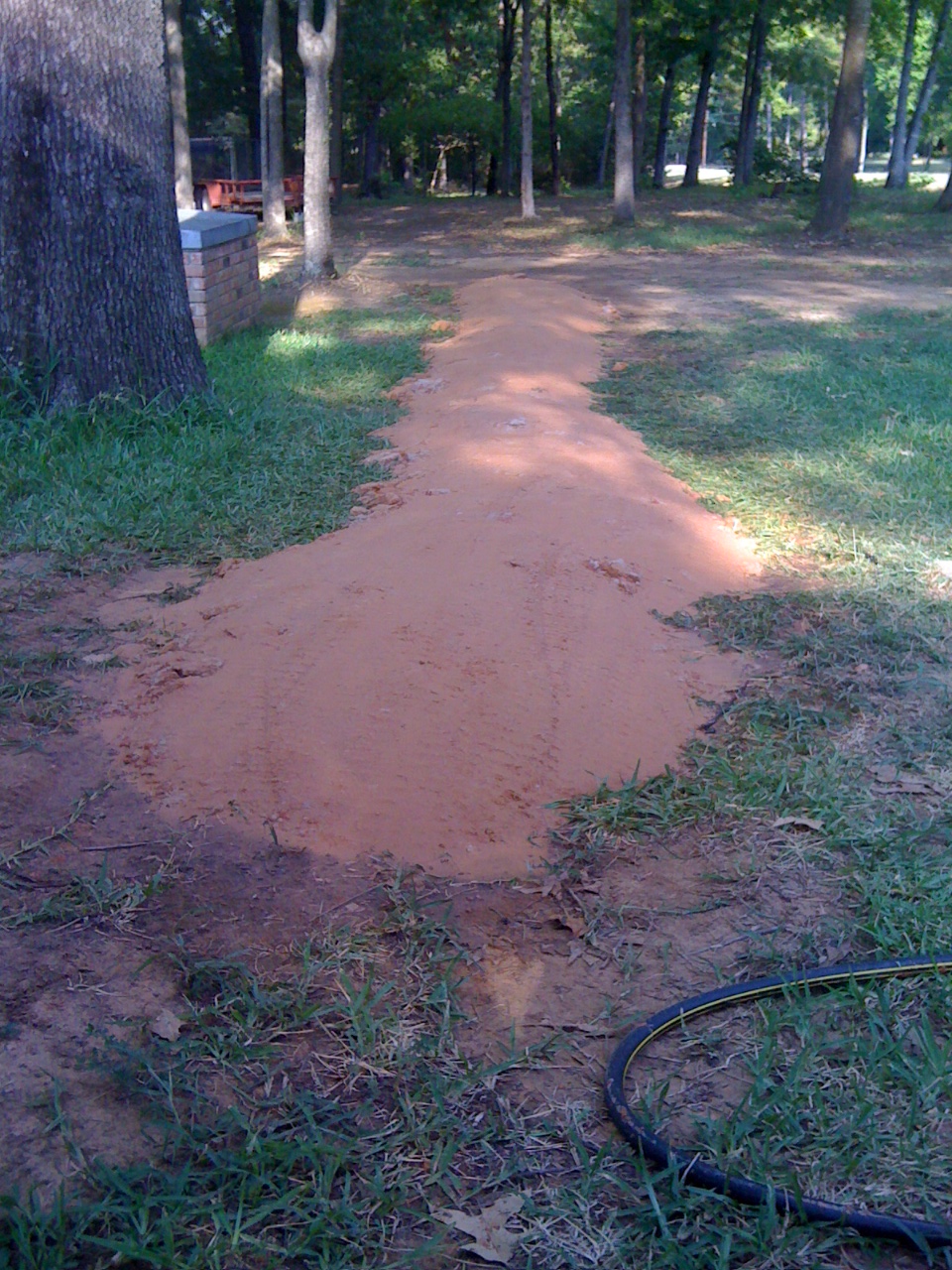

my neighbors are looking at me like Noah's neighbors probably looked at him. not that i've had any rainwater to contribute to the soil erosion that has been occurring for the last few years, but i thought if i built it...it would rain. i am forming a small berm to divert water that has been causing erosion near my house (when it used to rain). the great thing about it being so dry is the ease of which it is to move the clay(powder) with the FEL and then lightly water it after packing it down. don't think i'll even worry about topsoil/grass until it rains and see how it works. The great thing about owning a tractor is i can take my time since i own the equipment needed to move/modify the berm. (that's what i told my wife) this is a pic after the first evening working it. bout an hour...however, with wheelbarrow and shovel and location of my dumped clay; would have taken about 5 hrs for just this section.

Just a suggestion as i have installed many swales/berms over the years. How much rain do you get runoff wise? That berm you have looks like it could take a small creek flow. For the purpose of athestics you could severely reduce your slope angle. A 6 inch rise over 4 feet is usually more than addequate. I would akso get some grass in just to stabilize the area. Now on the other hand if you get a TON of water flow or just arent concerned with the look of the hill the by all means ignore everything I just said.;)
/ building me a berm
@ aresenix: yes...a neighbor and i were discussing the same thing. I am uncertain how high the water level would become in a large rain. it is an eyesore at this time but i did let my neighbors know that once i see how it performs after a decent rainfall, i will modify it. (either decrease height of it...and at that time cover it with some topsoil and sod it).
i am glad you think it looks like it will divert a substantial amount of water...there is a large volume of it that takes this path. the clay was spread (dried) small layers at a time; packed; watered; and then repeated over and over. i ran a couple of hoses after this pic down the right side of it and it performed just as planned. once water gets to the end, it continues to spread out instead of taking a hard left into my yard and forming a creek.
i love the fact that if it is too high after seeing a good rain, my BX is avail (another excuse to do some more dirt work). this forum is great for feedback and i need all the help i can get. thank goodness for digital pics and internet.

Living in the hills, erosion is a never ending fight. I am sure you have thought about it, but preventing erosion in one area is going to cause it in another and depending on how you divert it, it may be even worse in that area.
@jeff: I didnt touch a shovel. My 8y/o son was playing in it. I bought a $14000 shovel. Lol
@tripleR: u r right. The path I have diverted it to at this point allows the watershed to spread out (at the end of the berm) instead of forming a 2 foot wide, fast-flowing creek if it went left. And, yes...this yard will b a lifelong project

got an update...first of all...WE GOT SOME RAIN!!! got about 2 inches in one hour. i posted some pics of the berm in action. the first one shows the water going forward down the hill towards the shed (where i wanted it to go). The second pic shows that the water is no longer going in front of and behind the well house which was taking some of my back yard with it. i am pleased with how it did.
now, what is the best way to prepare this berm for either sod or seed? it is majorly packed clay.
