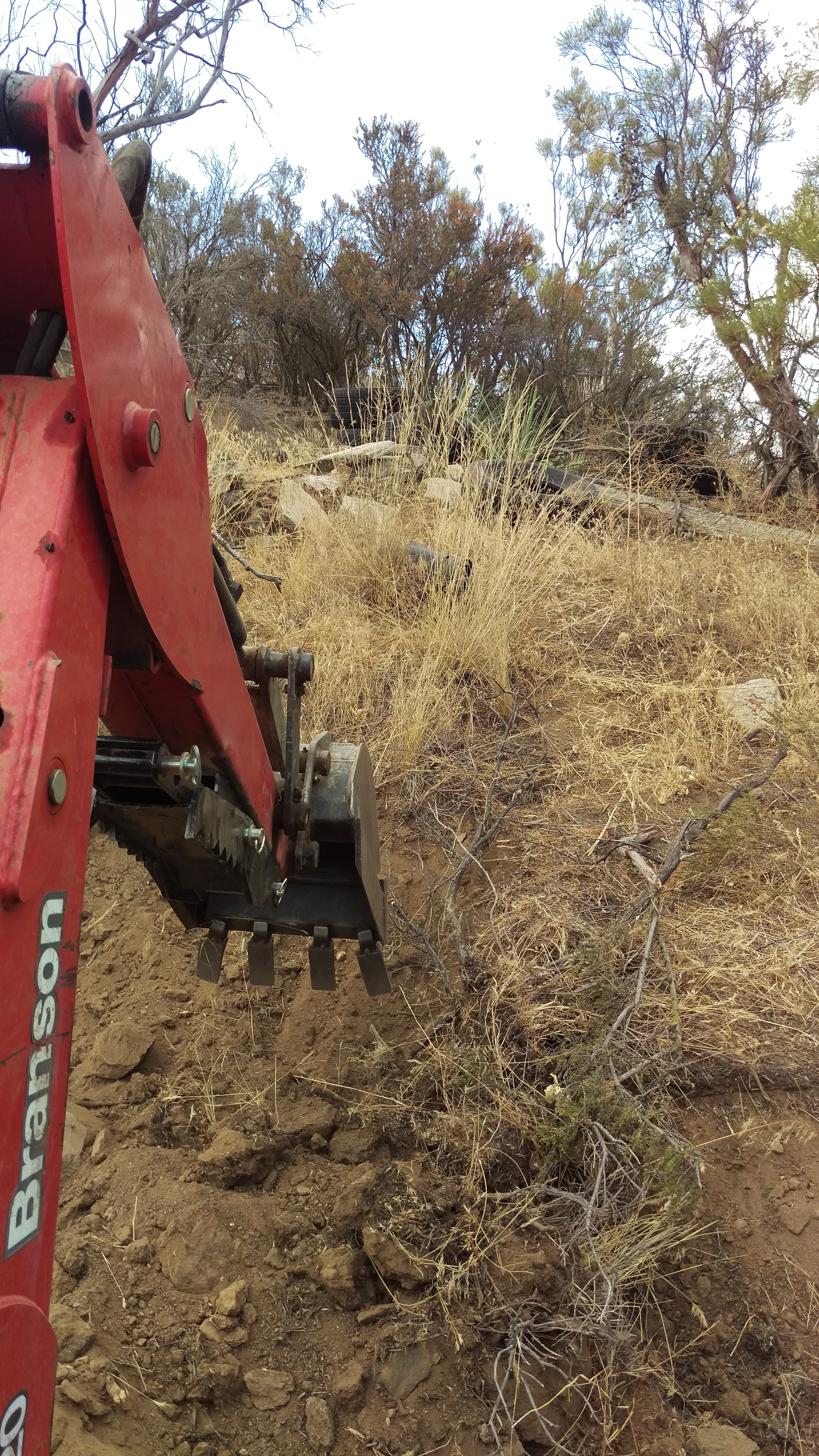

Prepping for water storage tank
Had a chance to try out the new backhoe thumb while I cut access to the water storage tank pad that's on the hill. Very please with adding the thumb, super useful! As I worked my way up the hill I'd grab rocks and trees, move them out of the way, cut with the hoe, then back drag, rinse, and repeat. This would have been a great task for the 36" bucket but I was too lazy to swap it out, so I just used the 18".
Found a 2650 gallon tank for $1200 that I will install shortly, then I can use the water buffalo to fill and maintain it and start on digging my water lines. Slowly but surely, coming along!

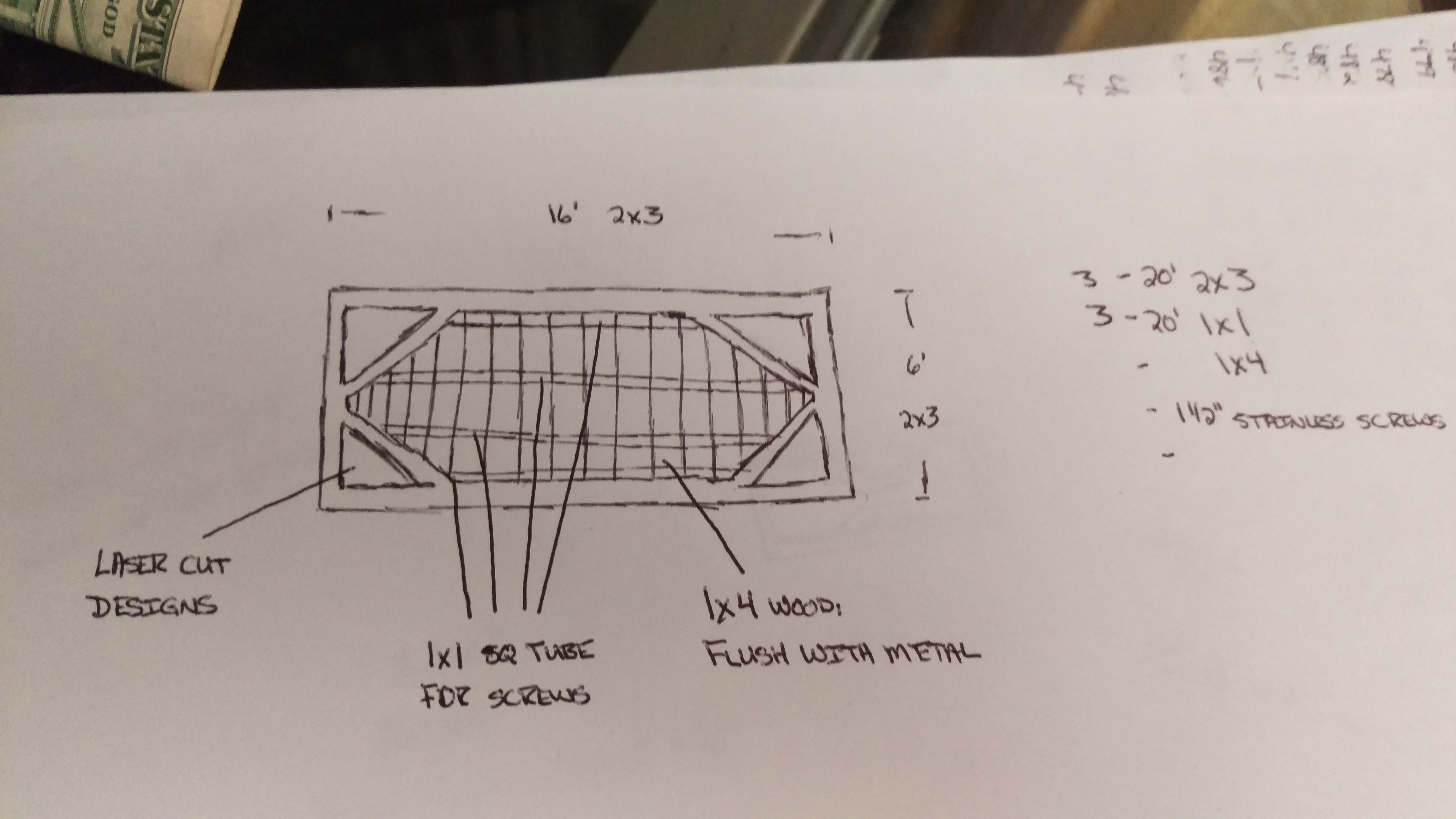

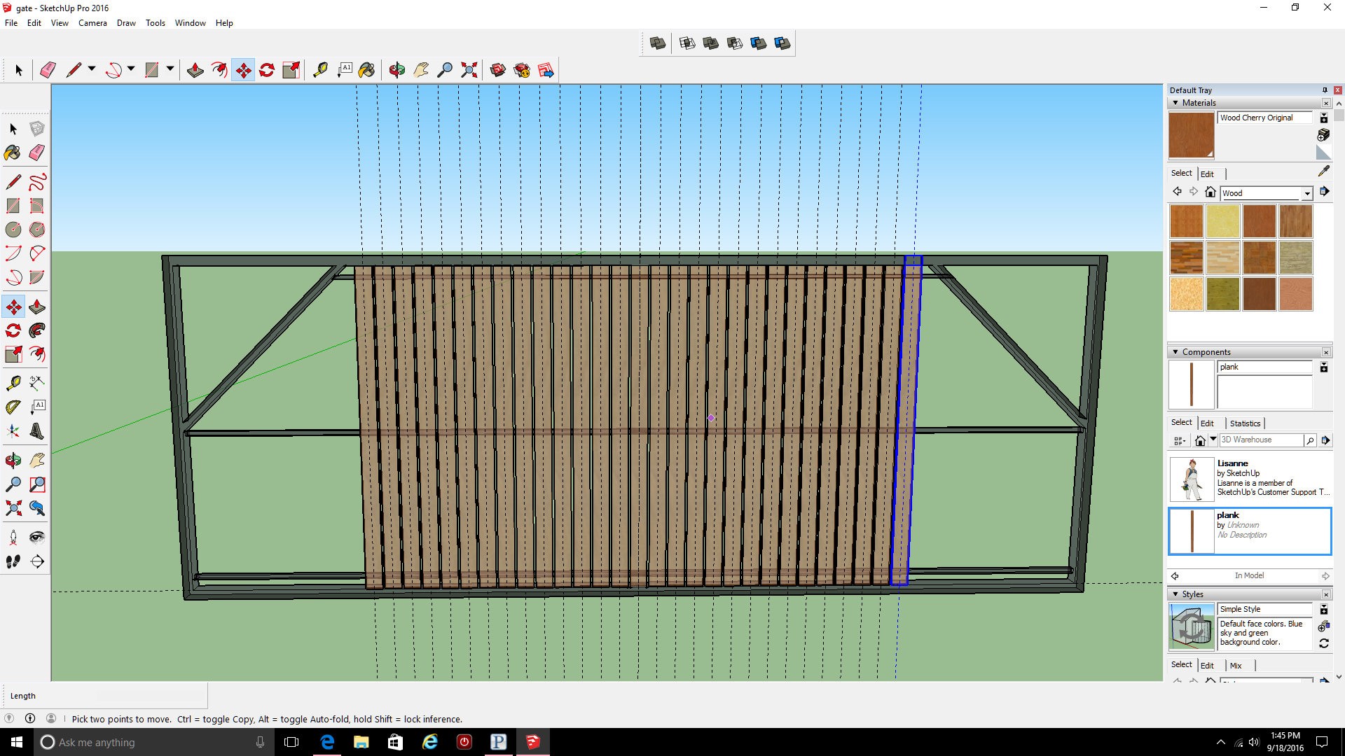

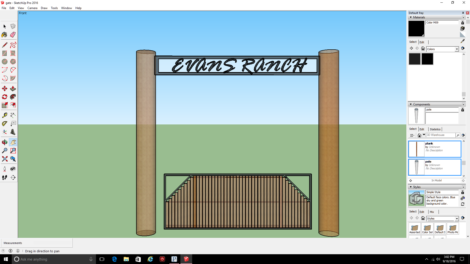

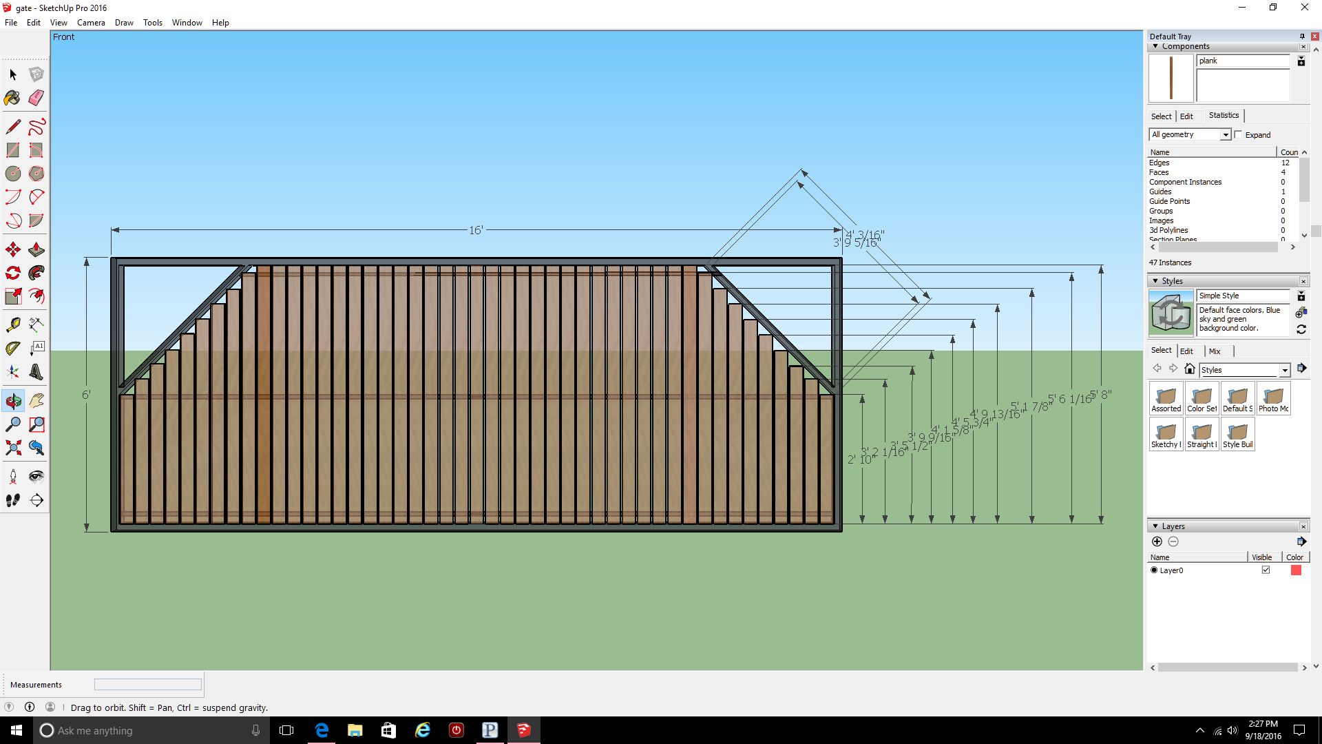

Building the gate
Been thinking about building my gate for a few weeks now, and its time. So spent some time 3D modeling the gate I wish to build. Keeping it simple but I think it will look great.
Other than that, just been trenching water and prepping for the house remodel. More pics and info later!
