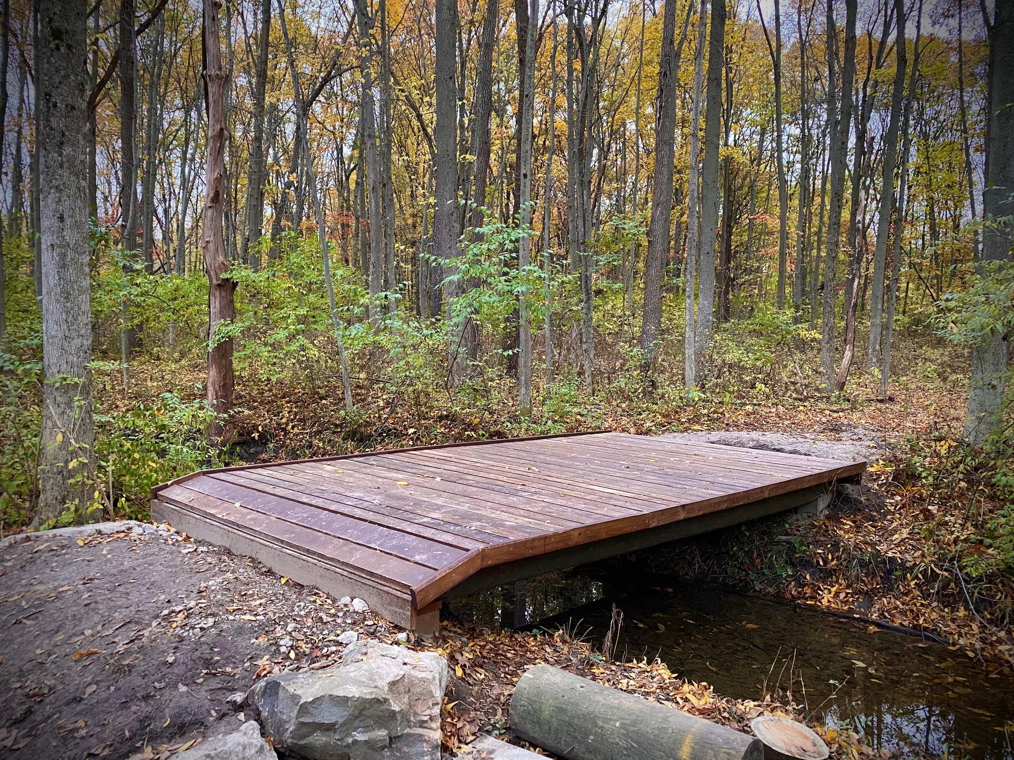

Starting the Decking
Decking the bridge was definitely a satisfying project in and of itself, but also rather time consuming.
I decided I would need to double-up the treated 2x6s for sufficient strength between the telephone poles (outer poles are right at 7' apart from each other, with the middle one close to the middle. Thus approx a 42" span between poles).
Instead of fastening the bottom layer to the poles first, and then following with the top layer, I decided to make my doubled-up deck assemblies beforehand. This way I could do it up at my workshop, select the board matching more carefully, and get deck screws into each assembly from both sides. My father in law is quite paranoid that my boards will hold water in between them and rot that much faster. He's probably right, but I needed the strength and didn't want to buy a ton of lumber to do it any other way. I'm less worried about retained water leading to premature rot than I am about carpenter ants. They found some of my boards as I stored them under tarps all summer long, and completely ate the guts out of a few of them. Voracious bast@rds.
Since the height of the deck above the dirt was so great, I decided to cut a slant on the front side for a short ramp. I'll still need one heck of a dirt & gravel ramp to get up there smoothly.
The ones that look like single layer 2x6s are still doubled, was just making use of some of the 8' long pieces I had for the bottom layer. Total bridge deck width is 112", or 9'4". Plenty wide and comfortable for my tractor, but may require some cautious driving in my truck.
At this point I simply could not resist a tractor weight test. If my design was not strong enough, I'd rather find out sooner than later. So I jammed her up there..... pretty nerve racking the first time, but it was a success! Really no bouncing or flexing detected at all. But with an all wood design, it will probably fail in a brittle and sudden fashion, it it ever comes to that. :eek:
Took me until the following weekend before I could finish the decking completely and drive all the way across. Carrying the fill dirt loads across to finish the far-side approach meant I was carrying an extra 800 lbs or so on the front axle/tires (or more, if you think about it unloading the rear end partially and transferring weight to the front too).
Money shot:
