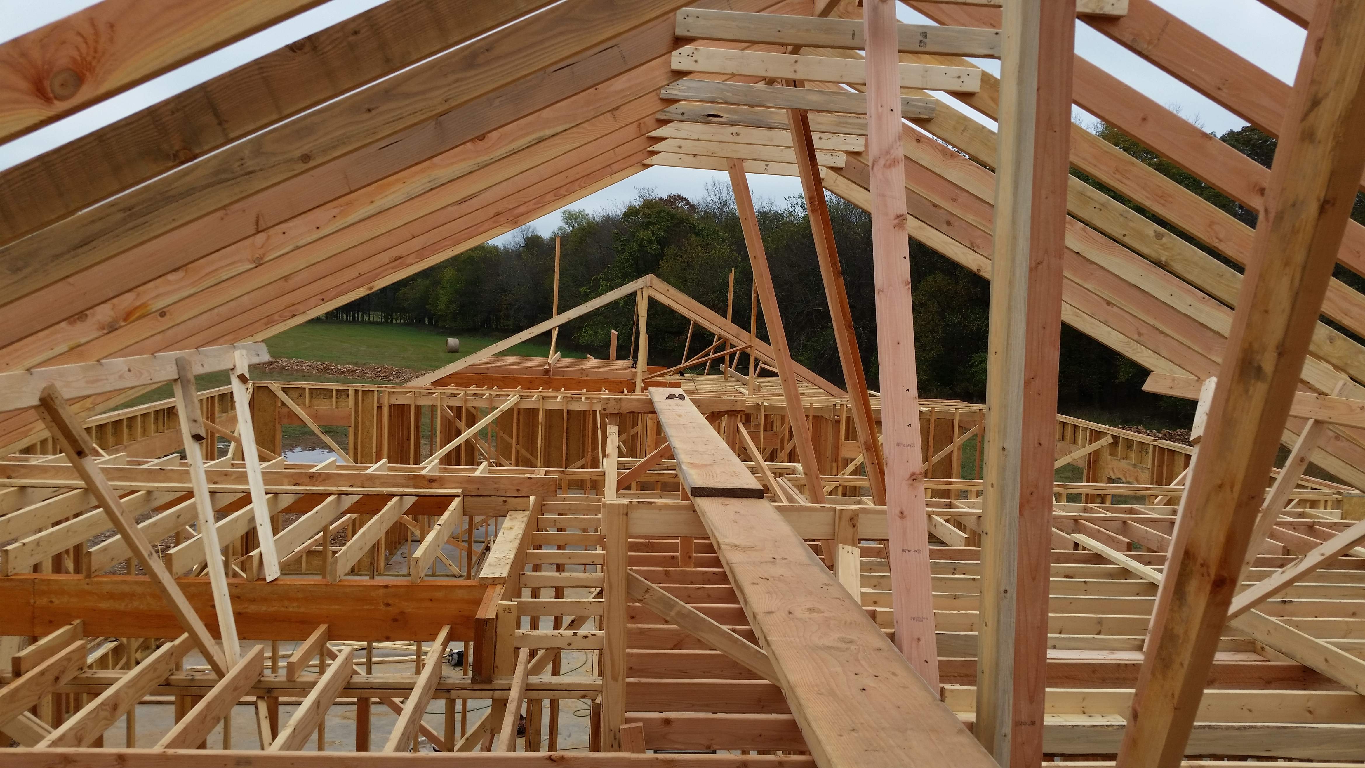

As things move along, I'm becoming more comfortable that we'll be able to get this thing weather tight before winter hits.
The roof on both ends of the house proceeded while we were waiting on great room trusses. At this point, I realized we wound up with a much larger attic space than we had expected. The clearance is over 9' in the center, providing approximately 15' x 40' of usable space. Like everything else, we're scratching our heads over what to do ... squeeze in a staircase and convert a portion of that area into an office - or not. It would require $$replacing$$ an amount of 2x6 with 2x12 to support the floor.

Maybe you could just add another set of 2x6 s on top of the current 2x6 s. You ll also have to consider proper way to insulate in the rafters where the office would be, taking into consideration vapor and ventilation.
   / Building our retirement home #185
I would convert it now while it easy to do, instead of later when it will become a much more expensive proposition. Space is only usable if it is accessible, it will also add value to the house.
We have the same happy accident going on now. The upstairs portion of my Barndo build will be 1500 sq ft of usable space. We have already begun plans on how best to utilize it.

Pretty cheap and easy to convert it to livable space now if that's what you want. Just remember that more square footage is going to cost more to heat and cool. Are you taxes based on square footage? Do you need it for anything? Who is going to maintain it and keep it clean? In my experience, as we get older, most people want a smaller, easier to take care of home.
My first thought was where are you putting your mechanicals? A big, easy to get to space for the AC and Water Heater, or Water Heaters is always a nice thing to have instead of using up quality floor space downstairs.
   / Building our retirement home #187
Do you really need/want more living space to keep clean and maintain? How about storage space? I like the idea of HVAC being out of the way up there but not so much for items with water in them. Did you mention how the house will be heated and cooled?

HVAC will be in the attic, originally adjacent to pull-down stairs but at least one set of pull-downs will disappear if we develop the upstairs. I do have a mechanical room that will house one of the 2 water heaters, breaker box and water filtration/purification gear.
As to the "how" ... the home is total electric. Not my preference but that's just how it is. We'll have a wood-burning fireplace in the great room.
When we get closer to the end of the build, we'll look into either a propane fed generator or - my preference - a solar generator.

I'd have a load bearing wall down the middle of the bottom floor, tear out all the ceiling joists that look like they are floating on the interior walls, and put some 2x10's across that will serve as ceiling joists and flooring for the attic. Even if only attic, I'd be using that space since you raftered it. It will also help with keeping the rafters from spreading, those collar ties seem to be small and high on the rafters.
