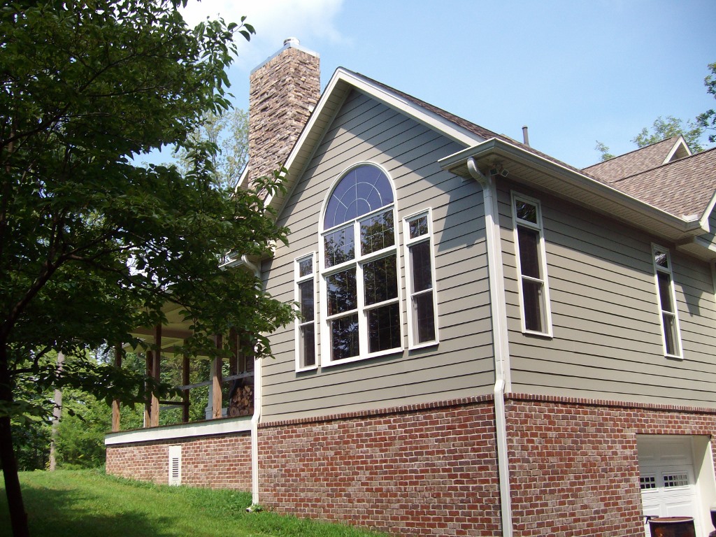

I thought about your post last night as I went to sleep beside our large bedroom "sky view" window set, looking at the stars. So I respectfully offer a very different opinion of anything that obstructs that view. Stick to your guns Kioti.
- Jay
Thanks :)
I'm sure, to many, this all seems a bit much ... petty. Perhaps it is, but we picked our building spot for the view - all of it.
We're just plugging along and will cross this bridge at some point. The beams and trusses were raised today for both porches. They're on temporary legs for now but the posts will be arriving in a few days. Tomorrow, we dig the 4 holes in which they will be cemented.
