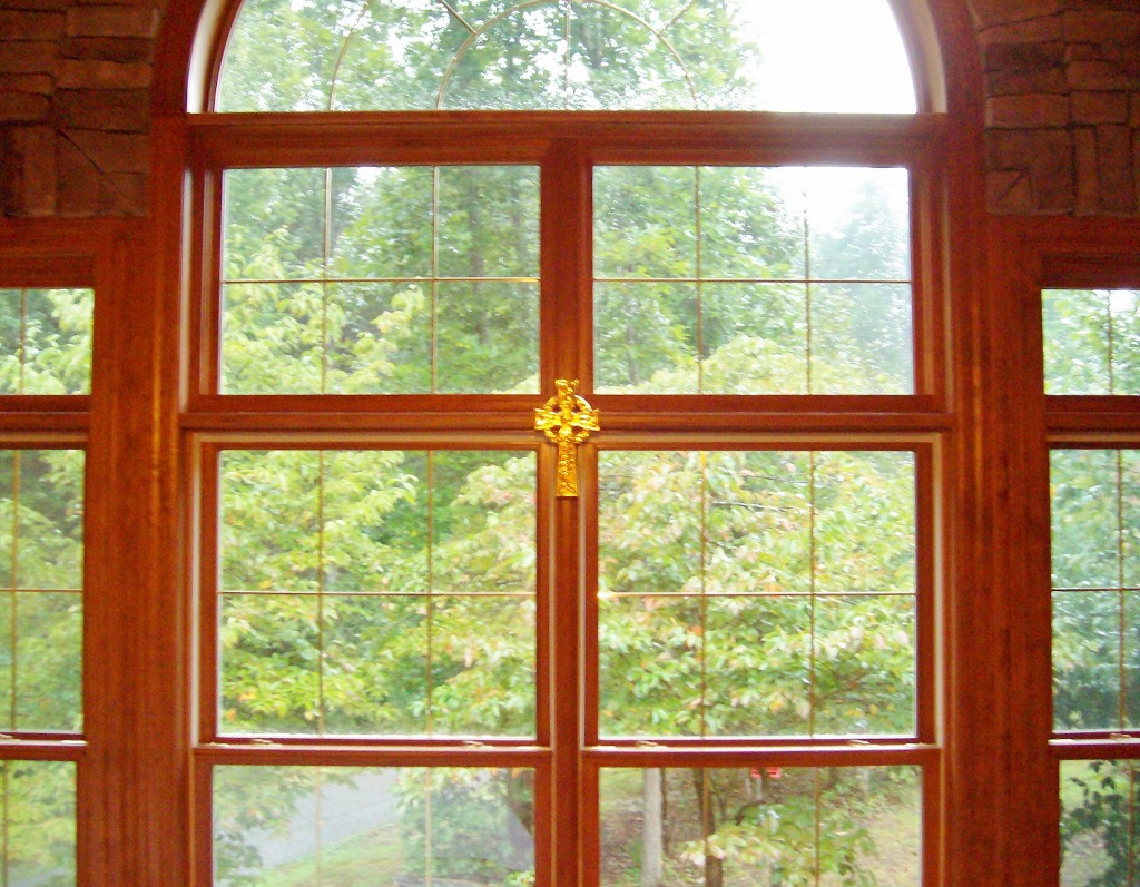

Looking really good! I really like your idea about the bedroom window personal touch. We just added an ornamental brass Celtic cross.
