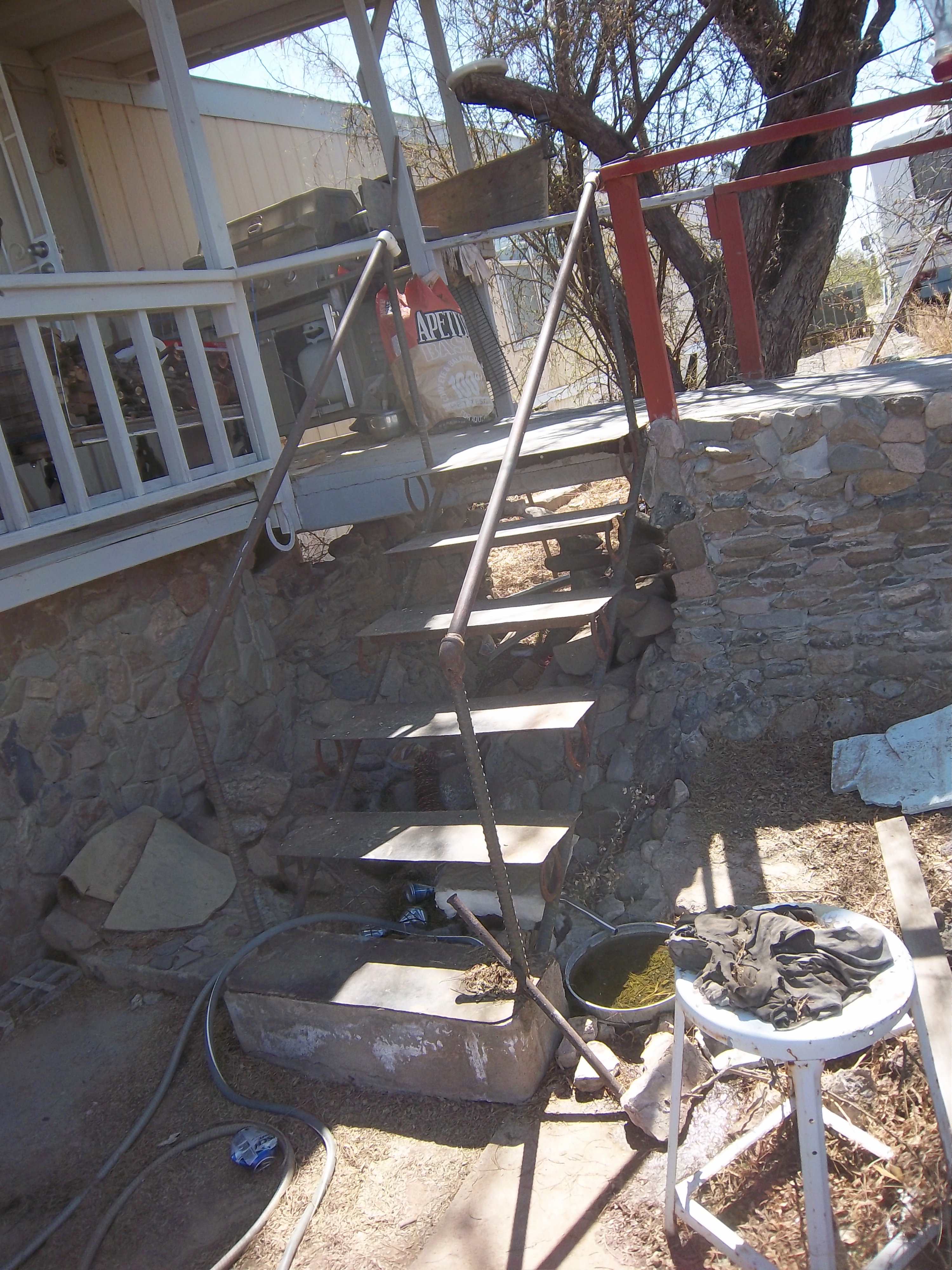

Here is a set of stairs that I built. Basically all you have to remember is 8 or 9 inches between & the same width.
They are made from 1" bridge re-bar & 1/68" treads. treads have a angle support on the bottom.
Were that regular re-bar they would not support the load. have had 2 250# + guys on them with no sag.
   / Building stairs/steps #24
They aren't to code, your first step is too high in comparison to the rest. Not a critique, just say'n. Like the ring supports...
Nice looking steps.
Not sure what is typically used in Arizona, but in Ohio bridges use regular 50ksi rebar most of the time

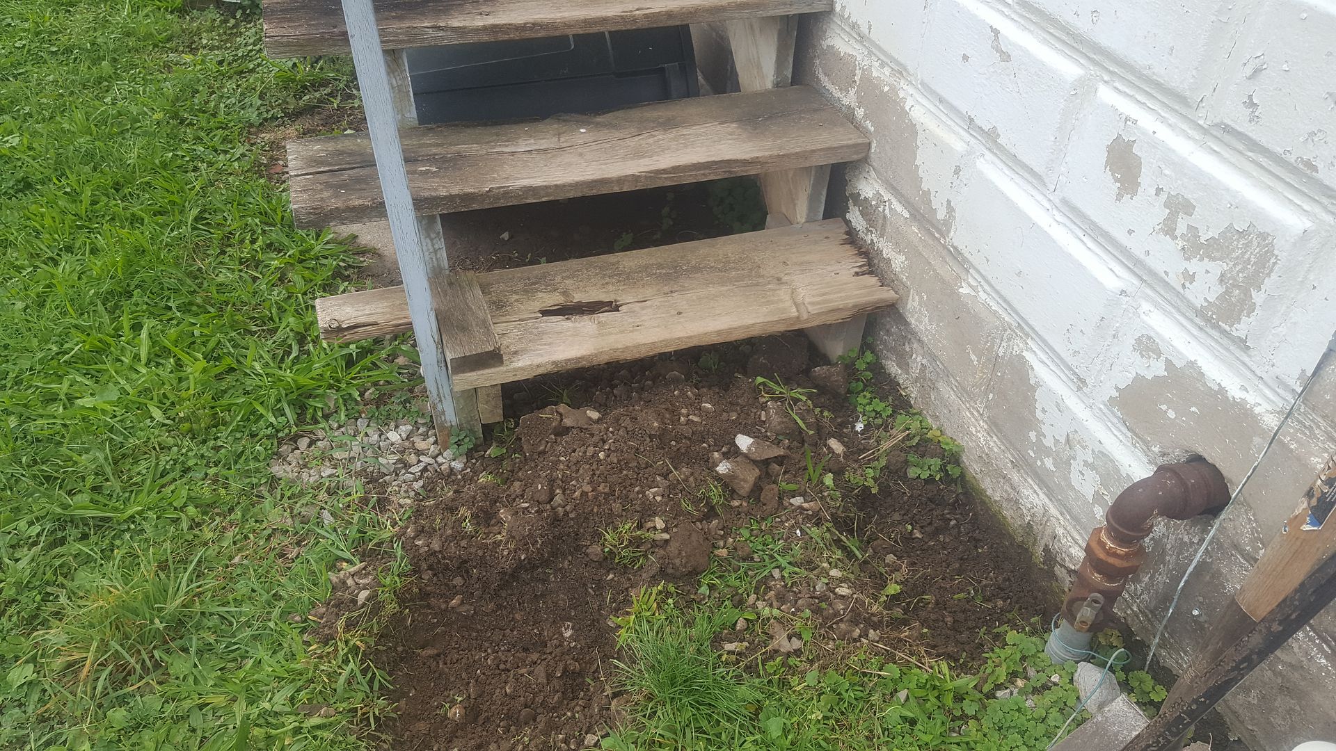

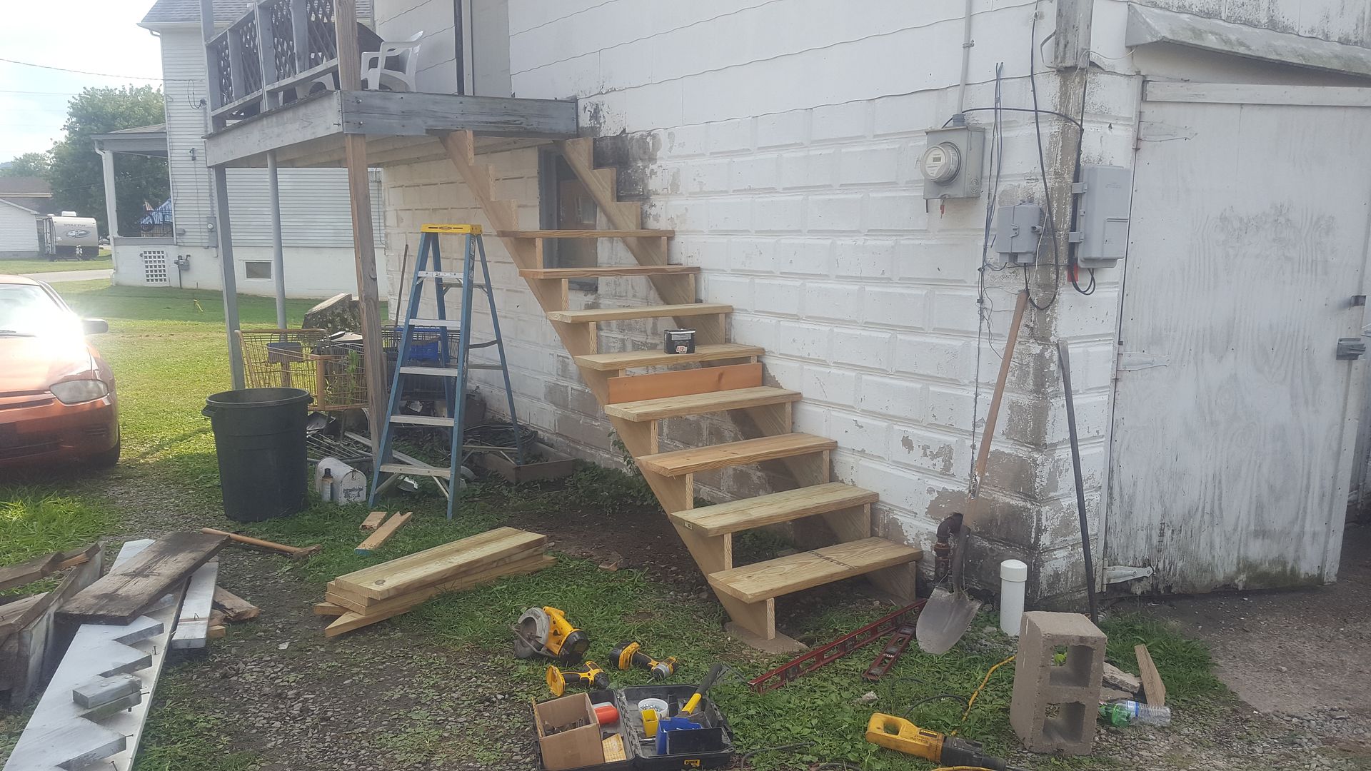

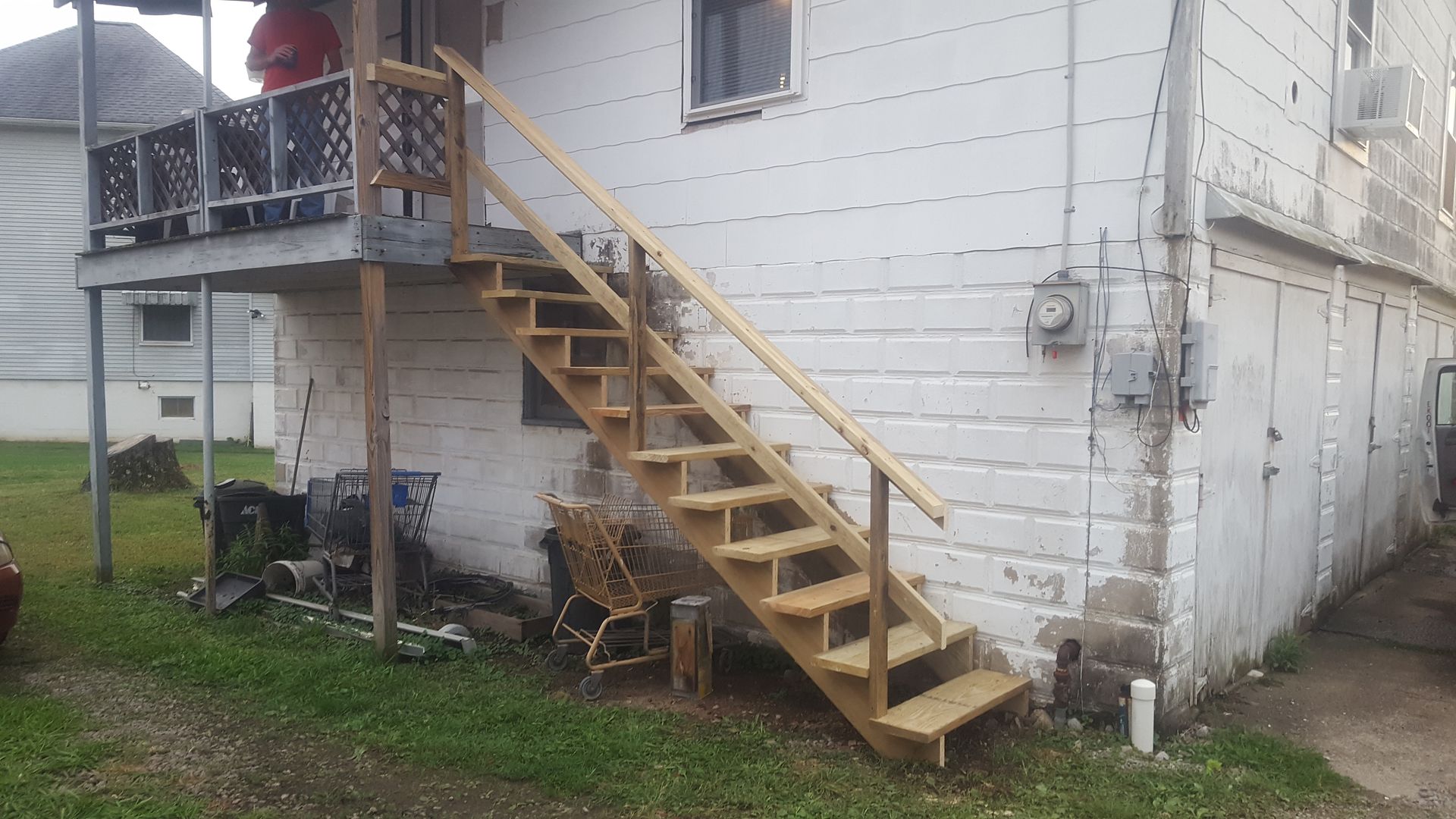

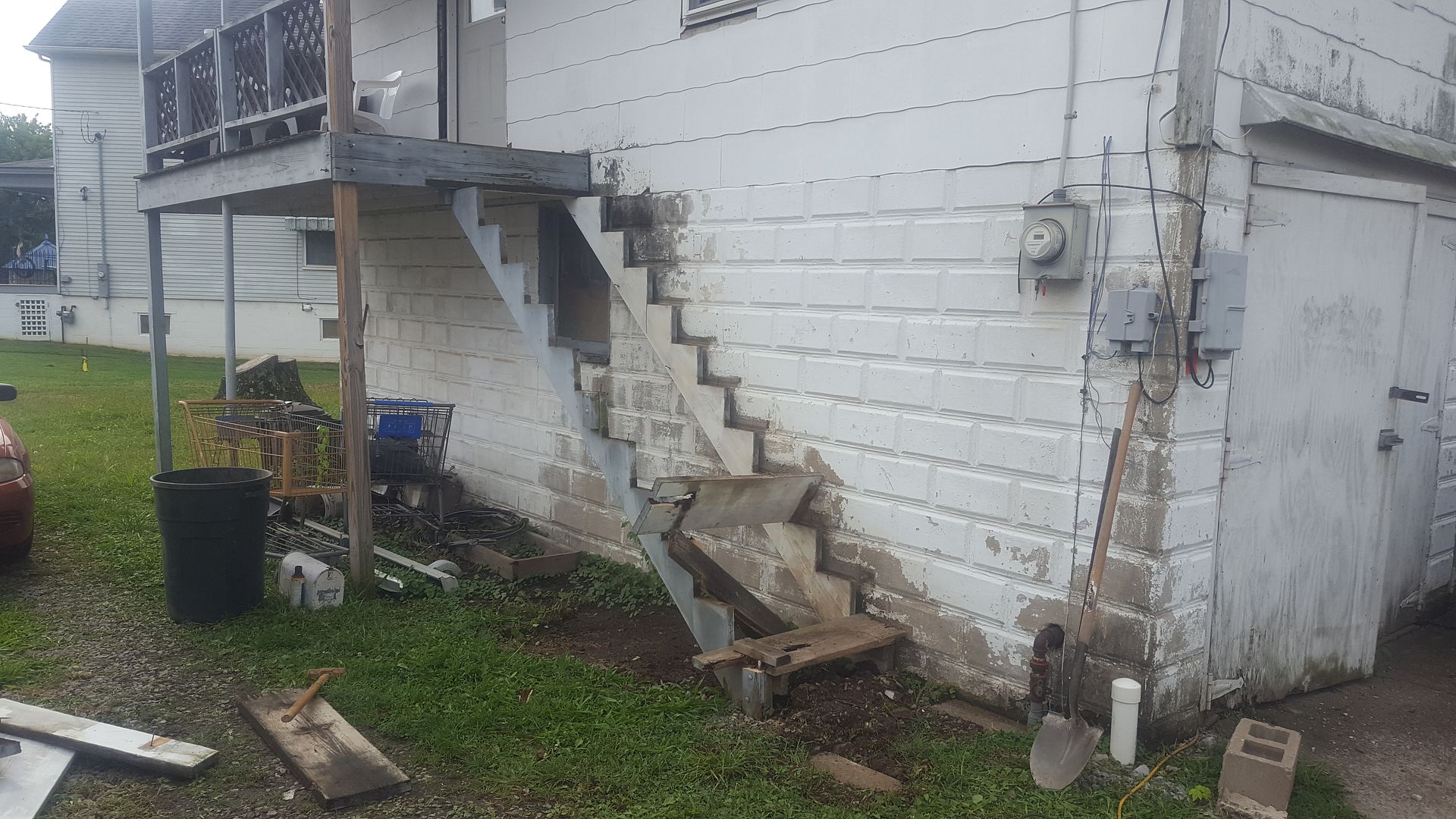

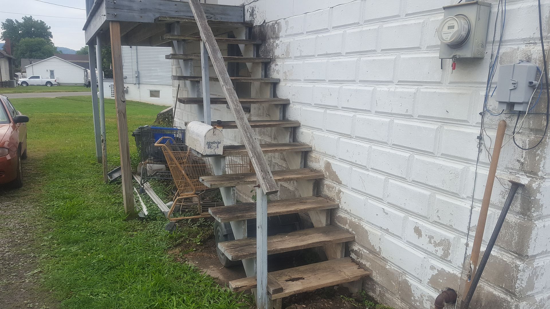

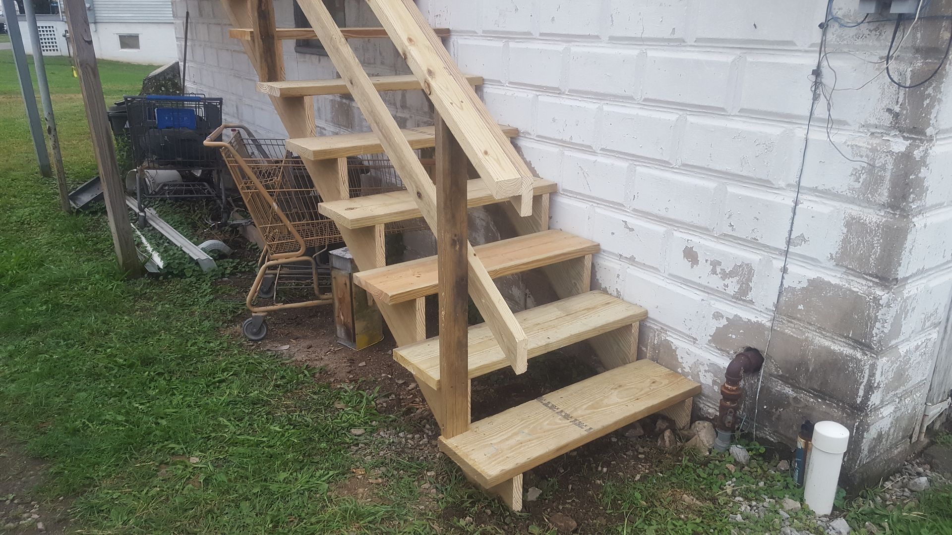

I finally got around to dealing with these steps yesterday. Long overdue.
I started by digging out 2 spots to put some chunks of concrete block in the ground to have a solid place for the stringers to rest, in the new, longer location.
Demolition took only a few minutes with a sledge hammer, Sawzall, and crowbar...
I cut the new stringers to size, I had not trimmed the top and bottom ends due to the variations in both ends. A few measurements with a level, and getting them to fit well was easy.
And a few hours after I started, new stairs and a quick railing. If I had it to do over, I'd put a 3rd stringer in, but they are solid enough as-is, and a big improvement over the old ones that have held up fine for 20 years.
