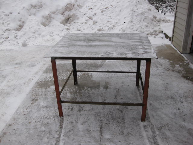

Thanks for all the ideas. I'm sure someone else will find this thread helpfull. Anyway I did not finish the table yesterday... got to do something else with the wife request ;).
Here's a partial pics of where I am. I wanted to put two receiver on the end but then change my mind and will be putting it on the front instead. I will be supporting the middle of the table with one 2" tube then every 8" or 10" will be 2" angle iron forming "V" on the table and will just strip weld it to prevent the top from warping (not sure if it is but just to be on the safe side). I will be putting 5" casters on it from Northern Tool with 1000lbs. rating. I'm still thinking how I will put a brake on it but we'll see. So... how am I doing so far? Will take more pics as I go on....

Thanks guys. I decided to pick up the 1/2" plate and the money save is going for a floor drill press :thumbsup: or maybe a combination mill and drill press :drool:. Now that will be another question I will be asking later on...:D. If the weather gets warmer this weekend I will be building this.
Guess this is settled law but for a hobby welder I think 1/2 inch is still way overkill. When I bought our farm the owner left me his welding table which was just vertical 4x4 and a top plate that's either 1/4 or 5/16 at most and I just don't know what I would need it thicker for. The thing's sturdy, too heavy to move around now and does the job for a farm welder just fine. I mean 1/2 inch won't hurt anything. Just costs more and doesn't do a lot more for you unless you're jigging up some really big projects.

looks good so far. 1/2 is the way to go. The extra mass is more than worth it.
How much lip are you leaving around the perimeter? You want several inches (as deep as your deepest clamp or clamps you intend on buying)
on the receivers 2/side gives lots of flexability although i only use one or 2 at a time. cheap and easy to do now however.
   / Building welding/work table? #24
2" would have been plenty for the legs, and then you could have welded the legs to the strongbacks instead of the table top. part of the reason for the strongback setback is so that you can still use the full throat depth of c clamps around the outside edge.
looks like you are doing a nice fit up job anyway:thumbsup:

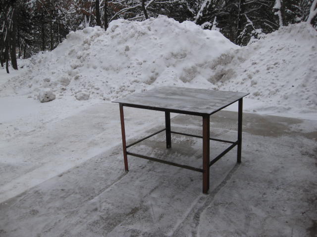

This is just an update where I am now with this project. The wheels came in today so I just place it there and took a picture but am not really sure if I should weld it now or later once I flip it. It will be easier to flip it without the wheels but will be awkward to weld it later. Any ideas? Thinking lift it by the tractor or put it on my four post lift so with higher reach... Here's the latest pics anyway.
   / Building welding/work table? #28
Looking very good so far.:thumbsup:

The table I use the most is a 3' x 4' x 3/16'' and sits out side year round :D
Your table is looking good :thumbsup:
