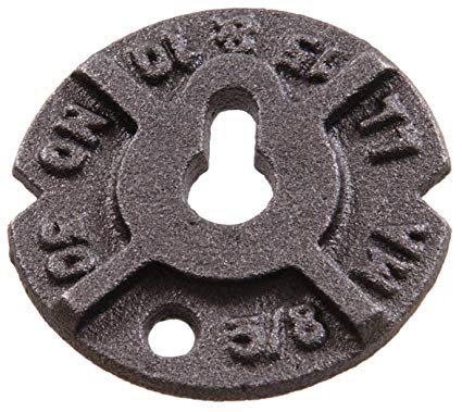

Just thought I would mention these malleable iron timber washers. I've used them with through bolts to hold 3 2x12's etc together tightly. Instead of nails or screws. It is really easy to get a nice tight beam. Also good for beam to post connections. They come in different sizes.

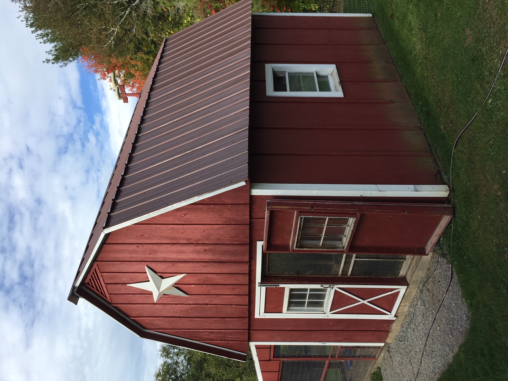

I will post pics as the build progresses. I've been on a construction kick lately. Just had a new roof put on the house and garage, my wife and I put a new metal roof on our 12x16 chicken coop, the woodshed is next, and then I demolish my 40x50 barn to make room for a new 30x40 pole barn kit being delivered in mid-November. Busy time on the farm!
Here's the chicken coop with the new metal roof.
