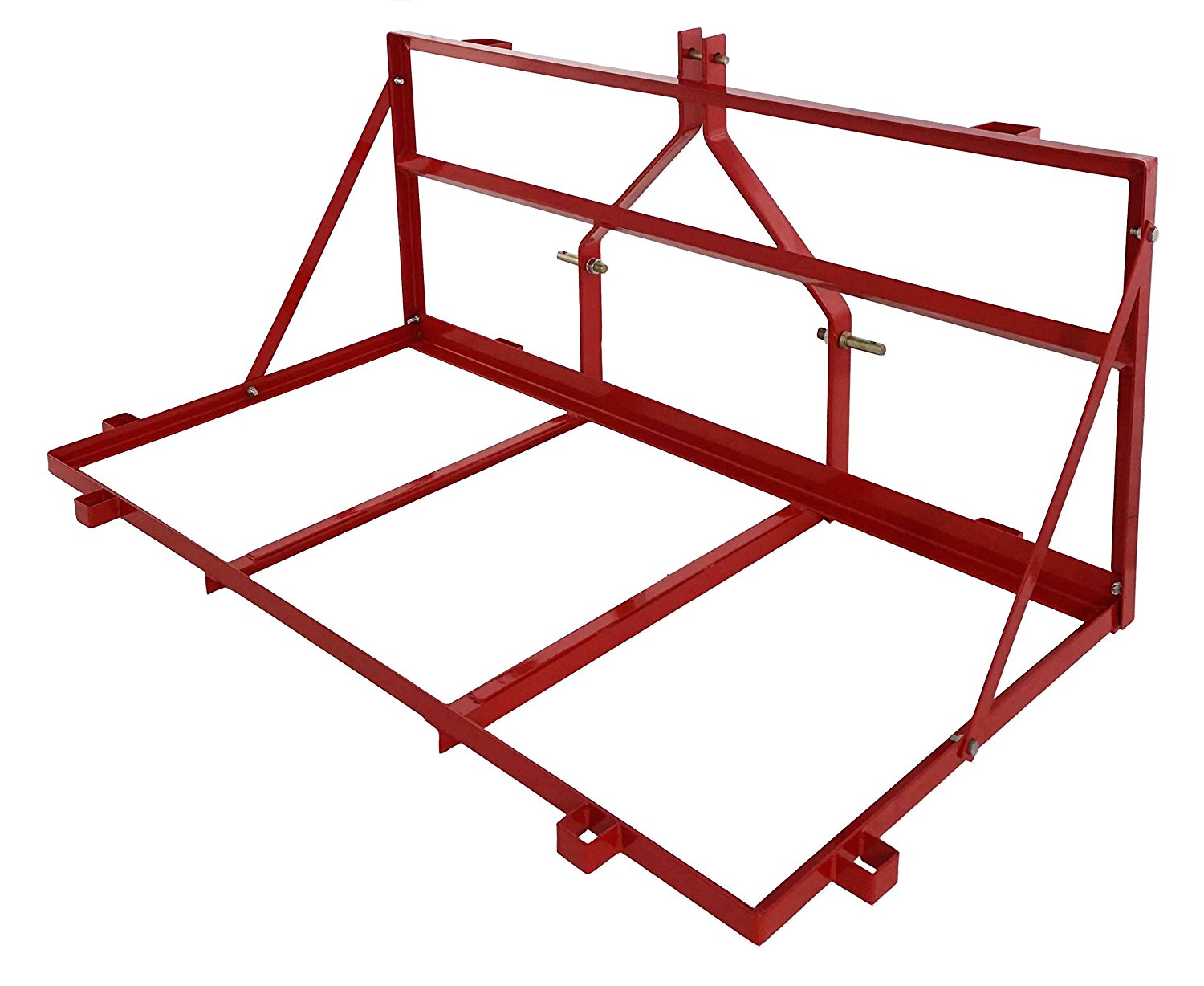

MossRoad's solution is the cheapest and fastest solution if you have some extra bodies to lift it. You could also make or buy a cheap of 3-PT forks and let the tractors hydraulics do all the lifting for you, cargo strap the dock vertically to the ROPS and drive from your barn to the water. Your tractor will be able to use whatever ramp is available, remove the straps, back down to the water and tap your breaks. Splash-down :)
   / Built 8x8' Floating Dock in Barn - Now Need to Transport It to Site!
Yes, that solution seems like it would work. As for your idea about the 3-PT forks, that's interesting too. Wonder whether that idea might be adapted to my carryall- I mentioned it being 7' wide, but I think it's only 6. The actual carryall can be seen in the background of the previous photo; the one shown in this post is an image I found on the Internet, but it's identical.
   / Built 8x8' Floating Dock in Barn - Now Need to Transport It to Site! #5
Just flip it up onto that sucker and strap it down! :laughing:
