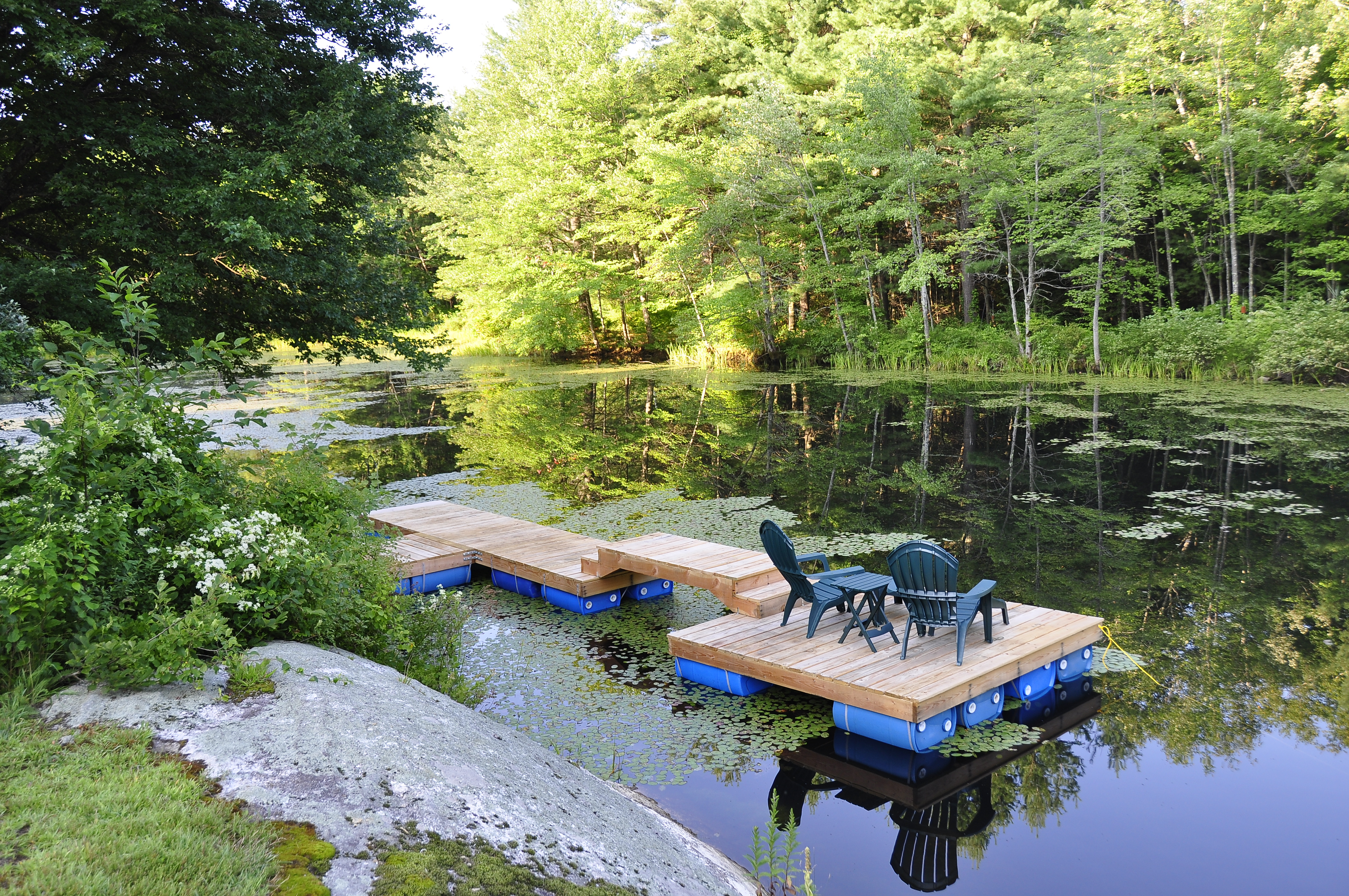

I did the same thing, built my dock in the garage where it would be level and easy to work on. I moved my 8x8 dock, 4x12 and 4x16 docks with forks supporting one end and a heavy duty 3" tow straps supporting the far end. If you don't have access to forks, mount large eye bolts into the sides of the dock and use straps with hooks to pick it up with your FEL. Here is my completed dock. Hope you enjoy yours!

It looks pretty stout, but I would add some diagonal bracing for the move. I would be afraid that one wrong move could rack it and tear up the corner joints. A few diagonal brace would be cheap insurance.

Well before you do anything you need to brace those corners better. Maybe I just can't see it, but shouldn't you be putting some carriage bolts through the side boards and through that 4 x 4 inside corner piece? I have built several dogs and I always put one of those metal corner braces on the inside of each corner.
Also is that just rope that I see holding the four blue barrels? What are you going to do when the ropes start to stretch?

Are those barrels full of foam?
You will want to fill them with foam.
