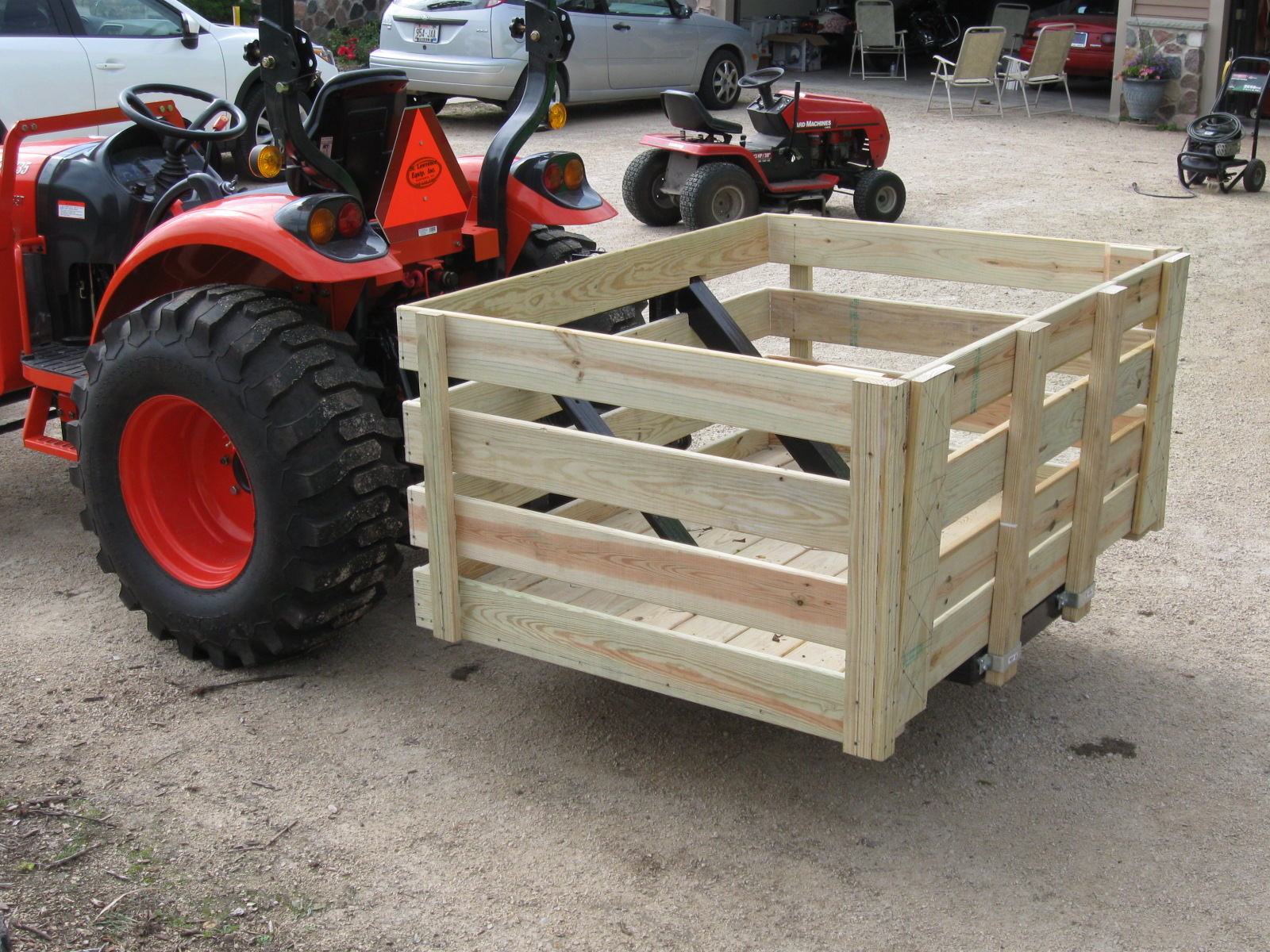

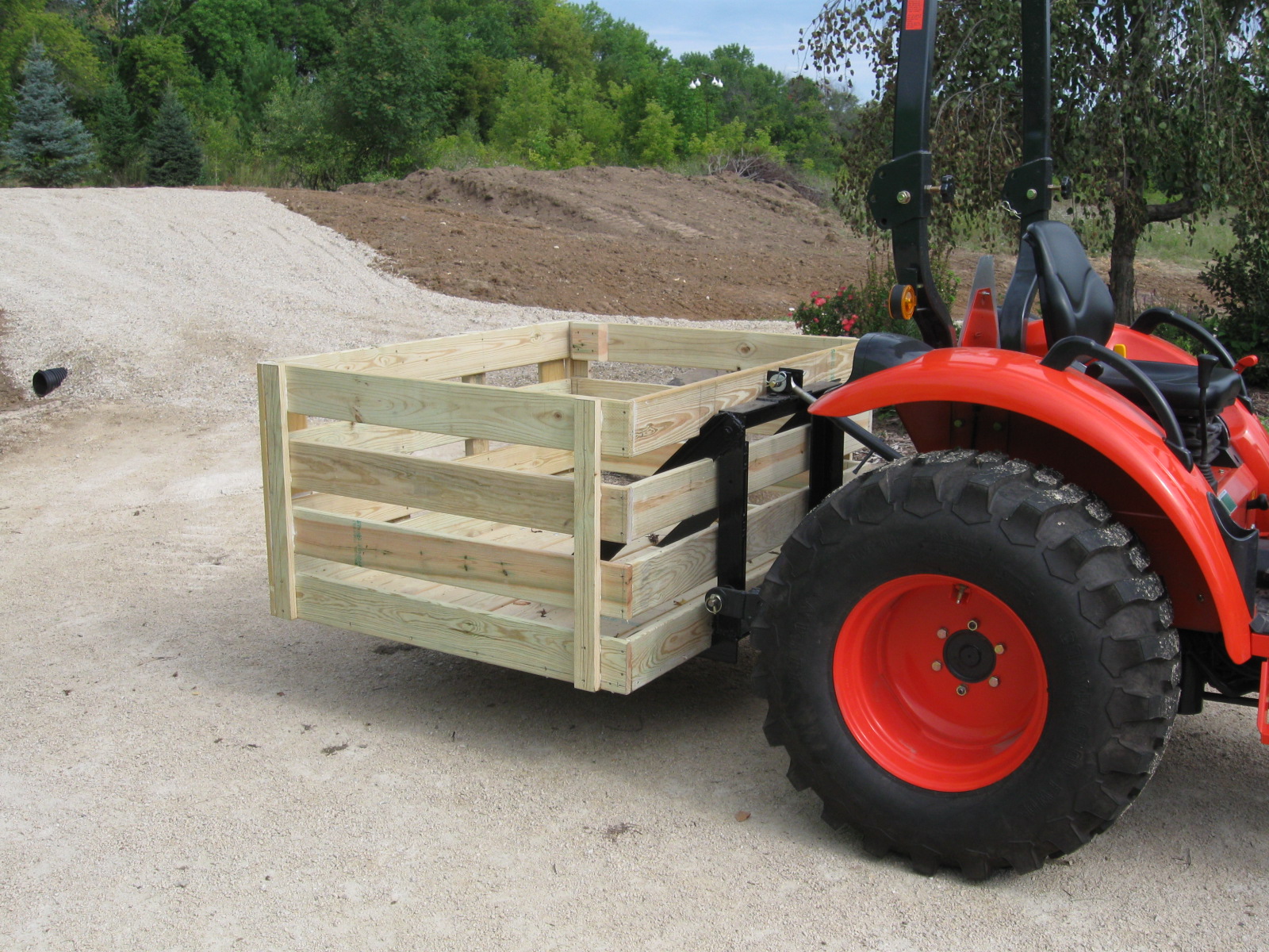

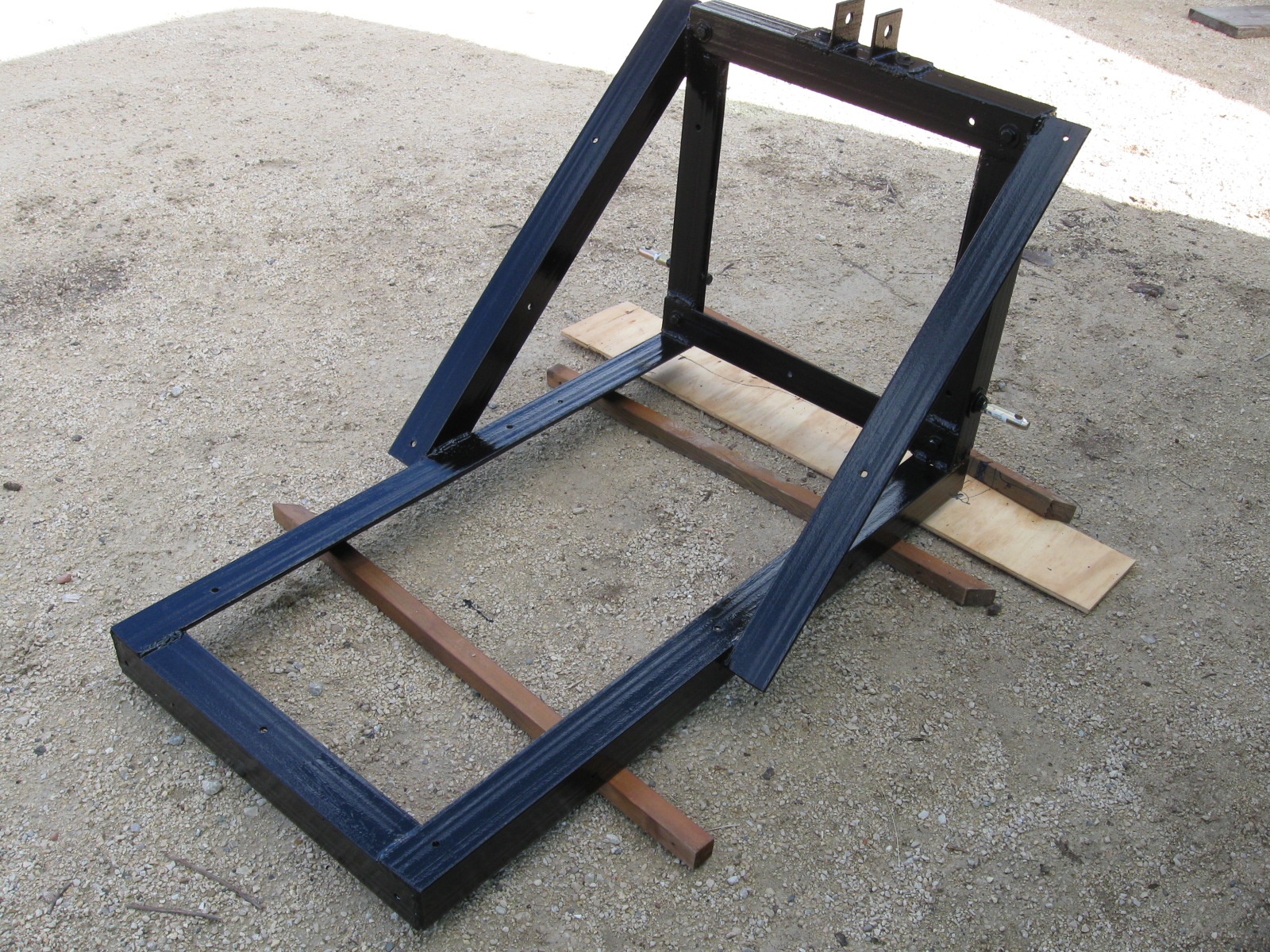

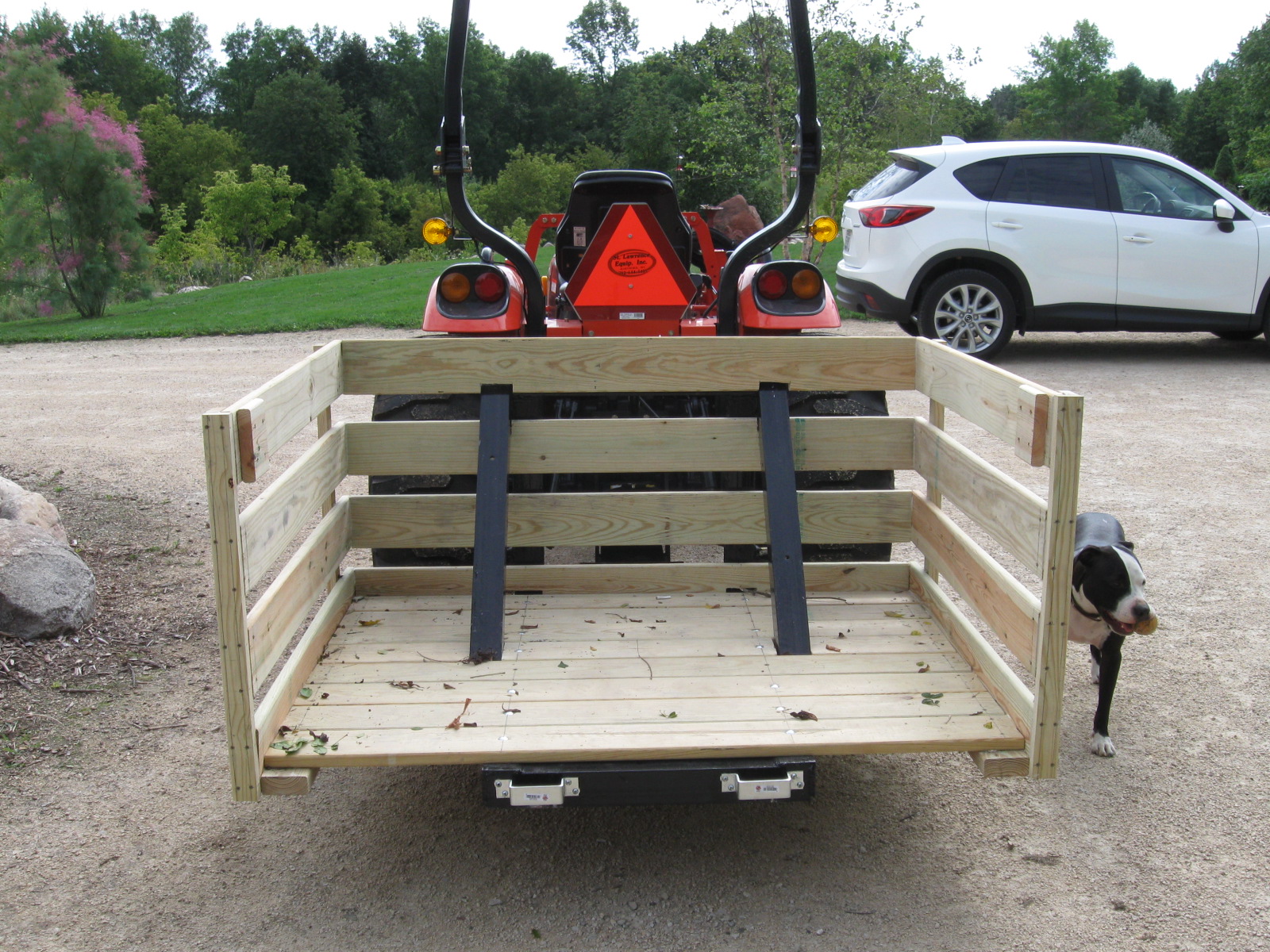

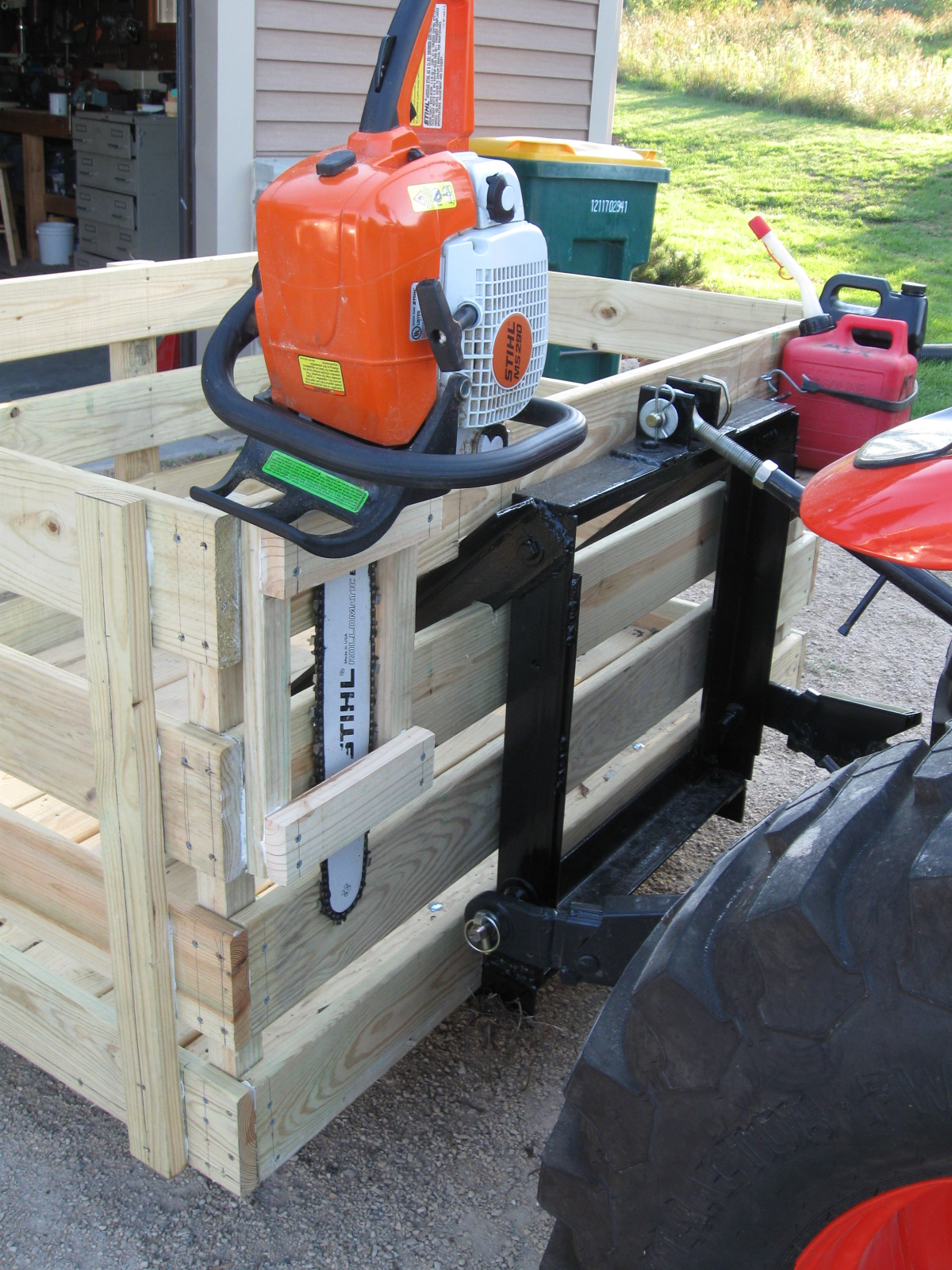

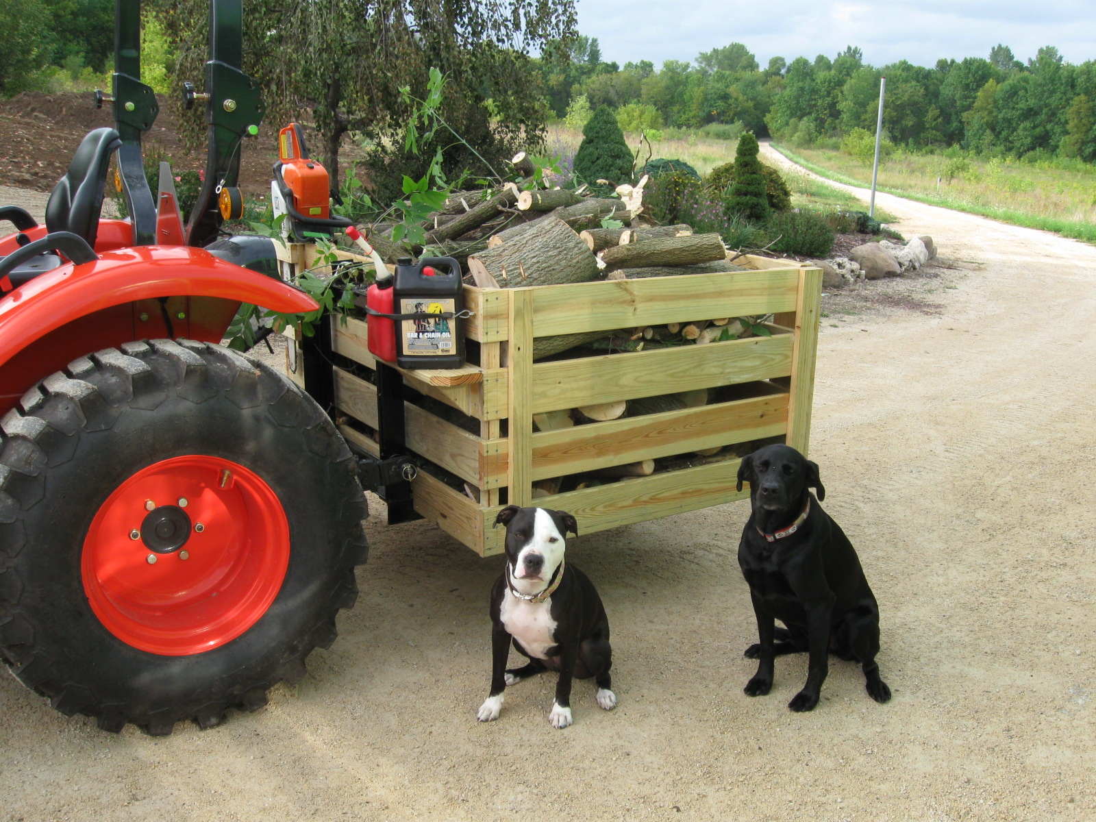

I wanted to get a trailer to haul firewood. Instead I saw a few pictures of "carry-all's" on this site and decided that would work a lot better for what I wanted. IMG_0784.JPGIMG_0786.JPGIMG_0787.JPGIMG_0788.JPG
   / BUILT A "CARRY-ALL" FOR TRACTOR
I decided to put the angle gussets inside the box to really "beef up" the box. I plan on only hauling firewood so the supports won't really cause a problem.

Very nice build. I too may have to "borrow" some of the concept.
I've been wanting to build one for a while. When I think I get close to a concept I like, someone else posts their build and I am back to "hmmm" - i could adapt that....

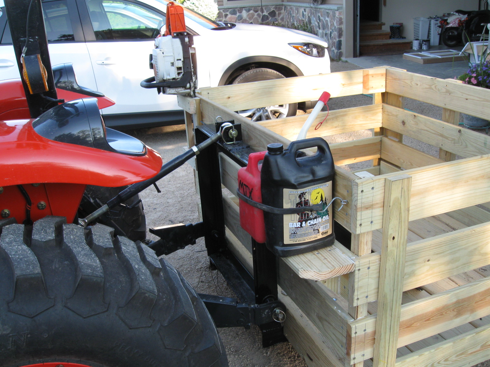

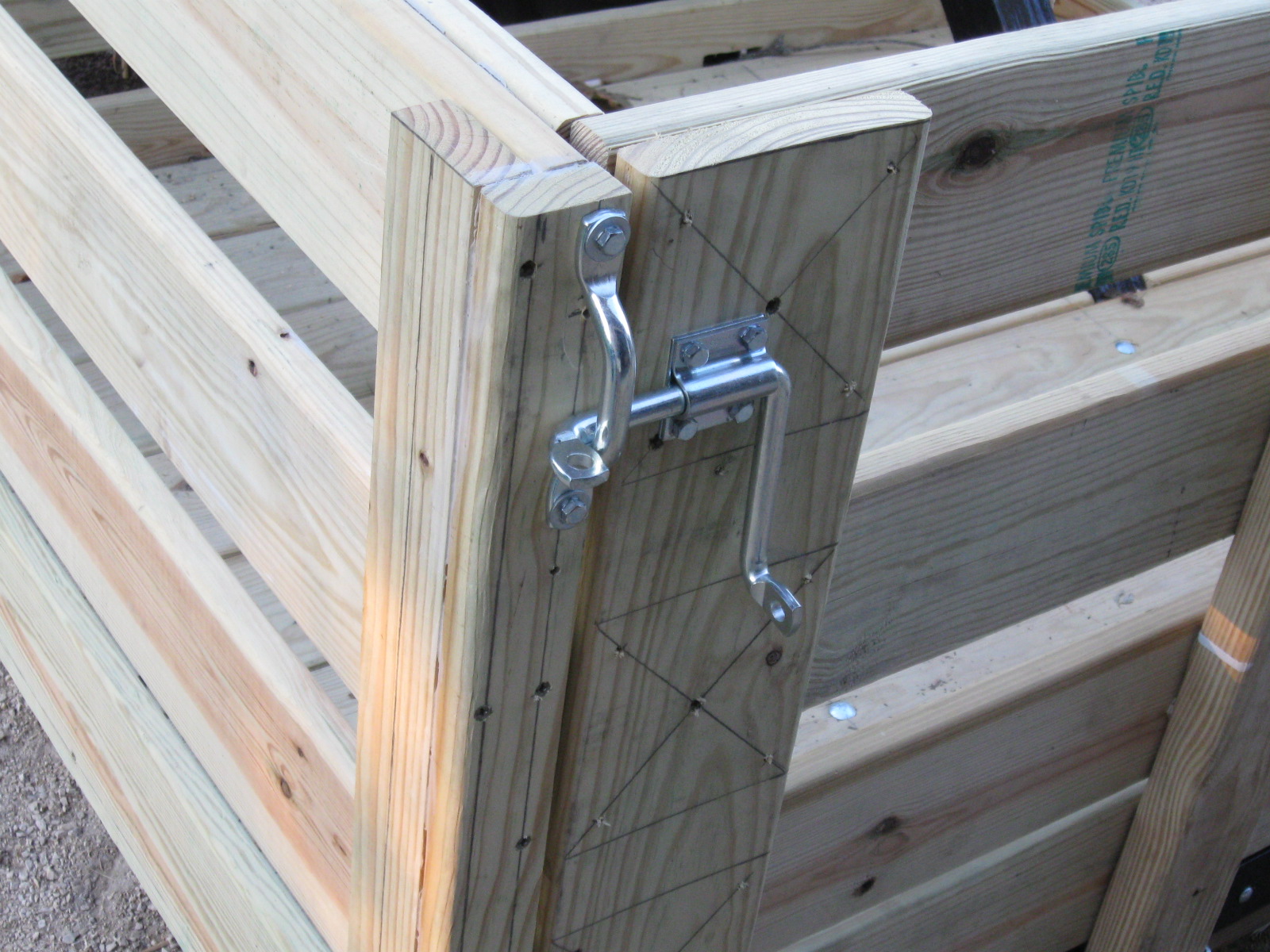

I added a couple of pictures of the last few finishing touches. A chainsaw holder, gas and bar oil holder and a couple of gate latches.IMG_0792.JPGIMG_0793.JPGIMG_0794.JPG

Looks really good. You will find it handy for alot more than just firewood.
