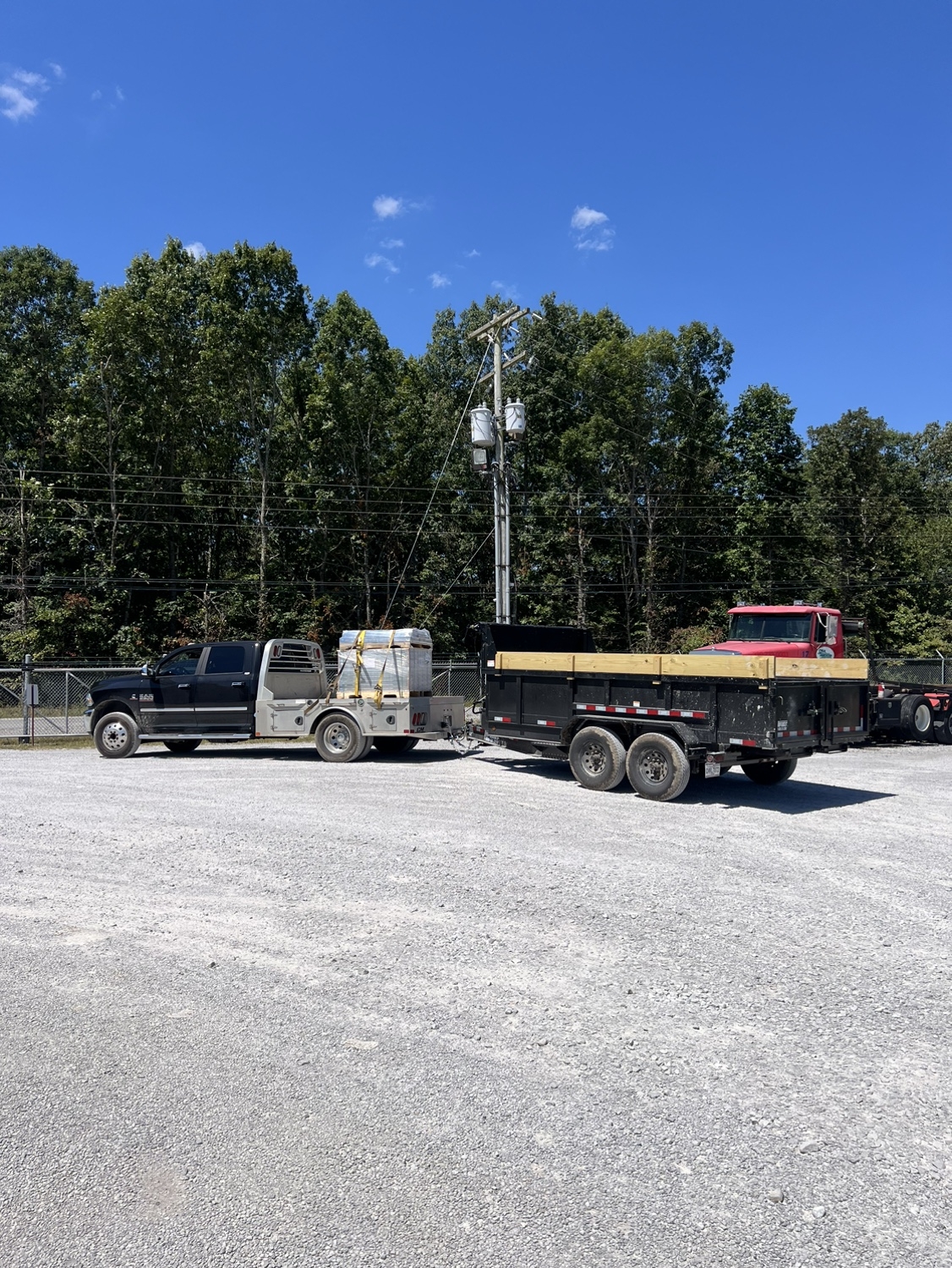

That load of sand was 5.3 tons. I usually only haul gravel, dirt or sand if I can finish the job with 5 tons. Otherwise it’s cheaper and faster to call a dump truck. I use the dump trailers plenty for hauling light material but hauling gravel isn’t a productive use of time.

I hate 14k gooseneck trailers. At 20k they kinda become a necessity but a 14k bumper pull trailer pulls fine. I don’t want to give up my bed capacity plus have to work harder hooking it up just to pull a 14k trailer. I set something on the bed and pull a trailer behind it all the time.

That’s true. I’ve pulled 14k trailers with single wheel trucks and it definitely bounces more than my dually but it’s acceptable. If I was pulling the trailer 1,000 miles a week well the first thing I would do is get a dually but to stay on topic I’d rather use a GN. If I was pulling the trailer once every couple weeks I’d get the bumper pull. I probably wouldn’t pull the trailer and put a pallet on the bed with a single wheel truck.
