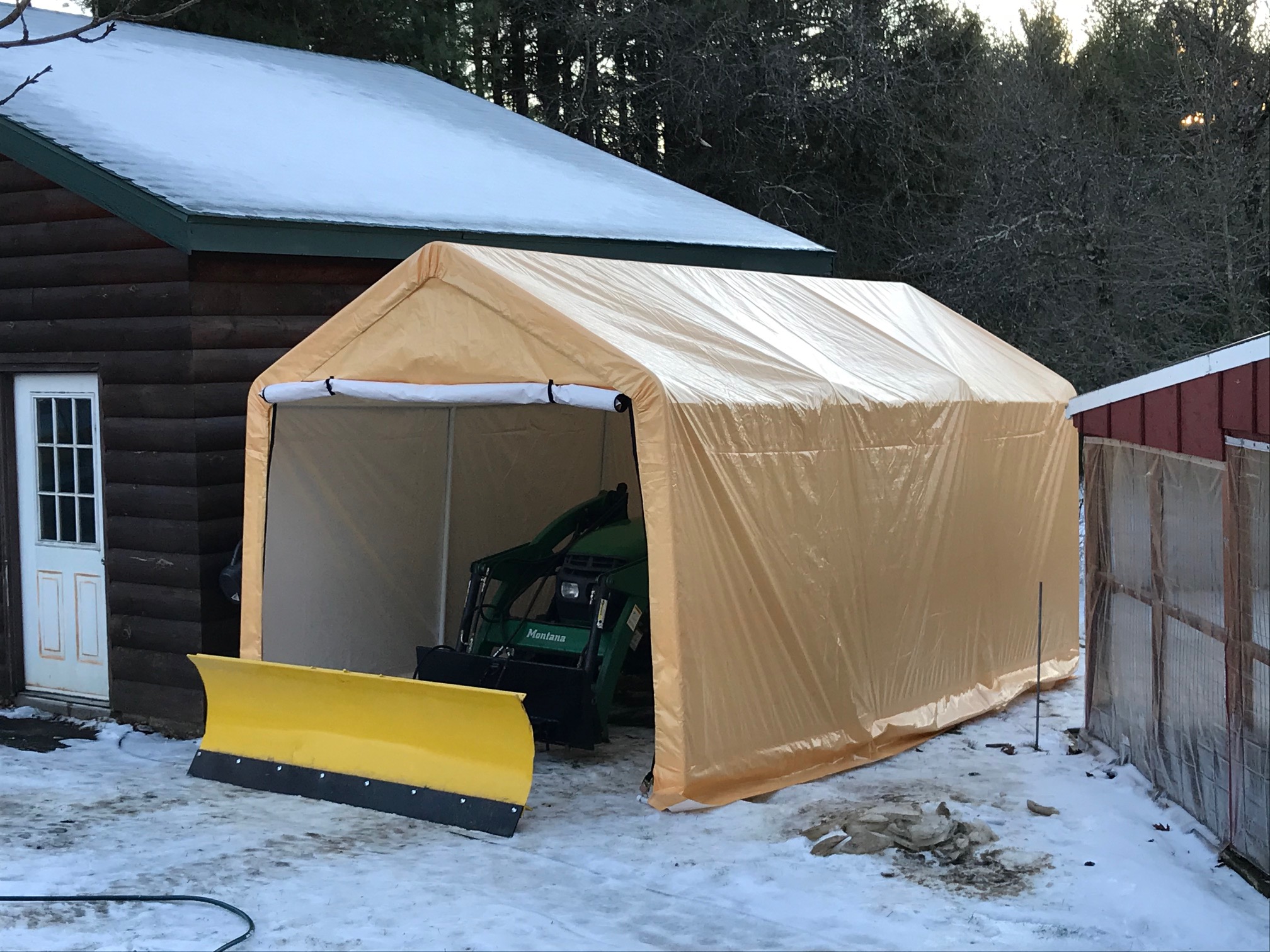

Construction projects never seem to go as planned. I am building a new barn that will have room for animals and the tractor. But the new barn is going in the same spot as the old barn, so the old barn had to go. I was planning on tearing it down in October, and building the new barn before Thanksgiving. Delays with the demolition company pushed the barn demo to mid-December. Here's a 1 minute time lapse.
Barkhamsted Barn Demolition - HD - YouTube
I bought a pole barn kit and have all of the building supplies stored in my 2 car garage. I pulled the building permit for the new barn, and had the holes dug for the new pole barn. When the building inspector came to sign off on the holes, he said they looked fine, but since the ground was frozen, we could not move forward with the new barn until Spring. He said we would not be able to backfill the holes / set the poles properly, or bring in the 2' of fill needed to level the building site, and any poles we set now would shift come Spring.

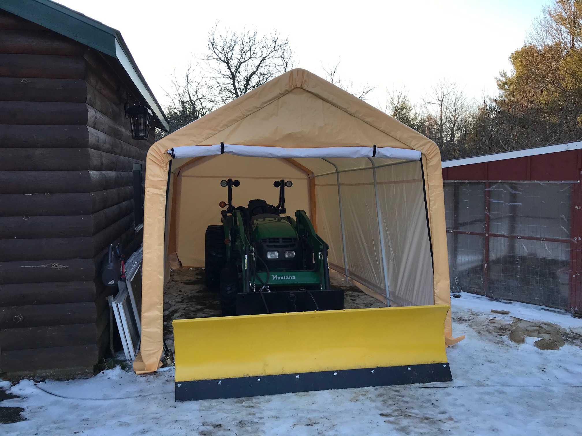

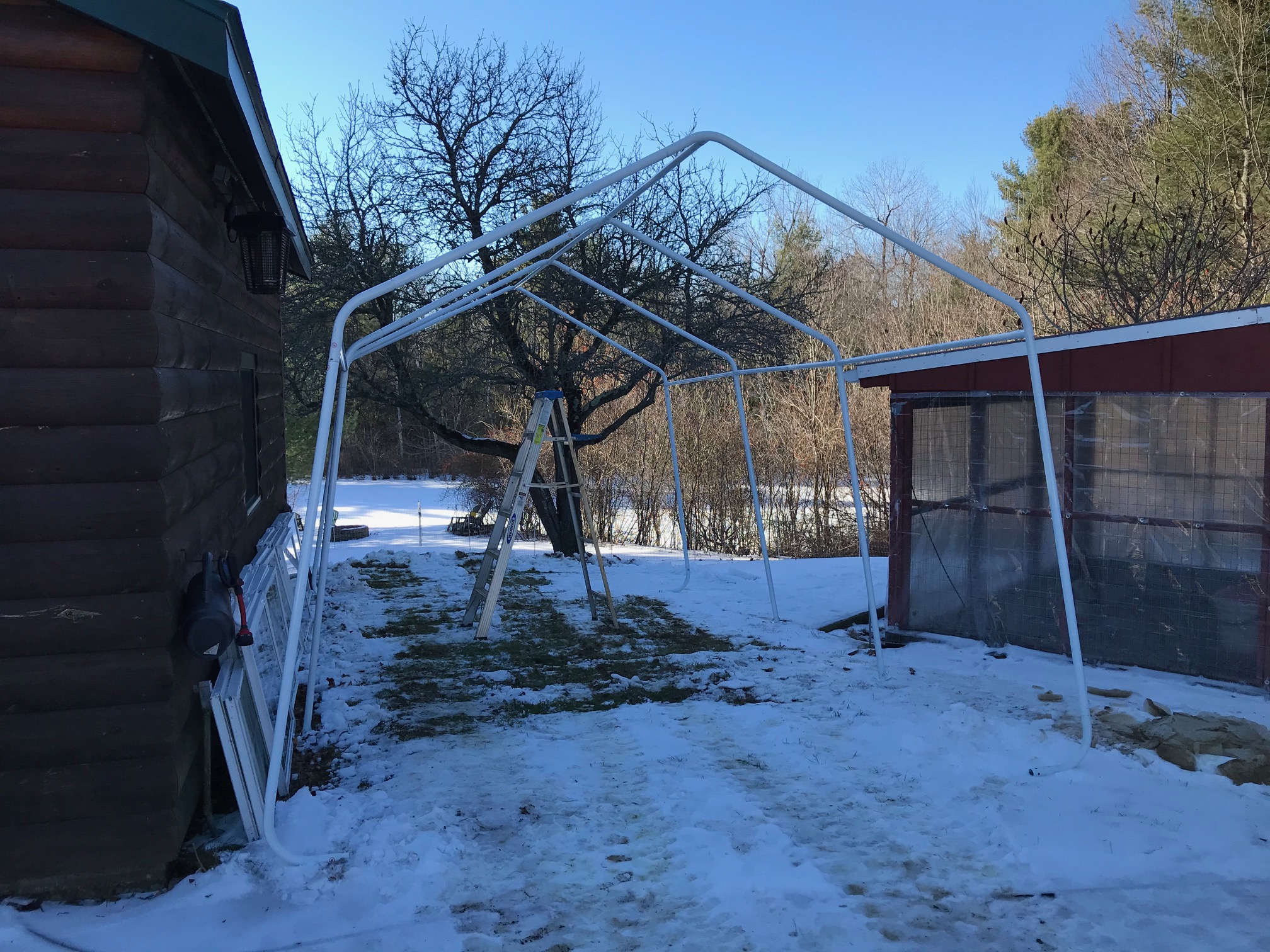

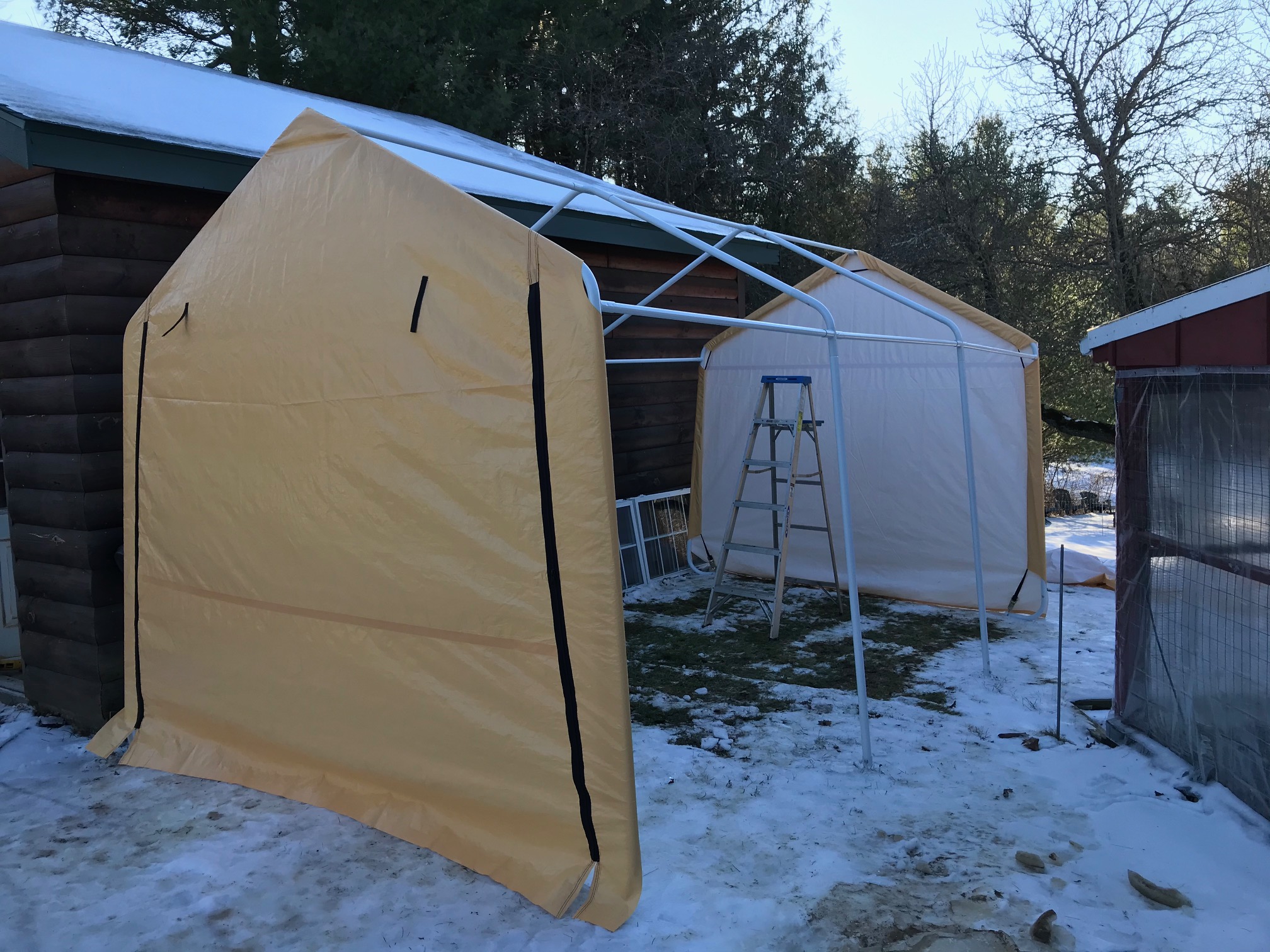

So now I need a place to store the tractor during the winter. I decided a temporary garage would fit the bill and picked up a Harbor Freight 10x17 garage and put it up today. Would have been easier with 2 people, but I managed to get it up by myself in 3 hours. As long as it lasts 1 season I am good, as the new barn will definitely be up by next winter!

That seems like a good temporary solution. I did the same thing before my barn was built. Those things kind of remind me of putting up a tent. It's awkward to get started a stabilized. Once you have something solid, it progresses more quickly.
In very humid weather, I had quite a bit of condensation inside the shelter, but it's better than leaving the tractor outside.

I have one going on two years. I did pull the cover off for the last hurricane. It is holding up well. The zippers were getting a little stiff so I rubbed them down with candle wax.

I bought the same thing. I did not like the force fit of the pipes. I used self tapping screws to help hold the joints together. I also placed the building up on 4 railroad ties. I lag bolted the post to the ties. Then I put the ground screws in and tied them to the legs. I bought extra ground screws for the 4 interior posts. No snow to worry about but the wind has not been a problem. I did not put a tie across the closed end. The opening on each end allows for nice ventilation but no wind blown rain. If you buy the extended warranty for $50 they will replace the tarp if damaged within 2 years. So about 21 months in the wind is going to poke a hole in it.
