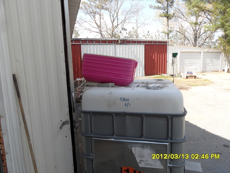

Both, and then get an IBC tote or two
And store hundreds of gallons of water easily.
