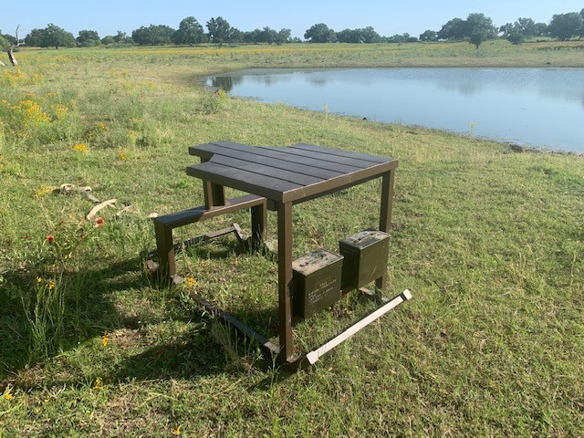

I came up with another idea to mount a couple of ammo cans to the underside of the seat or top to hold some shooting bags, stapler, gun lube etc. I found a really awesome shooting bag. It's adjustable height and can also be used as a cleaning mat. It looks like it will fit in a 50cal ammo can.

345B15CE-88AB-4C1A-9664-4809695A363F.jpeg I found the plans for this one on Sierra’s website on a pdf file

   / Built a shooting bench #29
Like the design you can:
push it out of the way with the mower so one could cut under it.
move it to other spots with the four wheeler.
my guess is it is lighter than wood
if the price of steel drops like gas I will build one just like it.
thanks for posting

One more photo after I added the ammo cans. I added a 1 1/2" square tube between the front legs and also a short piece of tube as a little spacer on the leg itself to give clearance for the ammo can hinge. I then attached the cans using some self drilling screws I had to both the horizontal tube and the spacer. The cans are nice and secure.
We hauled it to camp and shot with it over the weekend, teaching my buddies 10 YO to shoot a .22LR. It's very stable while still being light and we could drag it by hand for short distance changes or hook it to the truck/ATV for longer distance changes. It's really nice to have the cans with the shooting bags, stapler, targets etc. on board.
One more addition I'll make is to add a wooden gun rest to each side of the top so you can lean your rifles against it and not risk scratching them. Probably just a 2x2 board with some recesses/notches. I'll then declare it the perfect bench!
