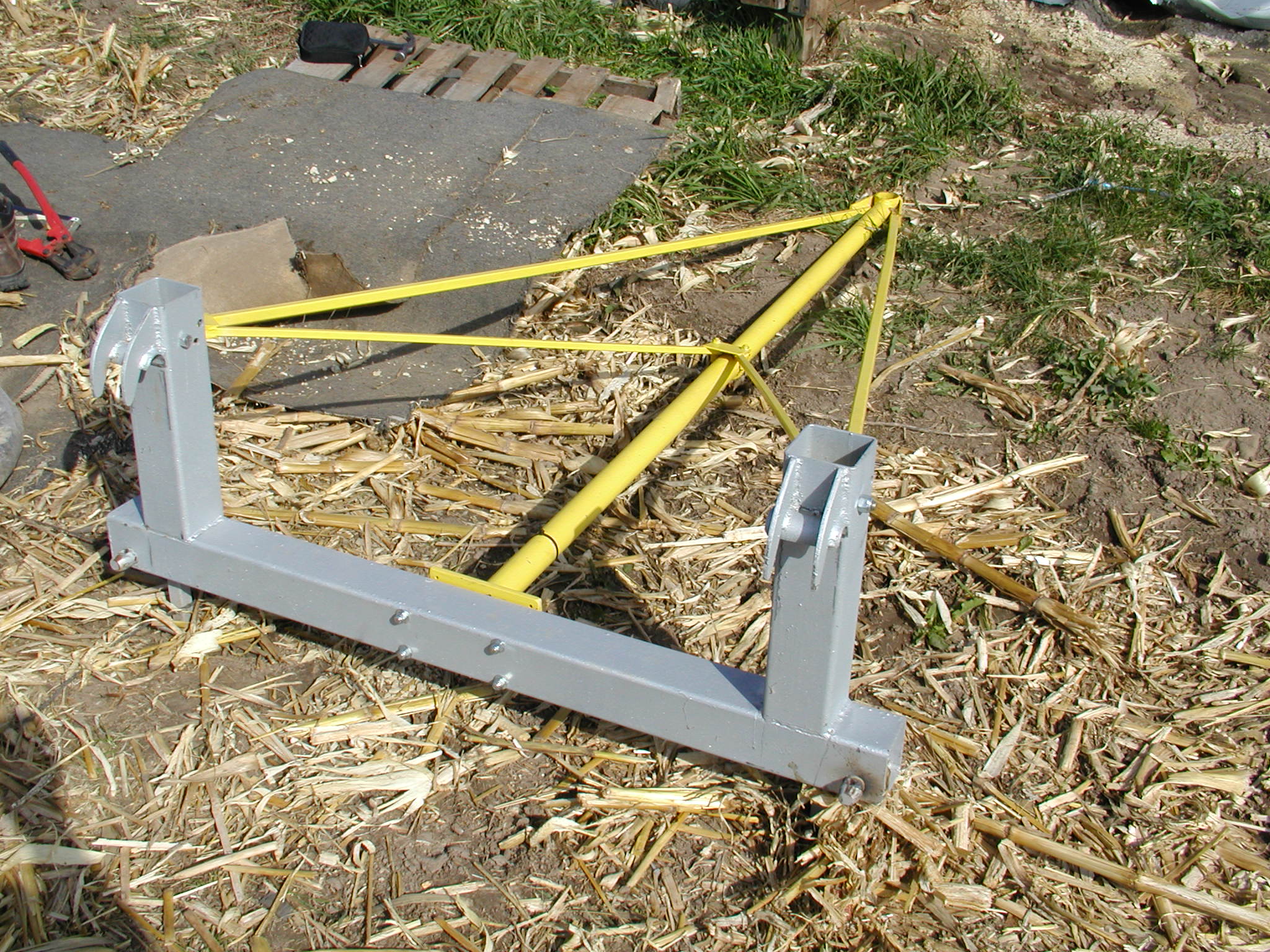

As long as you guys are doing structural analysis on boom poles, you might as well look at mine too. Here's about the only pic I have of it. Compared to others, it may seem upside down (but is setting upright in the pic below). Its all built on a dedicated subframe (no bucket required) which directly quick-hitches to my JD CX300 loader. The main tube is 2.5 inch OD, with about a 3/16" wall. The main struts are 1/8" wall three-quarter inch square tube. The jury struts are 1/2" square tube, welded to the clamp, the clamp is clamped around the main tube (not welded to it) at mid span. OK, I admit it, there is some aircraft building experience blended in here.
Its fully tested. My loader can lift about 2000 lbs. at the pins. Last year I was trying to lift a 36 foot steel k-bar truss (~500 lbs) off the tops of a couple of 6x6 poles set in the ground. Due to a forgotten fastener or two or four, the poles both broke before I lifted the truss off. It was 12 feet to the top of the truss from the ground. I was lifting in the middle, with a chain in a "V", spaced about ten feet apart to two points on the truss.

500 lbs at the end of that pole , looks like 6' or so ,is putting +/-3000lbs pounds of force on your connections and the load would be a load greater than your tractor lifting capacity ?

I like it. Good design, making better use of materials. The only suggestion I would make is to weld the struts to the center of the tube instead of clamp them.
a long structural member has 3 basic modes of stress. Tension(pulling), Compression(pushing) and shear(bending). Tension is the strongest mode, and you will get the most out of the material used. Compression is the next strongest, but considerably weaker than tension. Shear is the weakest mode. A good design always strives to place as much of the design load as possible in tension or compression. The above design illustrates this perfectly. The top angled struts are in tension, therfore are much stronger for their weight. The tensioned top struts place the main boom pole in compression. A column in compression will usually fail or buckle in the middle of it's span(compress a toothpic or matchstick between your fingers). The secondary struts lend support to the column at it's weakest point. Since the struts are offset to the side, this gives side to side support. Triangles are our friends.
You avoided shear alltogether... Well done sir...
