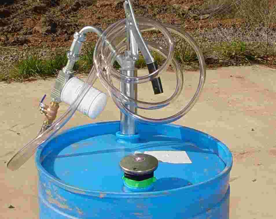

I am a bit late on this discussion but I think we can all agree than the 5 gallon can approach stinks for larger tractors. I need four 5 gallon cans to fill this machine up, not to mention having to lift them up high to pour in the fuel. The fill spout is about sholder high.
So I considered a bulk tank till I saw the price. Then I though about a pickup truck tank, even worse. So being cheap I built my own, see attached.
I debated about gravity feed versus pumping and in the end decided that pumping was better since I get about three fill ups and then its off for more diesel. Thats a lot of up and down for a gravity feed system.
The guts of it is a 55 gallon plastic drum that cost $5.
Pump plus filter and some hardware. Hand pump and hose.
A vented fill cap plus a butress to NPT adapter tops it off. I guess about $50 to $100 in the whole setup. If you loose the filter and fill cap it would be much cheaper.
I buy off road only with this tank
