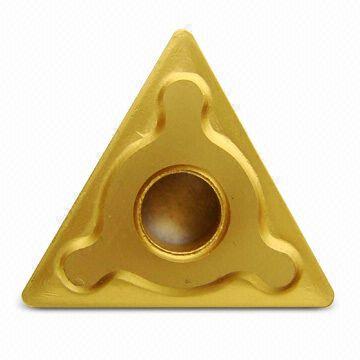

I thought stumpjunkie was implying that Fecon had come out with a new carbide holder that allowed you to simply replace the carbide by unbolting the old and then bolting on a new carbide insert, instead of having to replace the entire hunk of metal that the carbide is brazed to.
Something like this is what I'm talking about:
