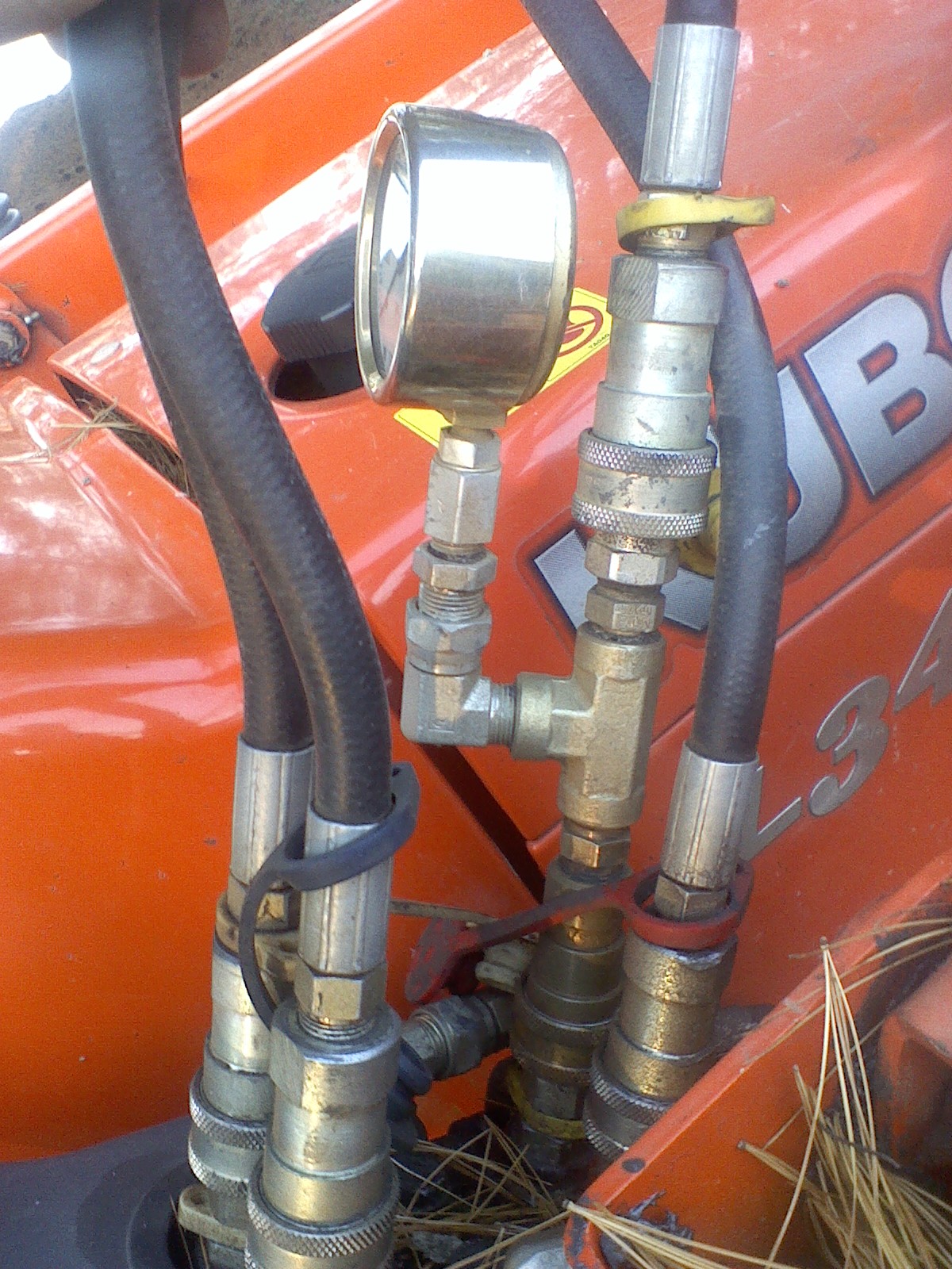

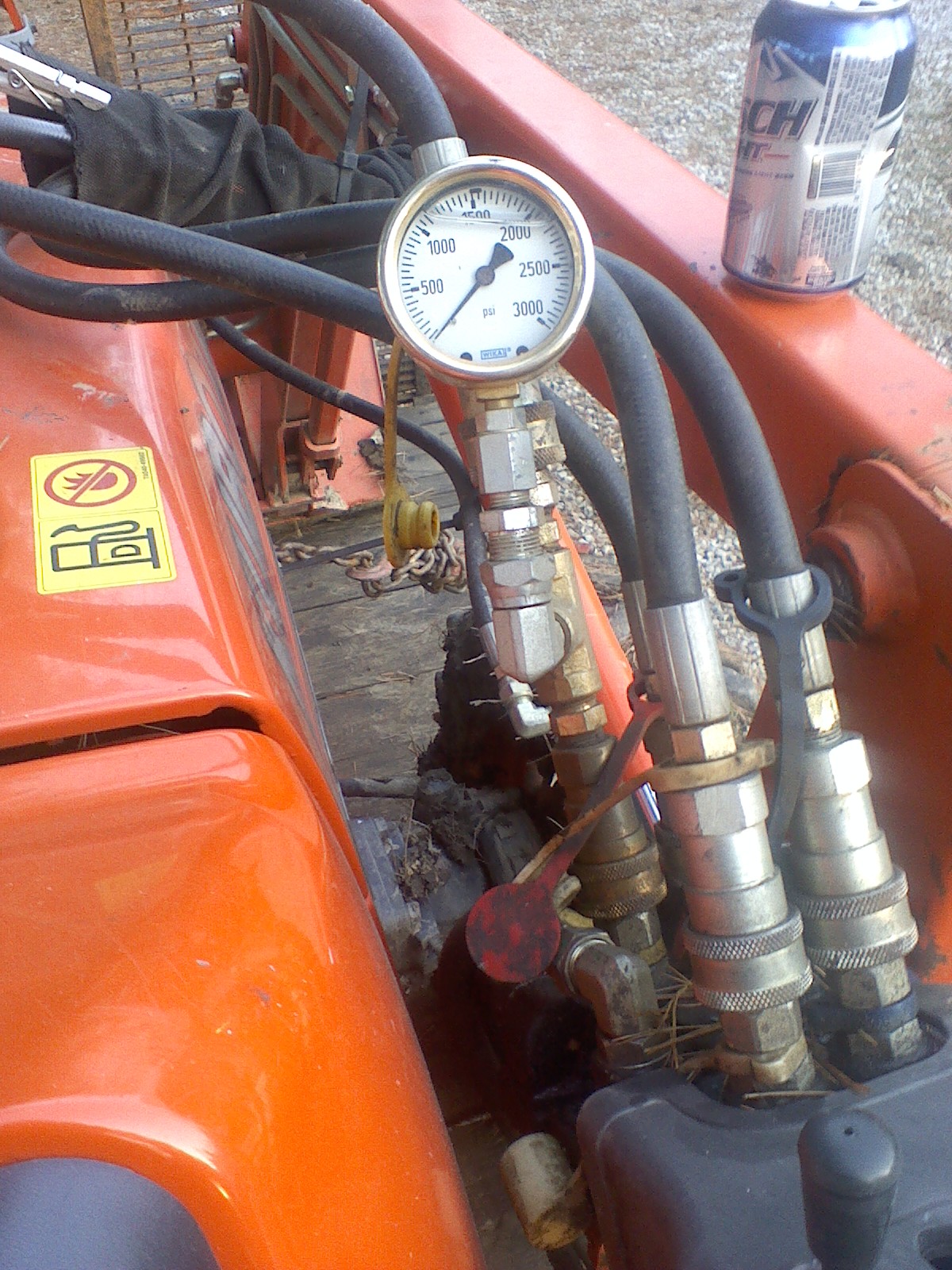

ht1, do you know what RPM you set/read 2500 psi at?
You can set the pressure at any rpm, but only if you are doing work like raising your bucket to the max and hold it there, then the relief will relieve, and read the gage. Even the PTO just sitting there and turning with no load, there will not be a lot of pressure. Pressure is developed when you try and stop or by putting something in the path of the fluid, like a cylinder, a hyd motor, or hydrostatic transmission. Years ago, I thought it was odd that I didn't have 2750 psi on my lift cylinders, and then I realized that some things don't take much pressure to operate. However to get maximum out of the system The design people have determined that a certain cylinder will lift a certain load if the rod end is put at a certain location. Most all the cylinders out there can do a lot more work, if the geometry of the cyl and mounting location is correct.

You may get an extra 100psi at full rpm.larry
Sure, but based on LD1's calculations every psi = about 1 lb and I'm only considering adding 150 psi from full throttle readings. I know that may seem insignificant but if I base my setting on what I run the machine at I could end up with more than 200 lbs. of lift while barely skimming by the factory spec. max.
200 lbs is practically a magic number for me because that's probably what I lost with the addition of my loader quick coupler accounting for it's weight and extension of the bucket. It's also significantly over 10% more lift capacity. Of course, I didn't seem to notice the loss of lift with the addition of the quick coupler, so who knows.

No trouble out of mine yet. I am running around 2700psi and do a lot of hard loader work.
Since you have a 3700 I assume you may still be under warrenty and might not want to mess with it just yet. But you may want to at least put a guage on it and if it below spec, have your dealer bring it up to spec.

I think I would leave the system as is if it is performing OK. If something happened, and you have to take it to a dealer, and he fixes the problem, and sees that you have messed with the pressure, it might void the warranty on the broken part, and to further provide warranty, he will probably adjust it back to the factory settings. A pressure gage installed in the system now, will help you with how the hyd system is performing. Your owners manual should tell yo what the normal pressure should be.
Using a 2 in cyl with a 1 in rod, a 100 psi change, will cause you to gain or lose about 314 lbs of force. Two cyl will double that.
